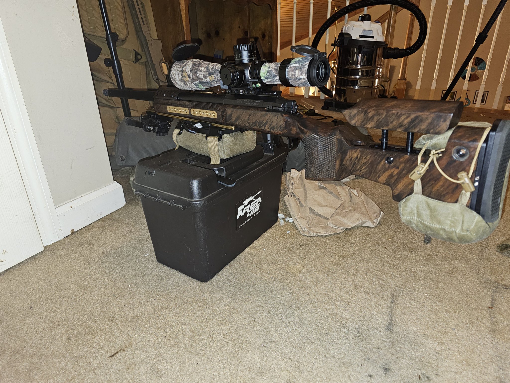

I highly recommend Foundation. the fit is exceptional, no gunsmithing/bedding required.
this one is the Samson in dark distressed
they use micarta so it's like wood but better. great for target stocks, imo. Heavier than carbon fiber, probably a little heavier than fiberglass.
this was like adult Legos, I ordered all this stuff to my door apart from the action, and torqued it together myself. very easy.

it may not fit into your budget idk.
ARC CDG is the most excellently designed action I've used. 1200$ well spent if you go that way. tooless bolt take down and spring replacement is insane. my bolt lift is ungodly light.
