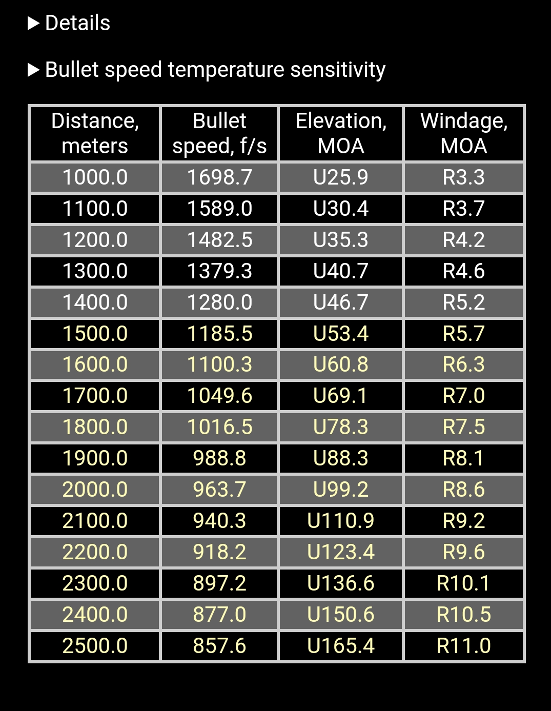

From the the numbers I’ve run I’m figuring to get 3000fps with 153.5 Berger hybrids or 153 A-tips without pushing it too hard.
What kind of distance should that rig be good for assuming I can do my part?
Thanks in advance- Sal

Run the numbers in the ballistic app. But you will be good out to 1 mile plus. Just find a good solid load with low SD and go shoot and find out how it performs and how you do. Them more you shoot at distance the easier it becomes

153gr Berger @3000fps. Do you have a scope which can do 30mil / 100moa dial from zero at 100m ??
Theory is 2000m, or about ,2200y before it starts hurting.

The rail on the action has a 20moa cant built in and the scope is a Leupold MK5 5-25 or 7-35 depending on which one I can find first with the PR2 reticle
A cheats way is to run offset rings with cant in them.
Zero at 100m, do your thing. Then wind the scope turret backwards, find out how much off the bottom of the scope travel you are. You can get custom rings to suit.
However Leupold mk5hd are 35mm rings, which will limit you a bit. I use the 7-35x CCH and love it.
