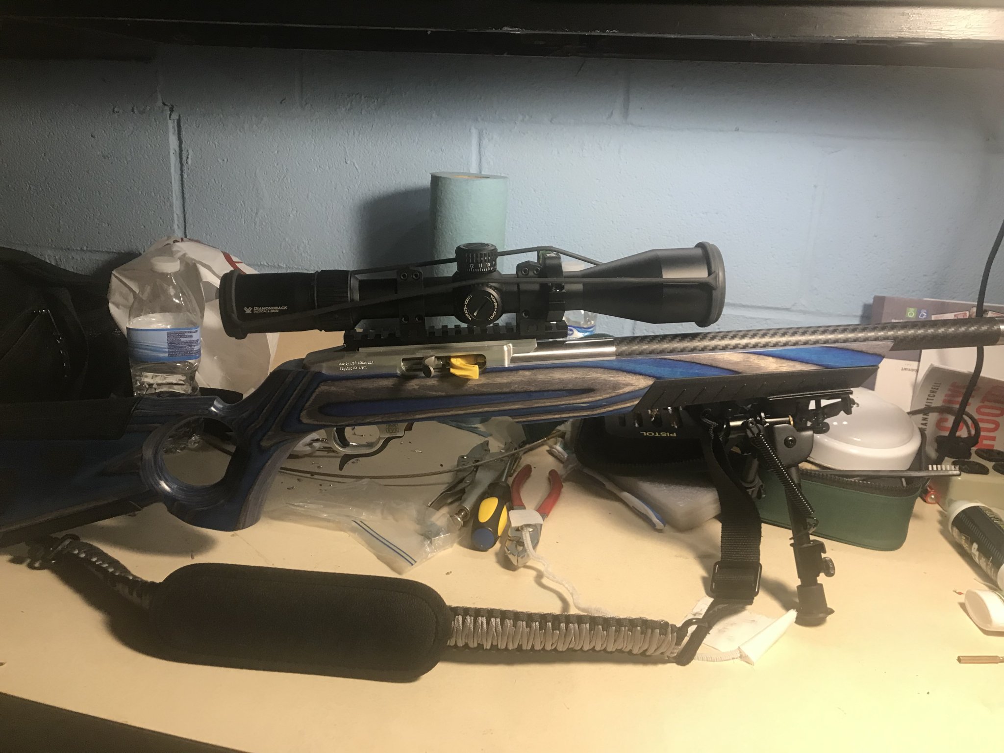

I just put one of the light weight Whistle Pig barrels on my sons 10/22 and I must have hit the barrel lottery with it. It is absolutely amazing with SK Standard Plus. It had a Feddersen on it which shot great bu the WP barrel shoots noticeably better. My son is 9 so that weight savings was a huge deal for him at 22 matches. I’ve been looking at Carbon fiber barrels for my other sons CZ 457. Right now I’m eyeballing the Proof Research. I was just curious how the CF barrels seem to perfom compared to their steel counterparts.

Yeah, with the WP it is kind of a lottery. The factory barrel I have shoots so well it would more than likely be a step backwards for the rifle. With the Proof I know I will be getting a shooter. I can get a pretty good deal on a proof right now and that is what I plan to buy. It always amazes me how some high end barrels don’t seem to preform any better until you start shooting distance. It would seem that a tight group is a tight group but for whatever reason things change past about 150 yards. I have seen it happen myself.

OP - looks good. Please post some groups with it. Always good to see how other barrels shoot.
