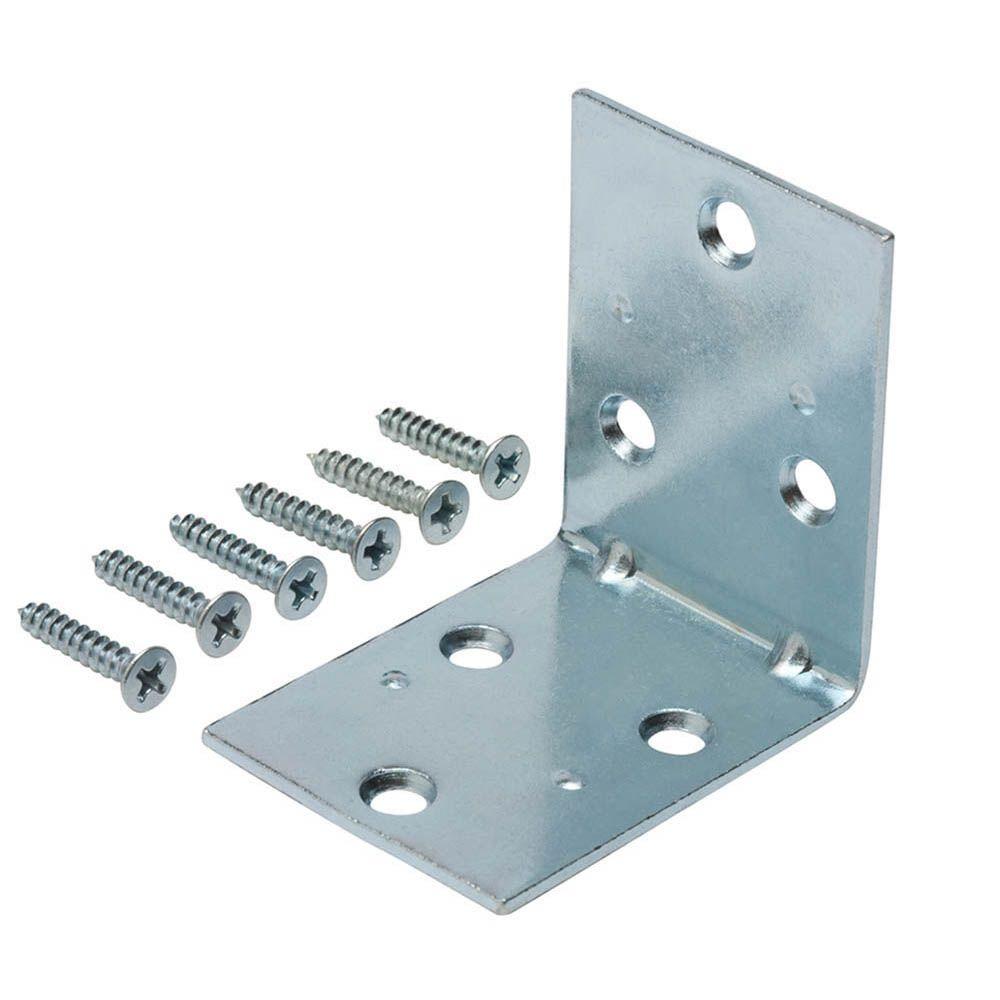

    We are looking at doing the same thing next year. These are the brackets I was looking at using. May be an option. Home Depot has them for a couple bucks.
    I'd go with a combination of glueing a sheet of 3/4" plywood to the underside of the butcher block (recessed to fit inside the top of the cabinet, if possible) and connected to the cabinetry with the type of brackets shown above. The plywood will definitely increase the overall rigidity of the butcher block surface. Assuming this is going to be a work surface, my recommendation is to use a rubbed oil finish, like Watco Danish Oil, instead of polyurethane. When the surface gets scratched and looks a little tired, a quick wipe with more Danish Oil will make it look as good as new. I made my reloading bench top using yellow pine 2x10s and finished it this way and have been very pleased about how it has held up over time.
