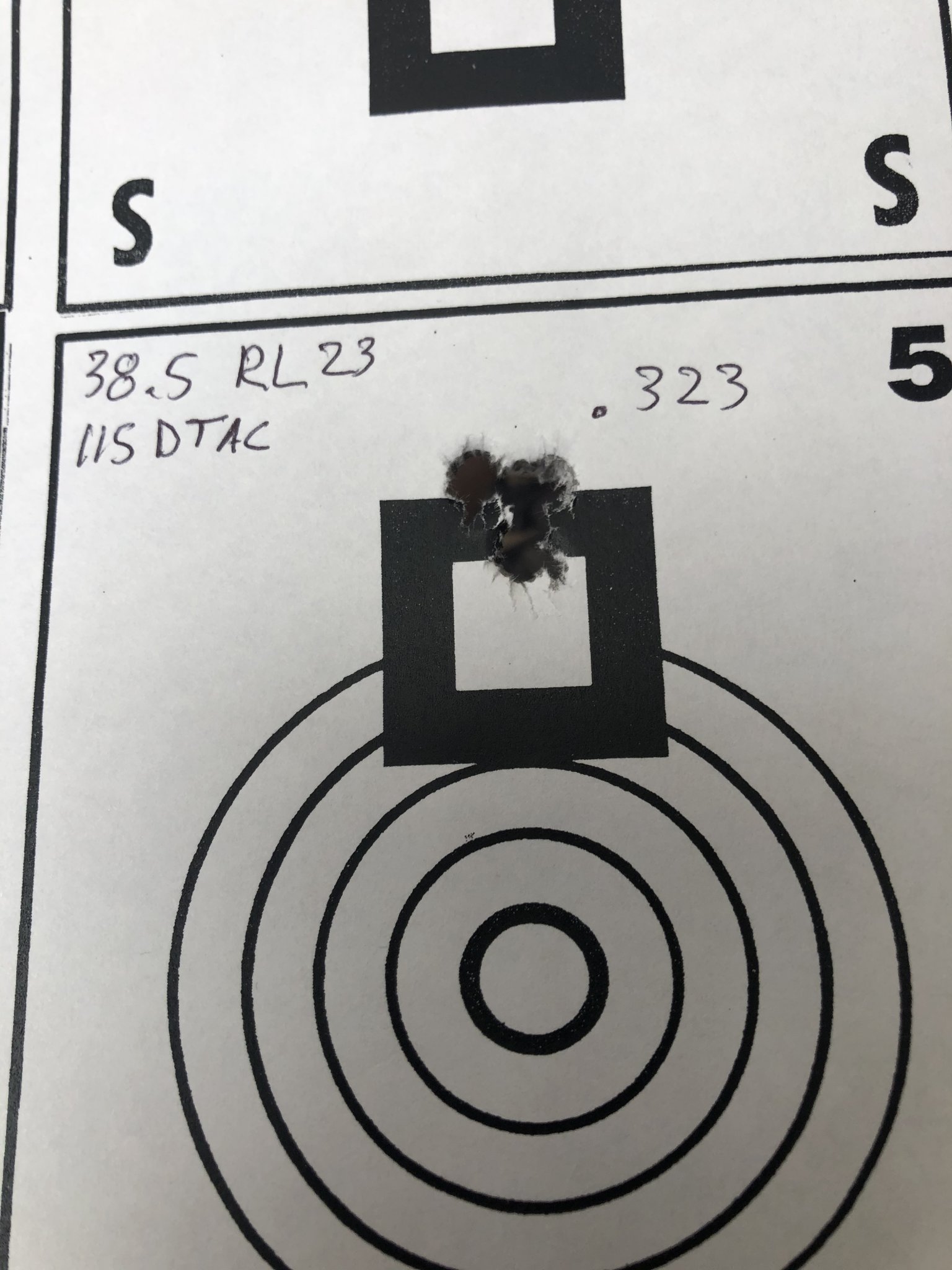

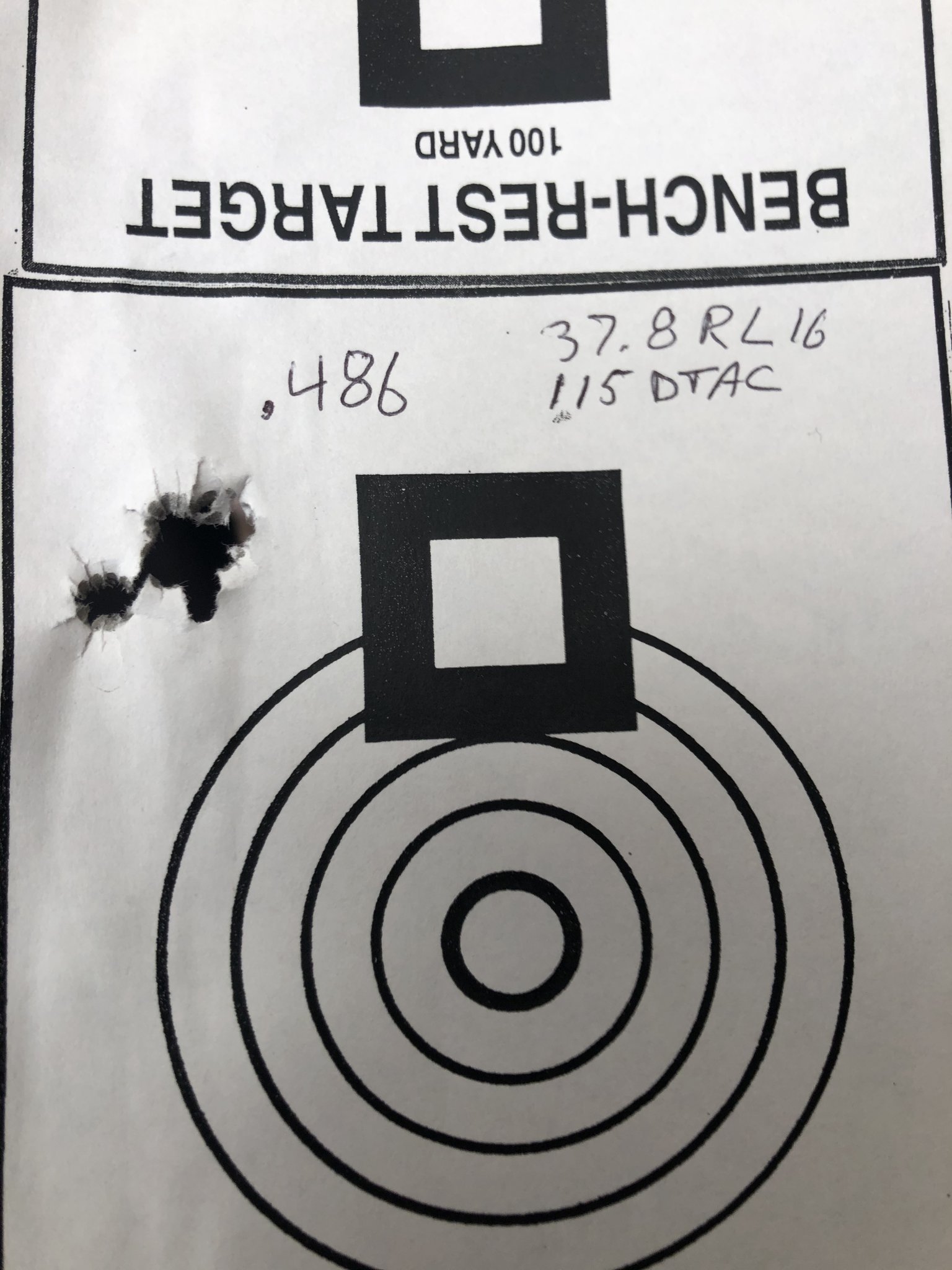

Range Report New caliber and rifle, great first results
Average guy
Low IQ truth teller
  • Dec 25, 2018
    2,390
    4,125
    I just put together a 6xc. It a 700 Remington with a criterion barrel and a Bergara bmp chassis. First trip to the range was good. Tried 115 DTACS with RL16 and RL23. Great results with 38.5 of RL23 and various loads of RL16. Any 6xc advice is welcomed
    I’m going to crono the same loads on Monday. I was shooting at a different range and didn’t get that data. More or less just threw some loads together to see how the barrel was going to shoot. It had 180 rounds down it when I bought it so I figured it was broke in.

    What did you average for muzzle velocity? Nice looking rig btw
    Today I shot for velocity. The 38.5 of RL23 with a 115 dtac was an average velocity of 2830 with an SD of 8.5. 37.8 grains of RL16 yielded 2928 with an SD of 9.2. Interesting enough 38.

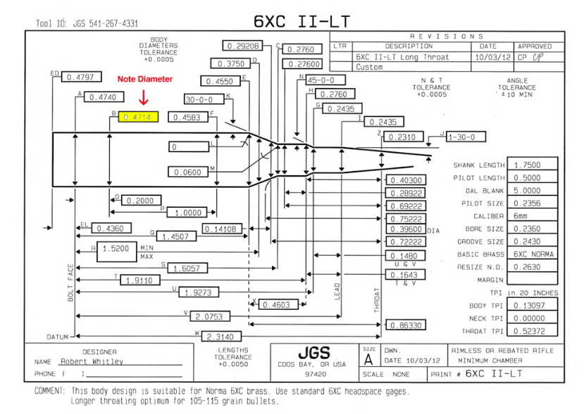

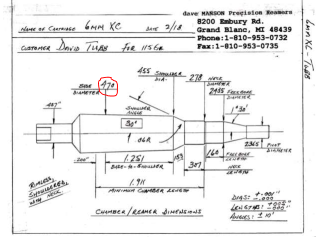

    One thing about my criterion 6xc barrels and my forster reloading dies.
    • First barrel I had lots of norma brass as it was my comp gun so I only ever got up to 7 firings on them all before the barrel was toast.
    • So I put on the second barrel and noticed bolt clickers with that same old norma brass after its next and 8th firing; aka the base of the case was too large. I chalked that up to not following the new barrel-new brass motto. BUT the new batch of 100 peterson cases I bought for it was clicker free, just like the old norma was, right up until its 8th firing as well. I took careful notes on each firing of this brass and noticed that the base wasnt getting sized much if at all, it just took more firings on the brass for it to manifest itself as an actual issue.
    Criterion Chamber, .470 base
    A Tubb 6xc chamber, .470 base
    Proper 6xcII chamber, .4714 base

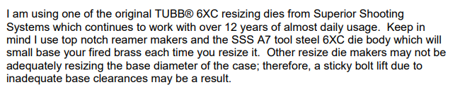

    So I am guessing that the forster die is cut for somehting more like the 6xcII chambering than the original 6xc chambering. Tubb even notes as much on his website
    I was skeptical of it for a couple years because I didnt get enough firings on my old brass and barrel so I never functionally encountered the problem.
    So to summarize, take notes of the case dimensions on each firing and see if you can watch that base growing.
    I have a PVA small base only sizer that should be here soon, Im hoping that it will work like envision and it knocks the base down a thousandth and I can burn this barrel out clicker free. If not and I have to buy a second sizing die in the tubb to make it work Ill probably move on from 6xc after this barrel to something that doesnt have two different chamber generations/parent cases.

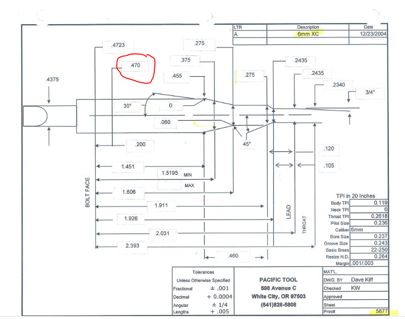

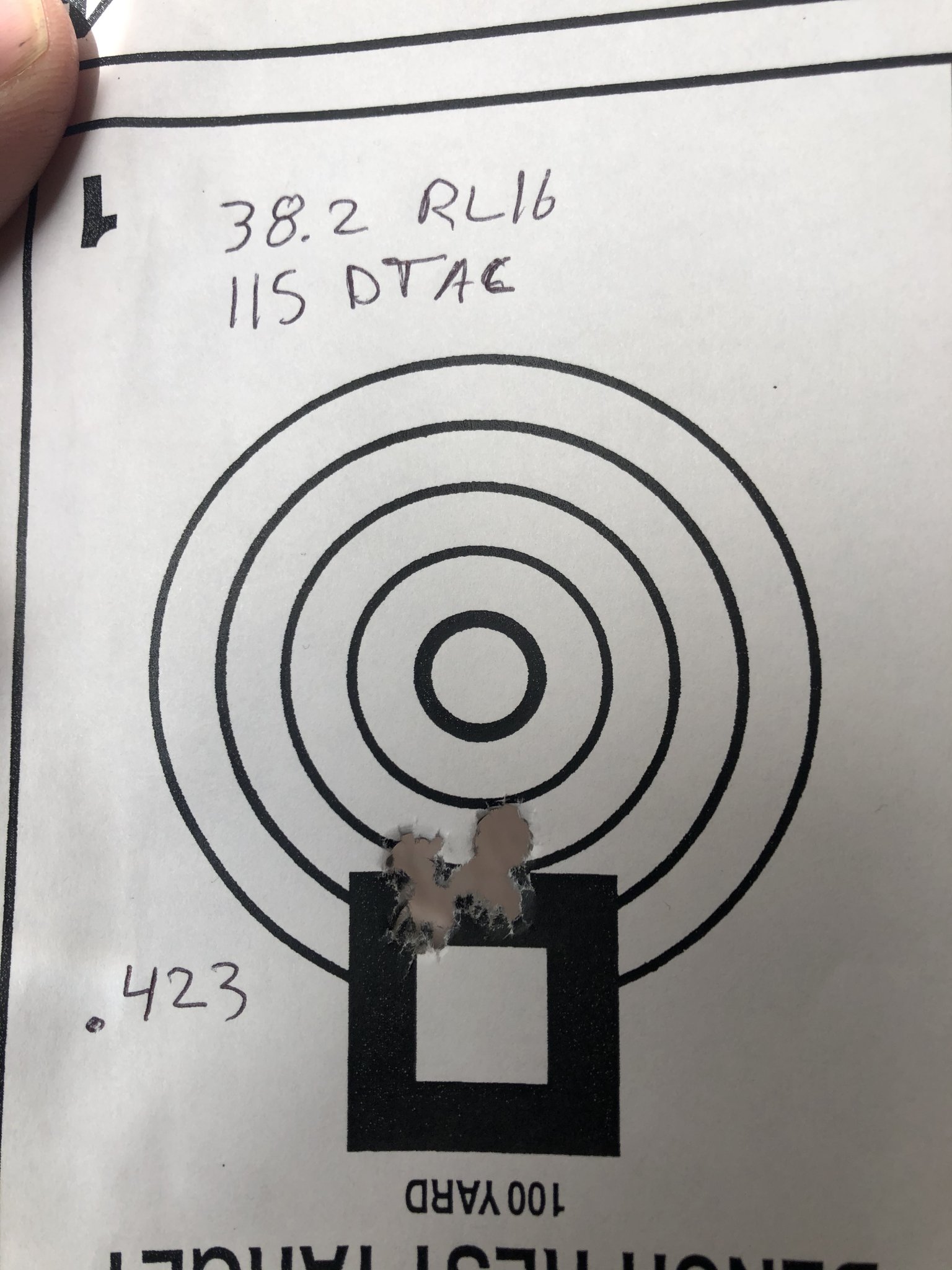

    Went out yesterday and stretched the xc out a little. The 38.2 grains of RL16 load was spot on to my ballistic app. 6.9 mils at 1025 yards. 2 shots to get the wind figured out then it was an absolute laser. My son and I both recorded several 4/5 strings at that distance. Moved to a plate at 635 with a 10-12 mph crosswind. One shot to get windage and all hits from there. I’m really liking the caliber and the DTAC bullet. Been some fast load development.
