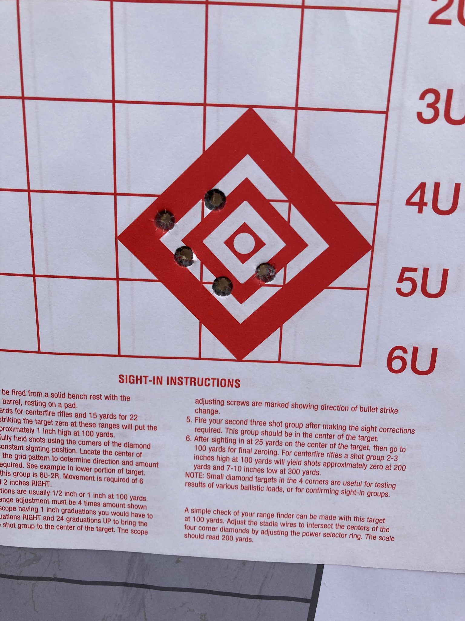

Would appreciate insight.
Bought a Whiskey 3 Chassis, used but in good shape.
Put my Bergara HMR barreled action and i went from a sub moa (.5- .75). to over an MOA in the new chassis. Below is a pic of my best group from 100y.
I think i installed it correctly. Action doesn’t seem to wiggle or move.
Insight?

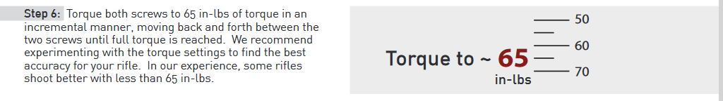

You're probably going to have to play with the torque settings as mentioned above to see what the rifle likes, KRG mentions this in their installation instructions, 65 in/lbs is a recommendation, not a rigid requirement.
Different action and chassis but when I had my Remington AAC-SD in an AICS it liked to be torqued down at 55 in/lbs, 65 in/lbs opened up the groups significantly.

Thank you everyone for you time. so far i have..
Trimmed the front action screw
torqued the action screws from 65 to 55
4 shots, three at .72 with one flyer. Much better. But i am consistently getting one flyer. But that is not odd for my Bergara although it is happening more consistently. Will keep working those toques and seeing what the system likes
I am saving up for a better action and barrel. at this point this barrel and action will have to do.
Again, thank you and any more wisdom is welcome.
