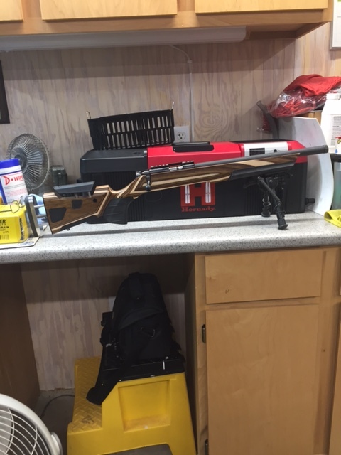

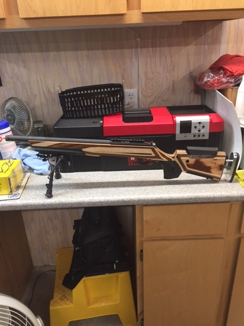

    I have a 455 Tacticool version in Boyd's stock and recently picked up a synthetic American that I've decided to build on. I ordered the DIP scope base right away and, over the last couple of days, have now ordered a Boyd's AT-One stock in Coyote color with target grip and fore end. Got word today that it has shipped. Yesterday, after a long conversation with the nice folks at F.J. Federson in Laudon, TN I ordered one of their Varmint contour threaded barrels. Not sure what Im getting here but, hopefully, it will be a good one. Still working on what trigger to get but narrowed to a Mr. Fly or Timney. As someone who has been thru the "ball-bearing hell" before I don't want to deal with it again. Is the Mr. Fly a drop-in unit or require working with that damn ball-bearing?
    Barrel arrived yesterday. I clamped into the rubber jaws of my vice (not too tightly) and gave it a good cleaning with Hoppe's #9 before a scan with the bore scope. The bore looked good but I always like to hit a new barrel's throat with some J-B Bore Brite to polish it. I find that really keeps the copper and carbon build up and shortens my break-in with centerfire barrels. After a few strokes of Bore Brite another pass with the bore scope showed a very nice looking throat and bore with no tool marks; a nice job for button rifled barrels.
    The Boyd's AT-One just hit the porch so I'm headed down the shop to open that box now. Christmas in July!
    OK, I got a few minutes this morning to take a really good look at the AT-One stock. The nit to pick is with the adjustable LOP and Cheek. They are somewhat difficult to move up/don or forward/rearward. Also, as you may notice, the two sides are not nearly the same pattern. I tried the action in the inlet and, to my surprise, it fit very nicely. It appeared to be snug and flush to the bottom. All the holes lined up in the right places and the floor plate inlet was just as good. Total stock price, delivered, including the target grip and fore end, came to $240.
    Curiosity got the best of me so I decided to just snug it all in and stick the barrel into the action for a couple of pics (did not install the tension screws). I will skim bed the action into the stock but not until I get the trigger, which will likely be a Timney since Mr. Fly went back out of stock before I could get it ordered.
    Where did you get that stock
    The stock is from Boyd's. It is the At-One.
    The stock came fully complete and the 455 dropped right in. It is a new product for Boyd's and comes with fully adjustable LOP and cheek. It also has optional oversized target fore end and pistol grip.
    All that for under $200 delivered.
    I did have to do a slight dremel job to get the Mr Fly trigger to clear but that trigger requires it on any stock.
    I did decide to do pillar bedding and Danley Precision did a great job with that.
