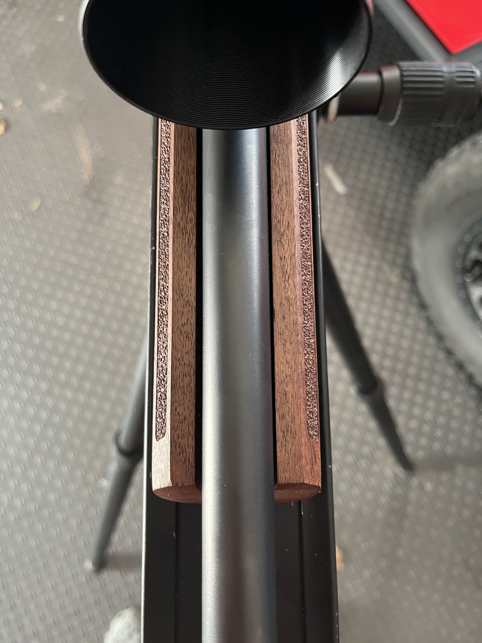

For anyone wondering what this looks like, here is a picture of my rifle. It was confirmed unloaded and bolt out before I took this pic.
OP - my advice for this rifle - test action screw torque to see if you have a sweet spot. I had my pillars replaced with aluminum ones, and I torque to 25in-lbs. the factory should be that value or lower, I would guess. I would avoid anything that is not repeatable as a bedding material (foil tape may work if it is sturdy, duct tape would compress). And I have a very pronounced cold bore shift on my rifle. I can eliminate it by using a bore cap or finger cot between stages. The rifle is exceptionally accurate and a great value, in my opinion.
