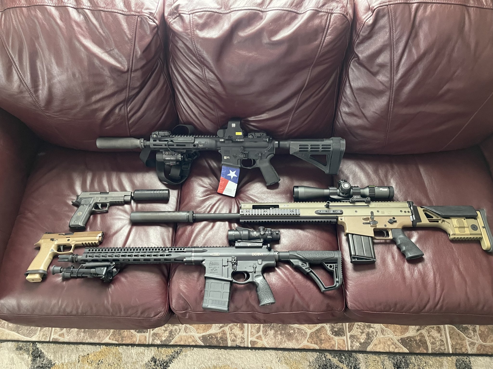

I appreciate that info, what scope are you running ? Those are some awesome pictures by the way
