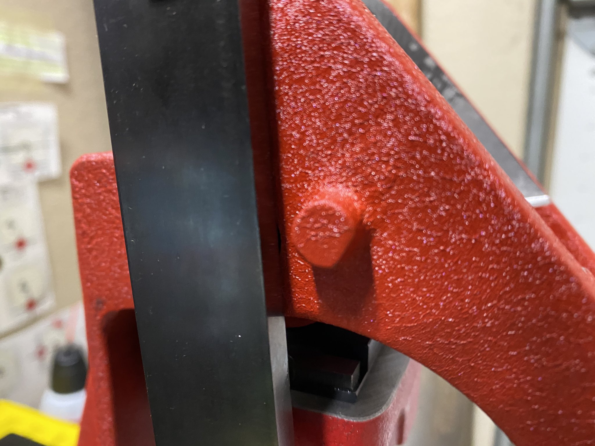

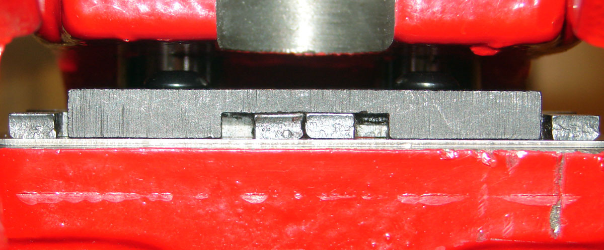

Sure.

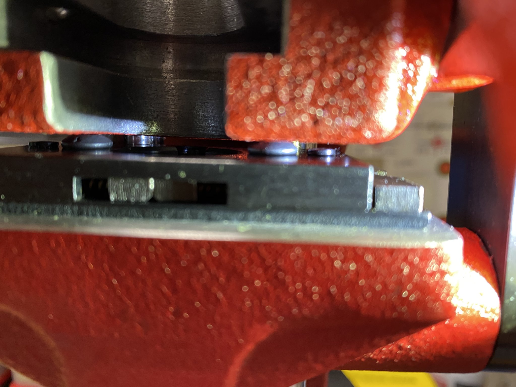

Here’s the handle down and you see the press contact the two button head screws.
Here’s where the full stop tab is when the press contacts the screws. 1/4” short of the stop.
Now “cam over” the press (because its contacting the button head screws) and you reach the full stop limit.

The plate that is under your shell head holder is much too thick. The one that came with my press is about 0.035" thick. Its main purpose is to be able to flip over the shell holder to install it without it falling apart. I don't see where including it is necessary but I leave mine installed all the time because it does not cause any problems. Your photo is blurry but there appears to be posts or retainers on the far side of the shell holder. Was this piece just packing?
I encountered the same problem when I bought their quick detached shell plate holder because it is a lot thicker than the stock. I counter sink a screw I bought at Home Depot, filed the counter sink head. Rough on the counter sink drilling but it works. Problem solved!

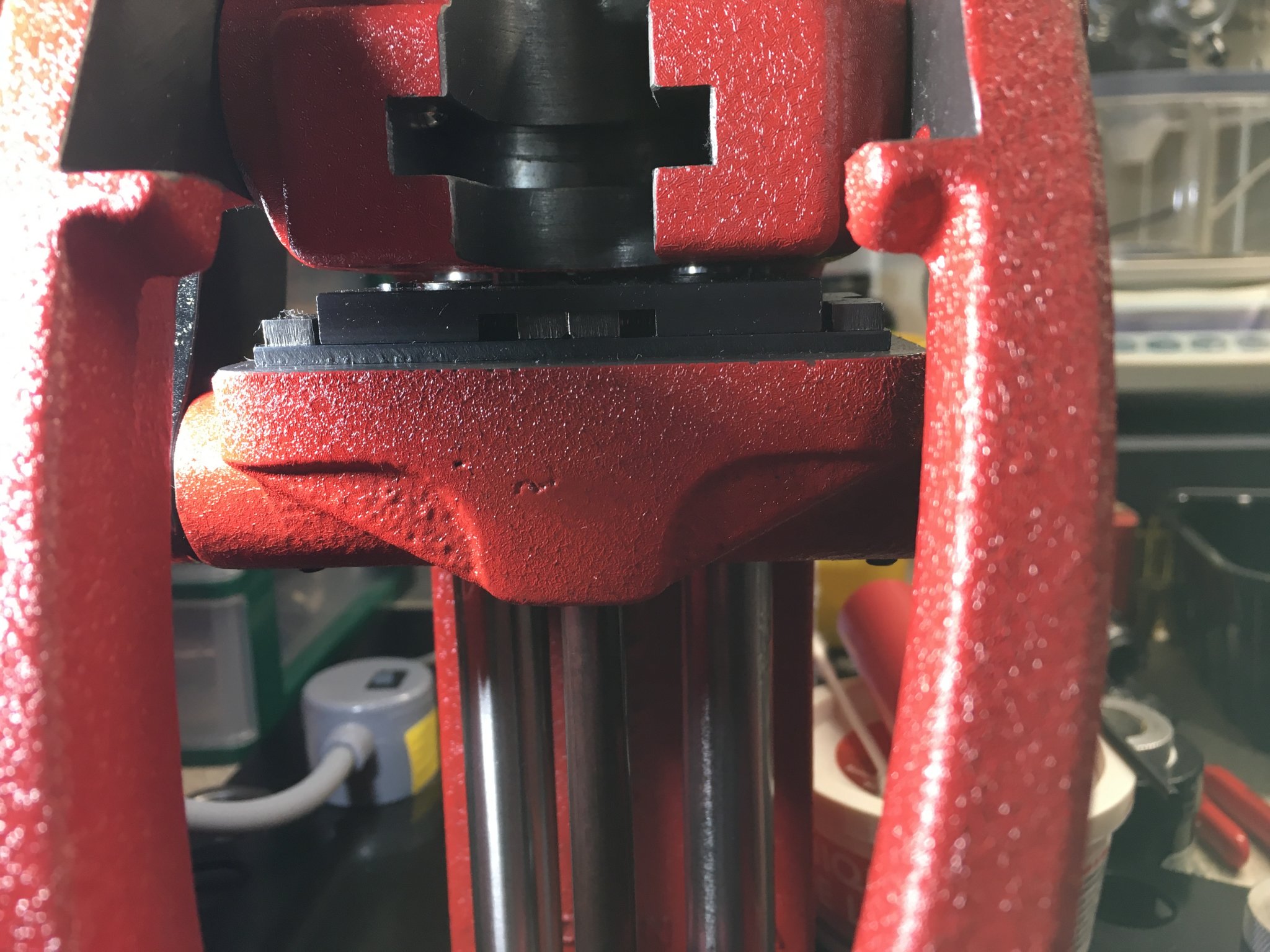

Could someone please measure/provide the gap/distance between the guide block and press. The shaved screws provide paper thin clearance, but not enough clearance for the KMS light kit.

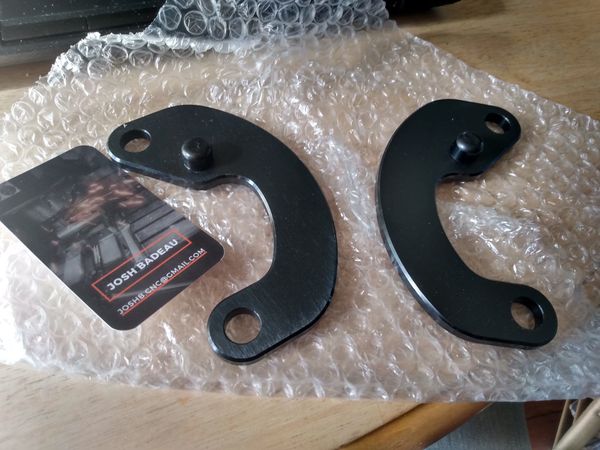

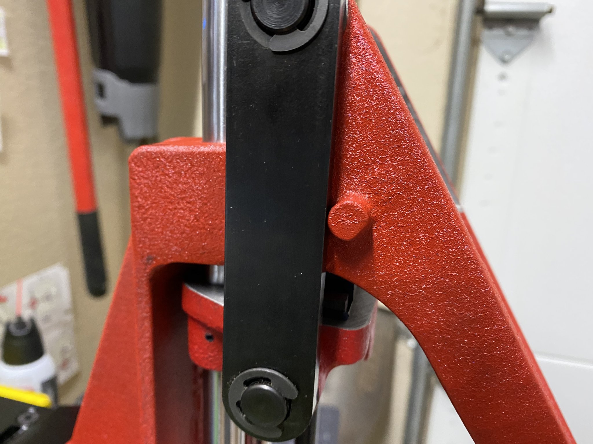

Also finding the Josh Badeau modified linkage works great with the original plate, but unfortunately not with the quick change jaws.

You should have plenty of room with KMS light kit. I don't have the press in front of me but I could probably put 2 or 3 quarters on the shell plate and still not hit the light.
As stated before, it appears your press is out of spec - I would not continue to run it in that condition.

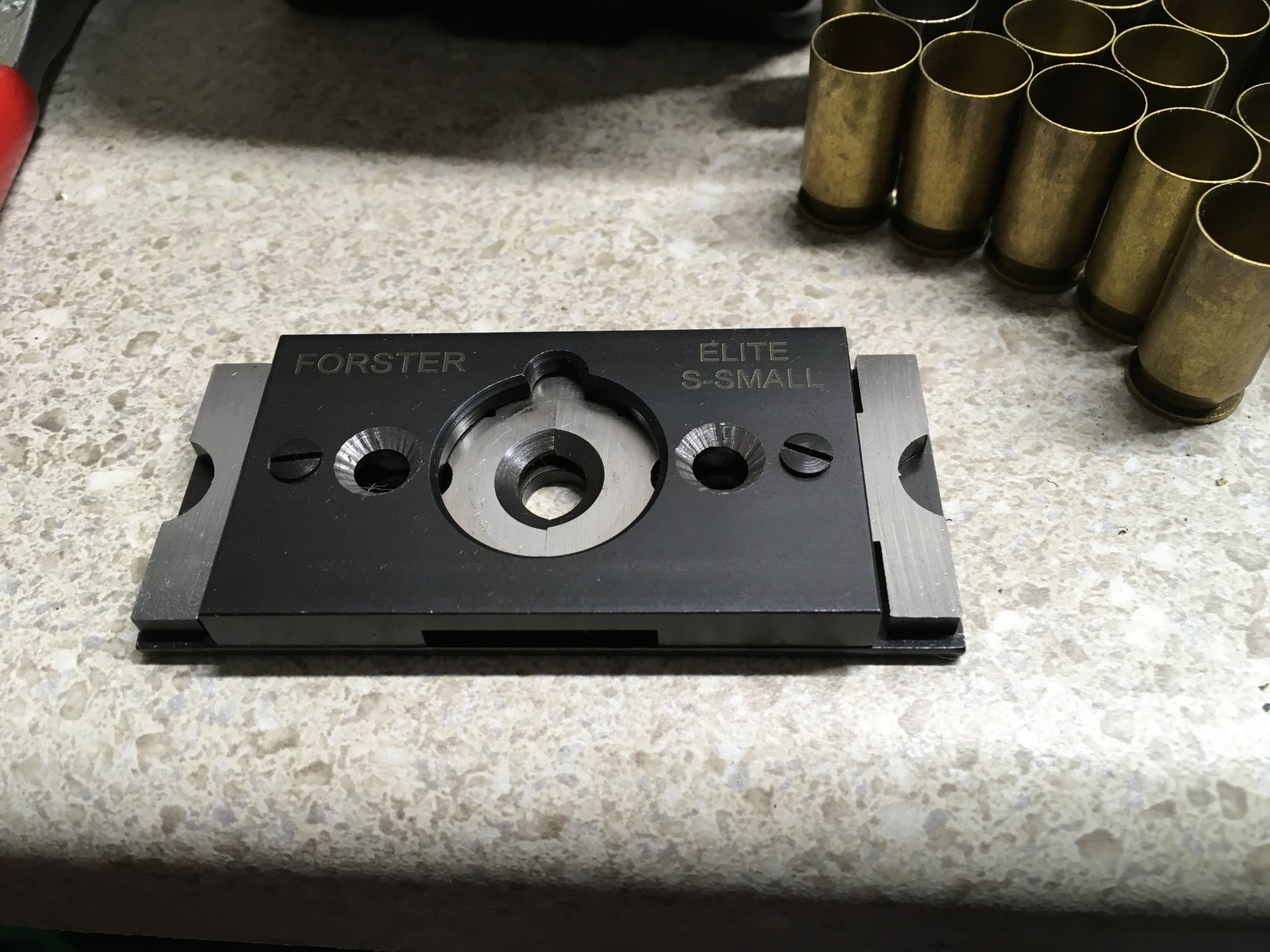

DellaDog, the shim plate is typically not used with the quick change jaws. They are thicker. The shim is just to help you hold the jaws and springs in place if you use the jaws/plate that came with the kit. If I use the plate and jaws I have the same issue with my inline fab linkages and the factory linkages. I use the quick change jaws as well as some jaws someone machines off of one of these forums. I can look up his name if you are interested.

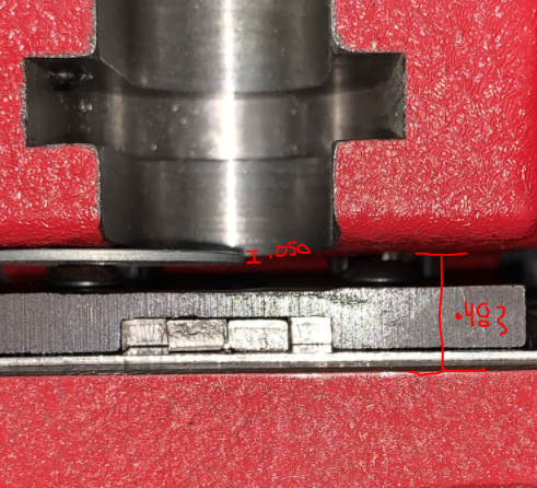

IN my unadulterated version I have ~.050 of space between the screw and the top. When all the way up that washer I stuck in there can barely squeeze in so maybe a thou or two more but not much, it was a pretty perfect fit.
And without the plates Im getting .483

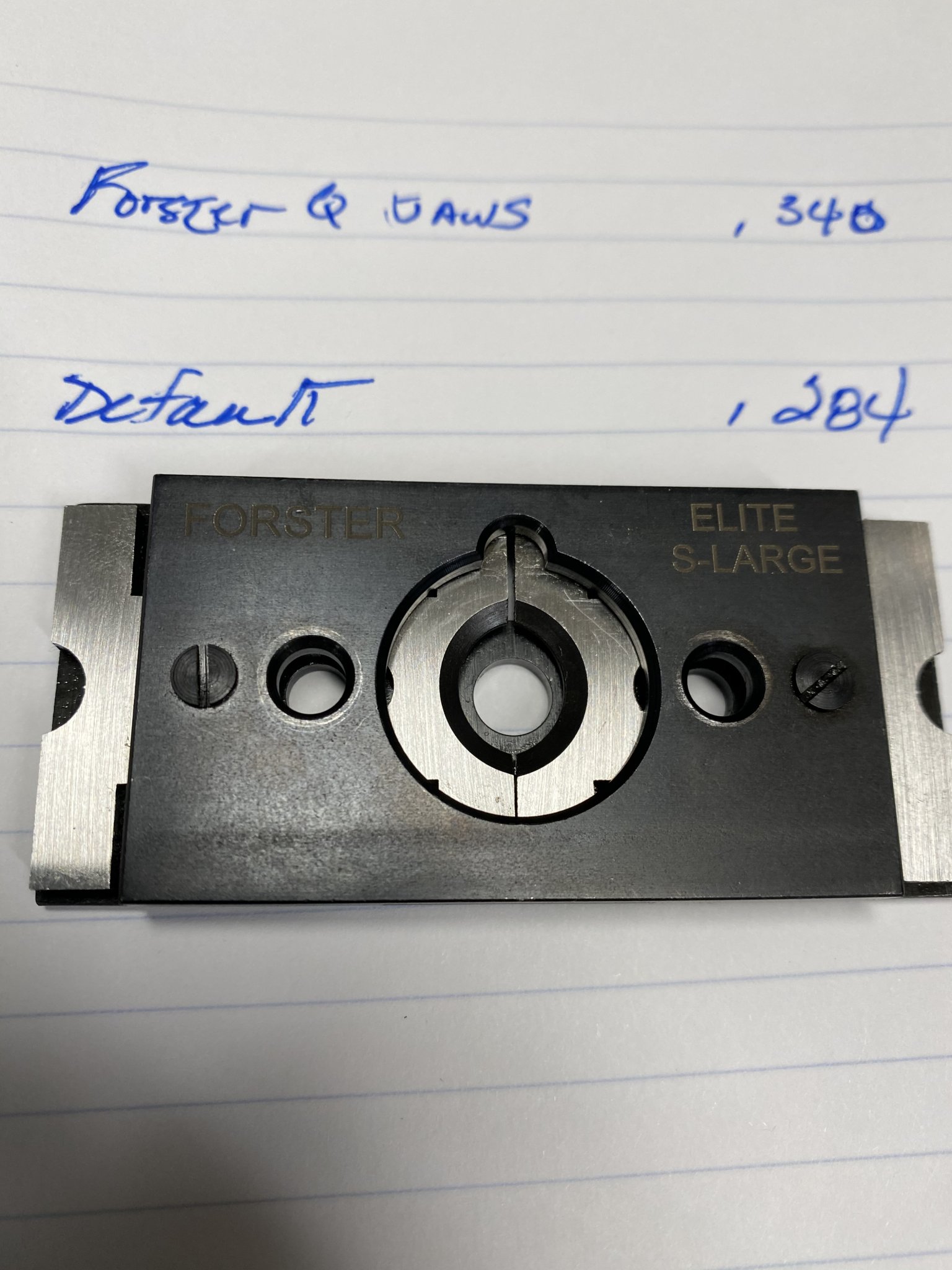

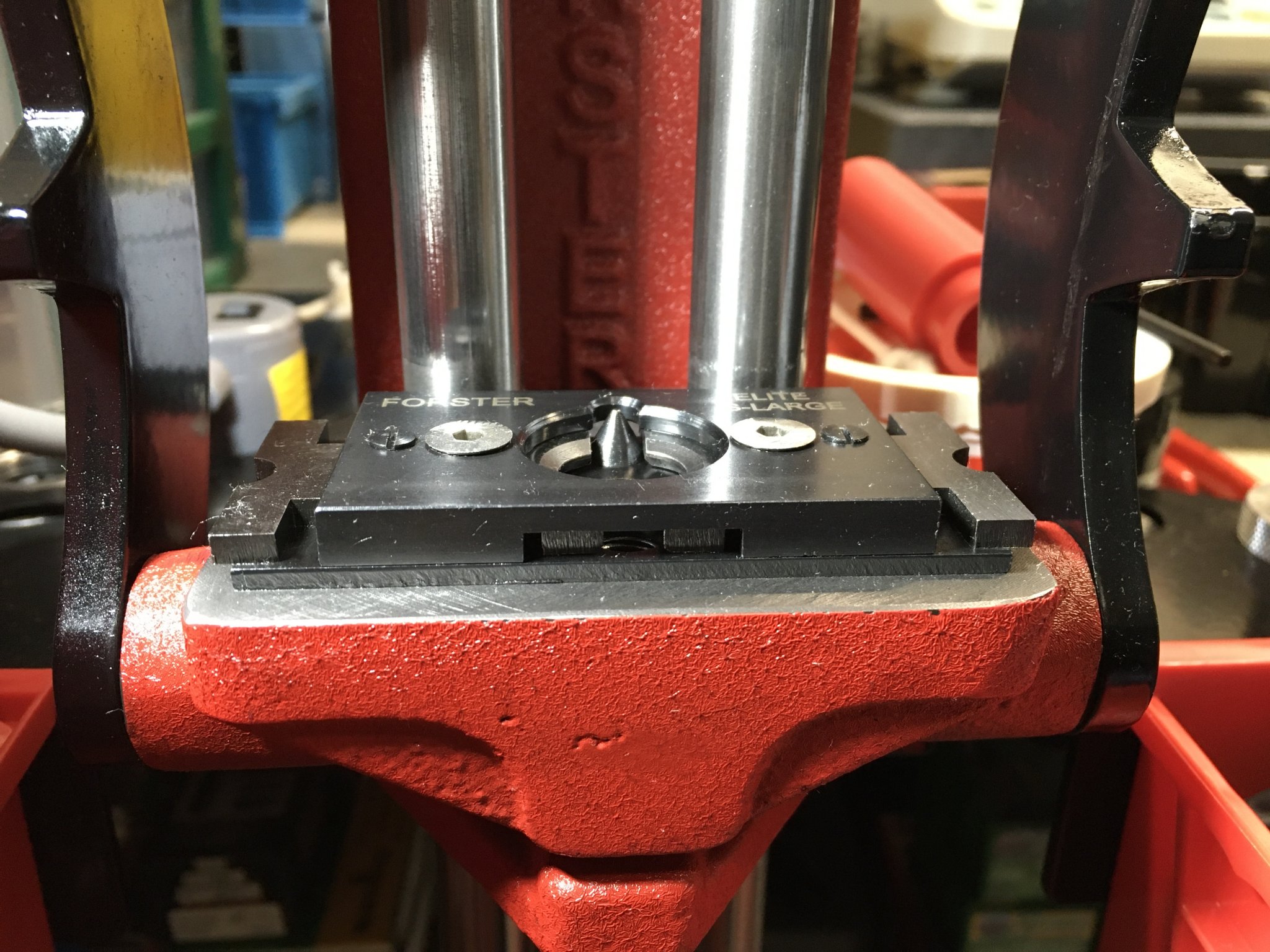

Here’s my measurements as best I can take them -
Clearance from top plate to lower plate measured closet facing you:
(The top plate is actually lower in the rear)
OEM linkage = .460
Joshua Badeau Improved C linkage = .440
OEM jaws, no screw = .285
Buttonhead screw = .100
Total = .385
Clears both linkage sets even with light kit. Light kit is closest in the rear because the top plate is closer in the back of the press.
Quick change jaws, no screw = .340
Shaved screw = .075 ish
Clears light kit using OEM linkage, but not improved linkage.

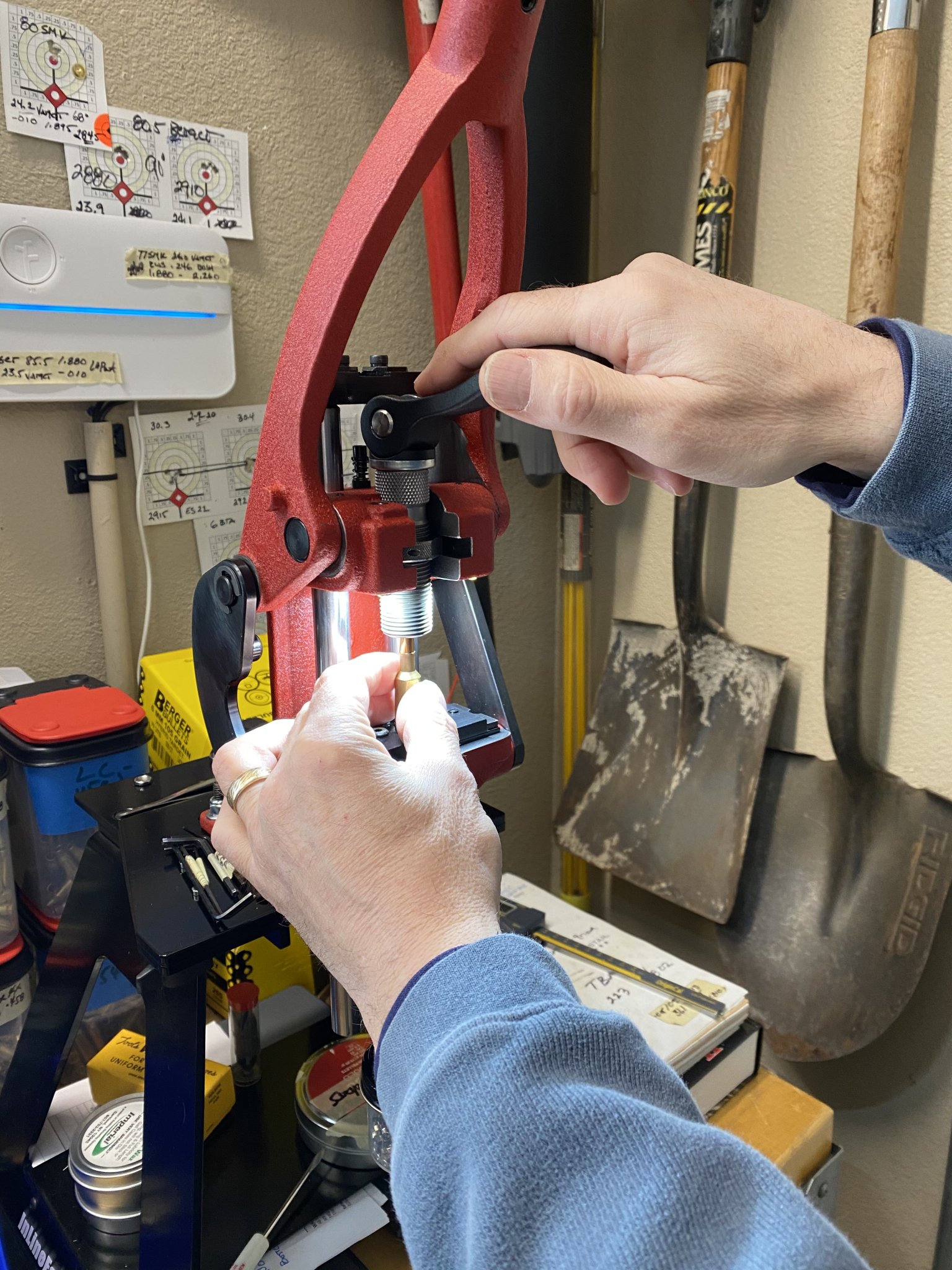

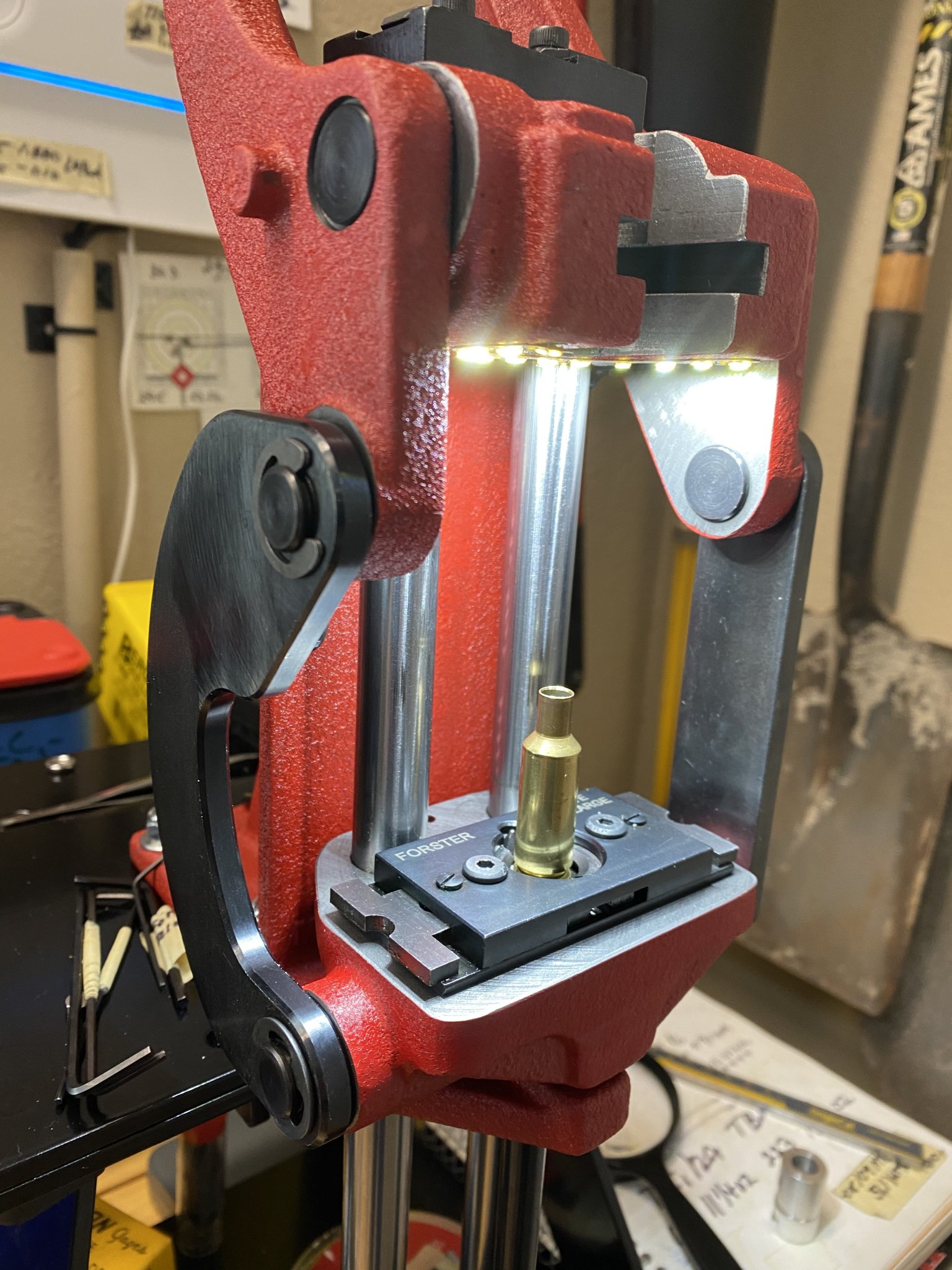

I’ve now found a workable solution that allows left hand insertion and right hand press pulling - with additional lighting and sufficient clearance. The press stops on the right side OEM linkage.
(Were I to have @spife7980’s additional .020 clearance, none of this would matter.)
Additionally, the Forster designed quick change jaws should fit *all* Co-Ax presses without the need to shave the screws.

I may have screwed up in my measurement... or at least not done it thoroughly enough. I just did it again much more thoroughly and it seems that the underneath surface of the top piece is actually slanted up towards the front on mine. If I go in around the back of the linkage I get a much shorter measurement and I get somewhere .454, and if I get it sort of midline its .469ish and if I measure up at the front real easy like I get my prior .483.
But from the top of the base up to the top of the die slot where the lock ring would interface with the press is 1.190 pretty consistently from what I can get to with my calipers.
My jaw stack with all pieces is is .287 thick with a .1 screw for .387 total.
