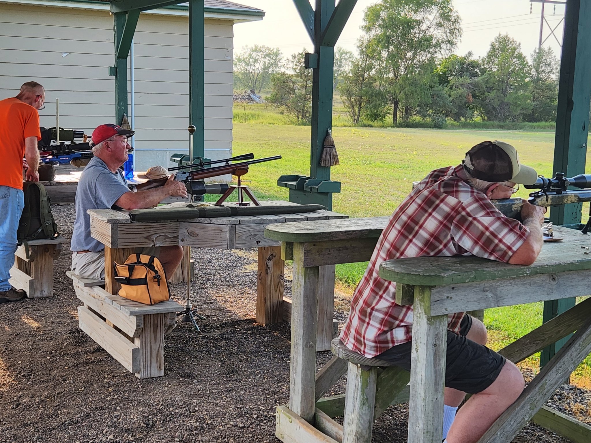

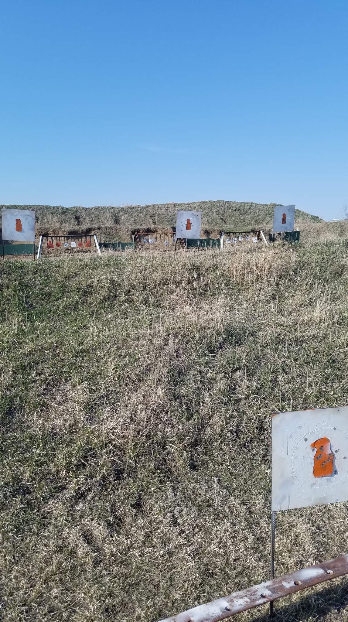

    Last year I found a small match held in a nearby town. They shot a game they called Long Range .22 Varmint if I recall.
    Was fairly simple. They shoot 10rnds per relay in 5min relays.
    Each shooter gets one steel target per relay at a single distance. The distances are 140yds, 160yds, 185yds and 205yds.
    The target is approximately 12" square with an engraved 8" circle and a flapper plate in the shape of a gopher.
    The target(s) is scored and painted in between relays.
    Gophers - 5pts
    8" Circle - 3pts
    12" Plate - 1pt
    8 of the 10 shots are scored. So your best 8 for score. Reason being the novice level shooters get basically two chances to shoot sighters for wind and boy do we have wind here typically.
    So 8 hits all on gopher means a perfect score is 160 points (40pts x 4 relays).
    Obviously, you can always ramp up the difficulty. Either giving no points outside of the 8" ring or all shots are scored or reducing the time to shoot the relay.
    They shot from benches but it could be done prone. Was pretty laid back. And the scoring was very easy looking at impacts on fresh paint. Line breakers were scored best line scoring and nobody scored their own plates.
    They charged a very nominal fee to come play. And it was for bragging rights. I was happily surprised with how well it ran. The whole event took 1hr 45min.

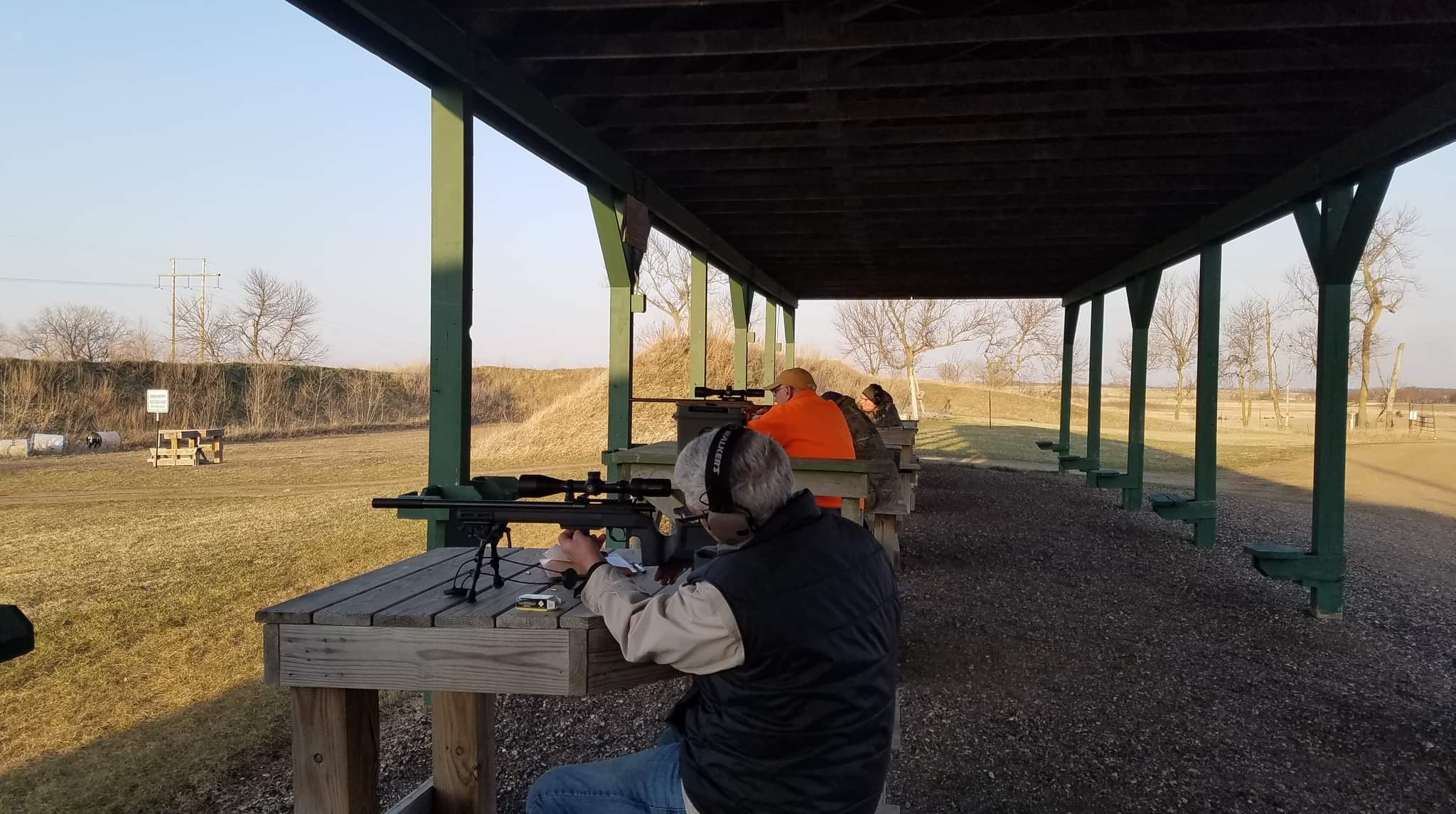

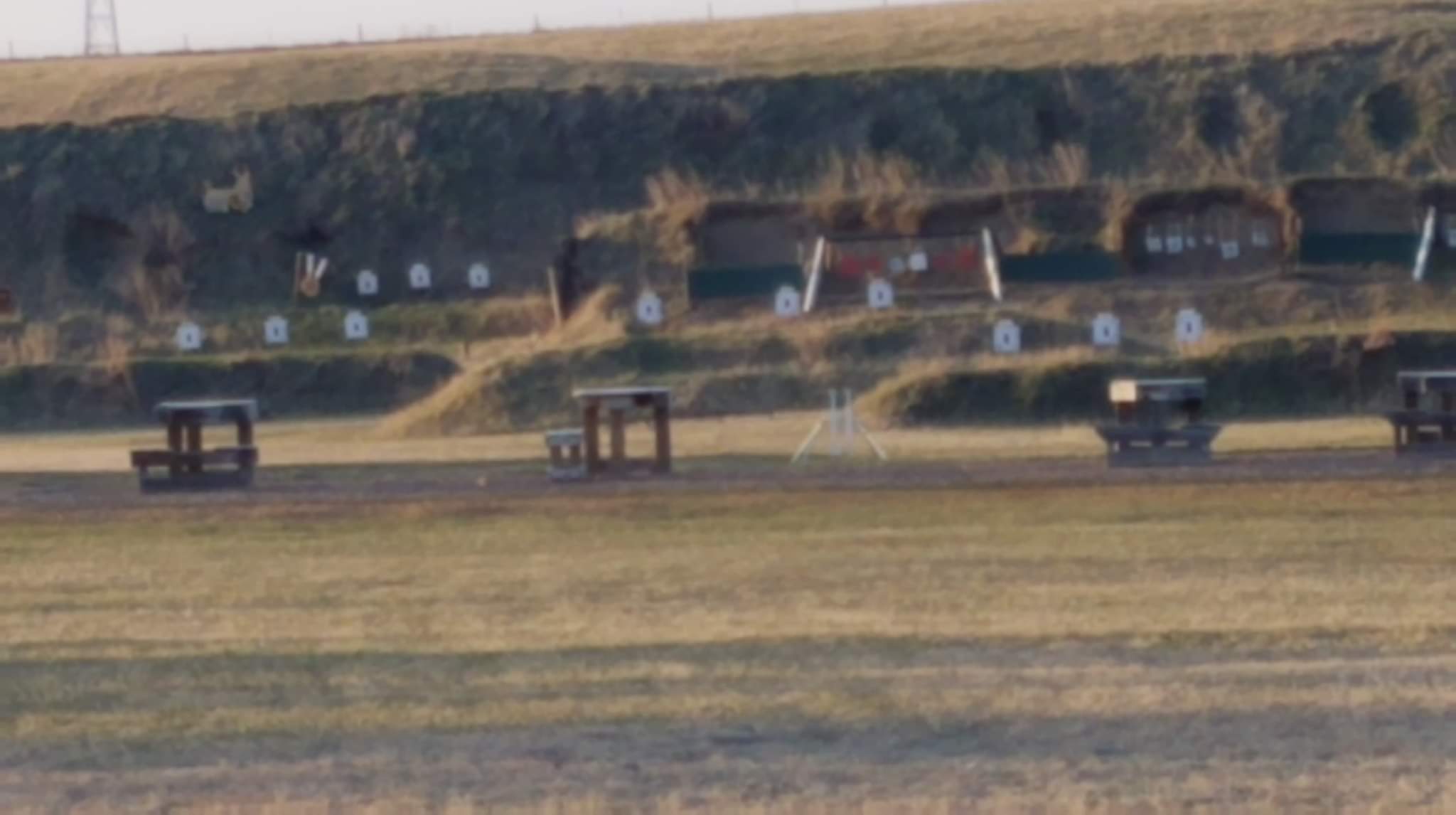

    No classes or divisions that I recall. Just come and shoot. These pics were taken last year in April. I had a job that made it impossible to make the late afternoon weekday matches so I don't have anymore pics sadly.
    Thought maybe you guys would like to try the format out yourselves with your own steel.

    Those are 12" plates? Look larger than that, but should be doable to make some. Do you know where they got the targets?

    They said they had them made a local area machine shop. They are quite well made. The gopher flaps inward on a hinge and the gopher plate itself is perfectly flush with the outer plate. And there is hardly any gap whatsoever. The maker has my respect.

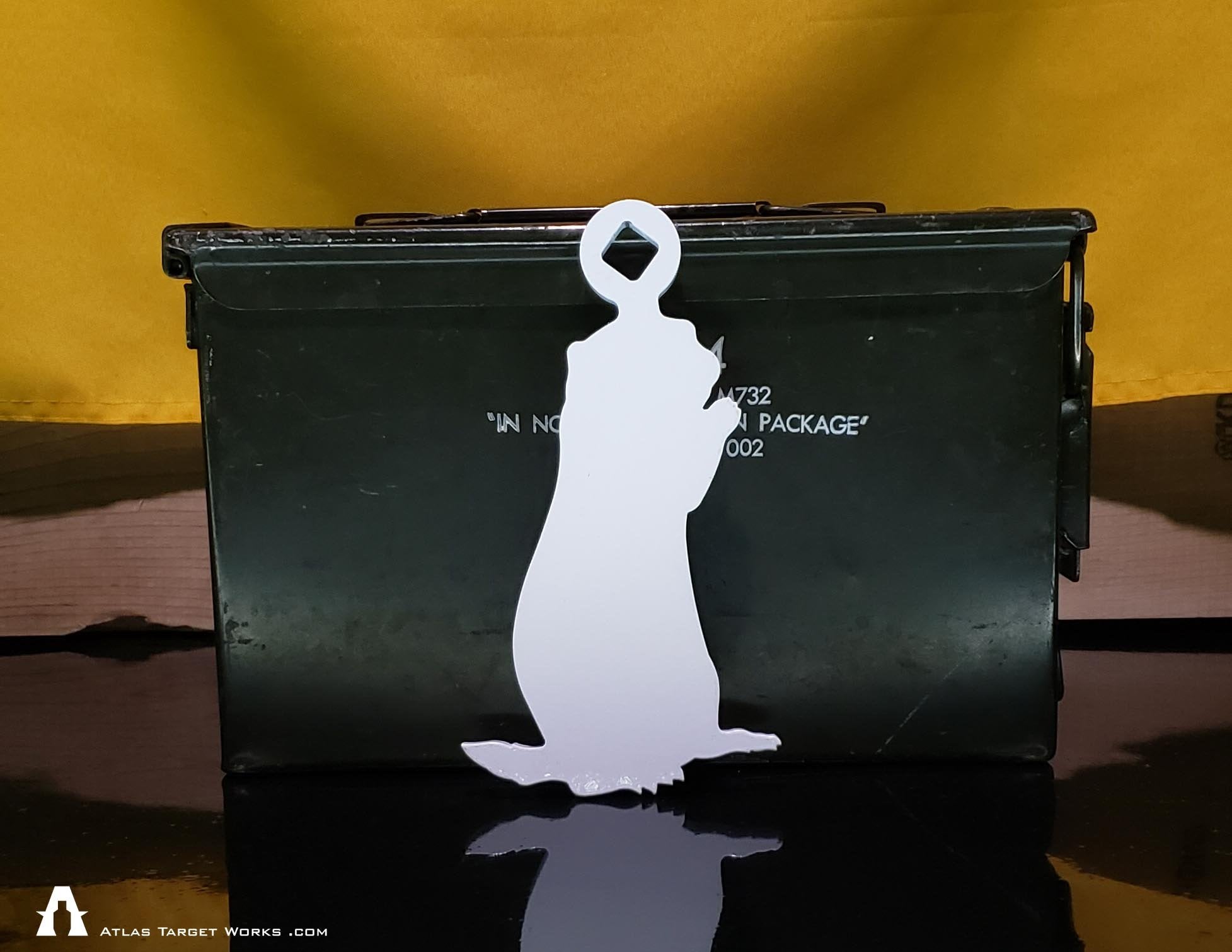

    We have like two very predominant steel target makers in our area....Target Hanging Solutions and Atlas Target Works. And I can say for a fact they didn't use them.
    You may be right. The target plate might be bigger like 14" maybe. Definitely was not wider than my shoulders.

    Thanks doof!! Just ordered a few targets from Atlas. Looks like a quick drive straight up 29 to get to me. Will have to practice and get a few guys to start practicing for some comps.

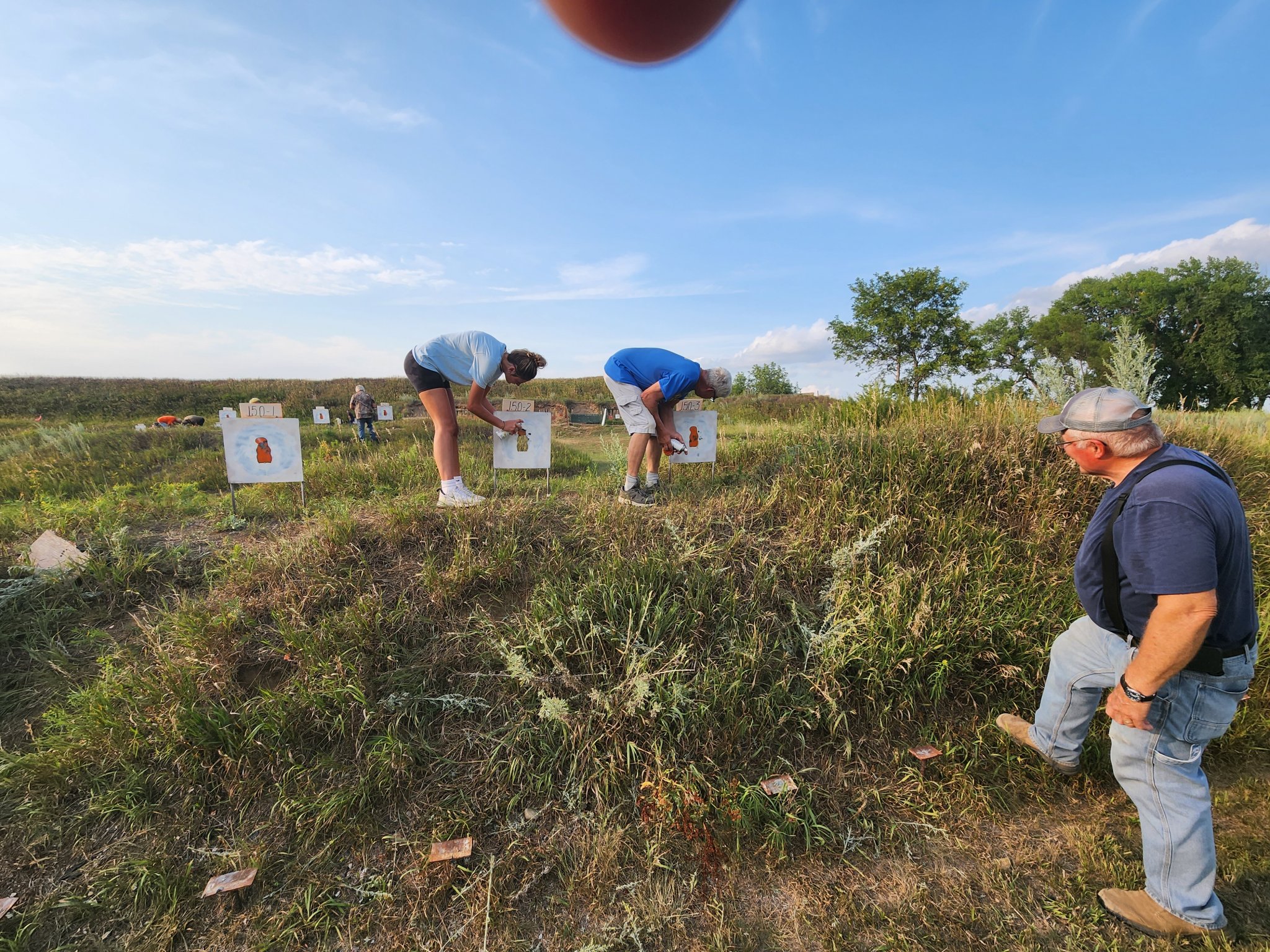

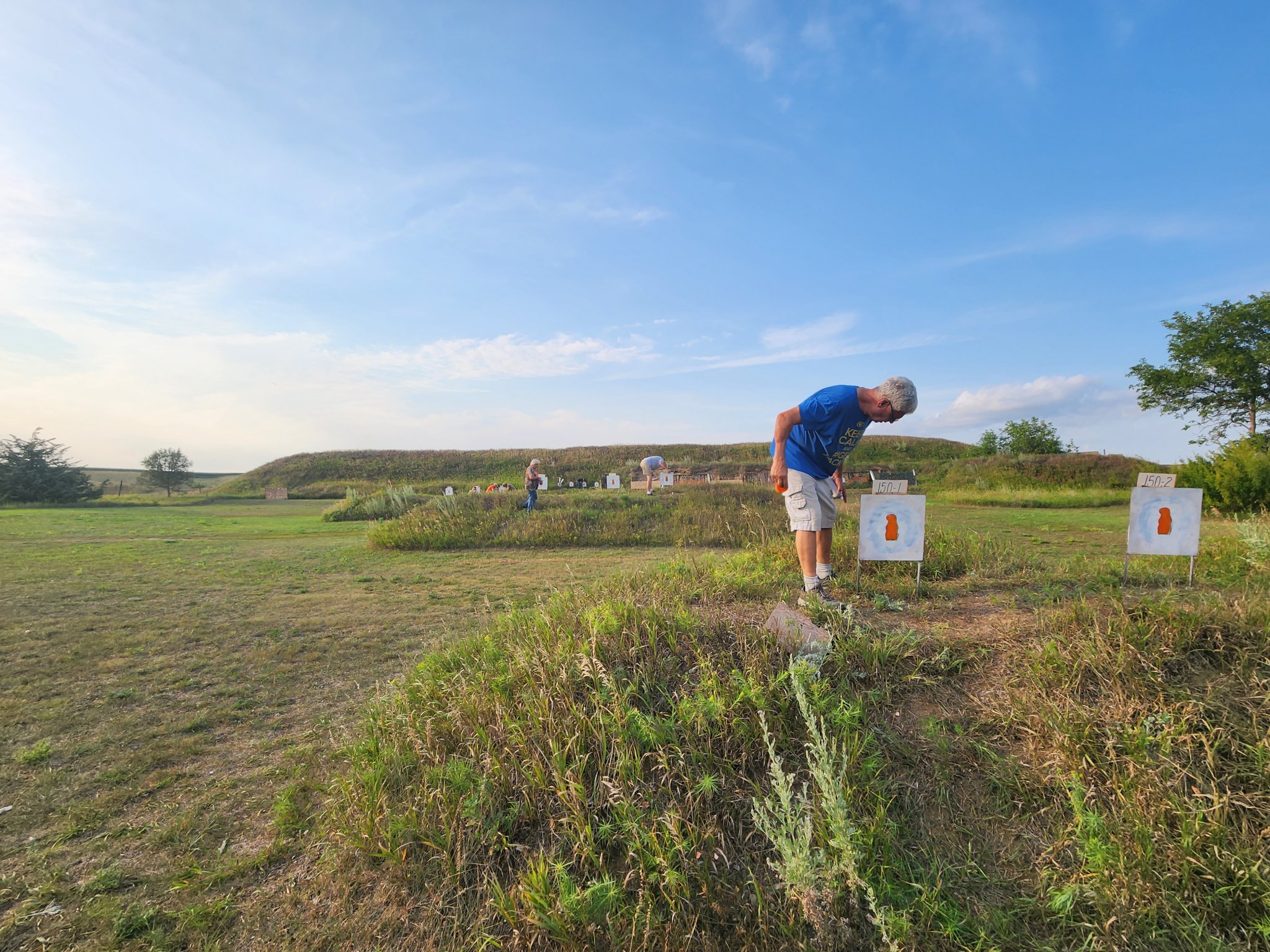

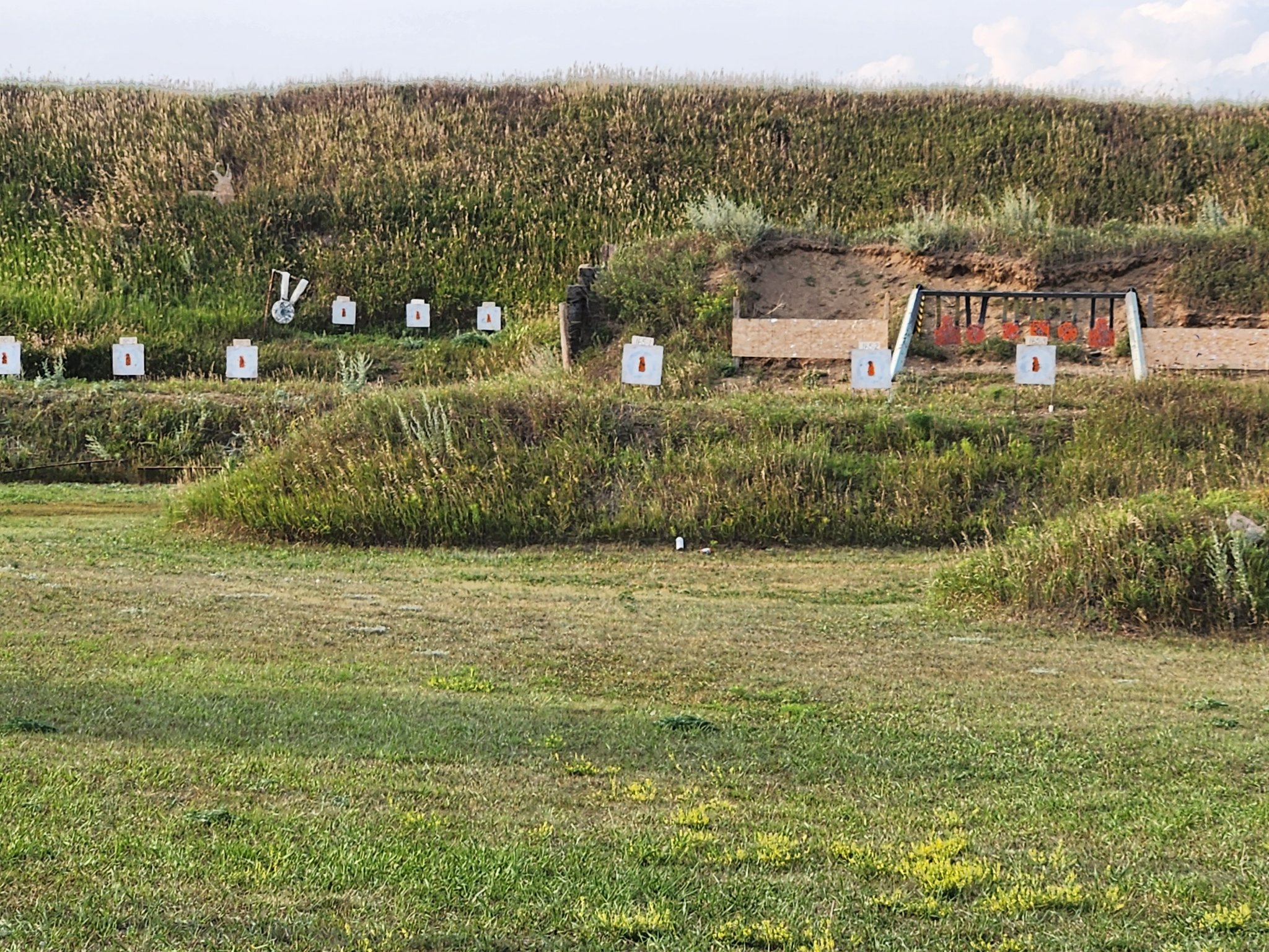

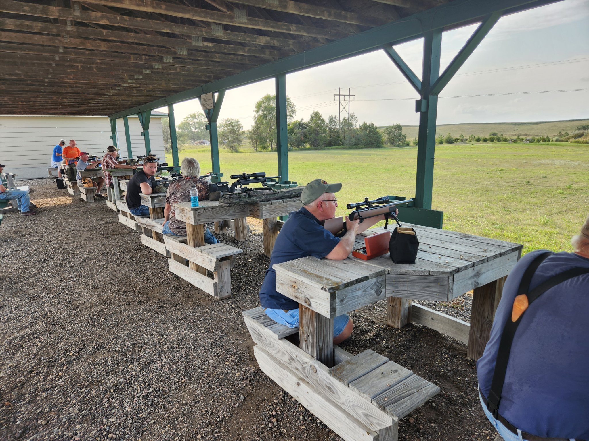

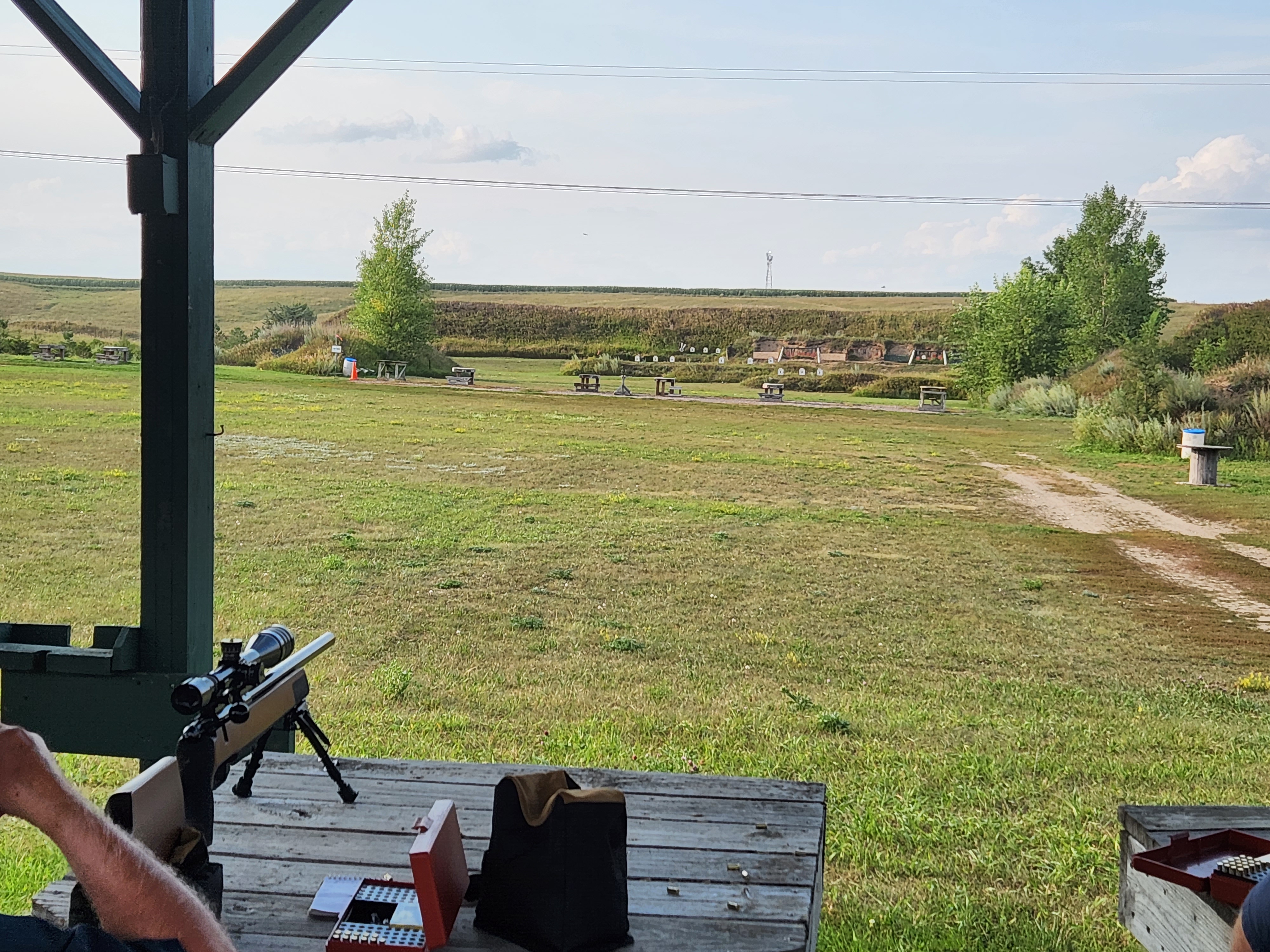

    Got after it again tonight after work. Brought a new guy out to try it. They did a second round shooting since we finished at 7pm.
    Help ya see the scale of the targets...
    12 shooters shot the first round. Tricky winds changing direction often going 4-13mph at half value from one way to half value the other.

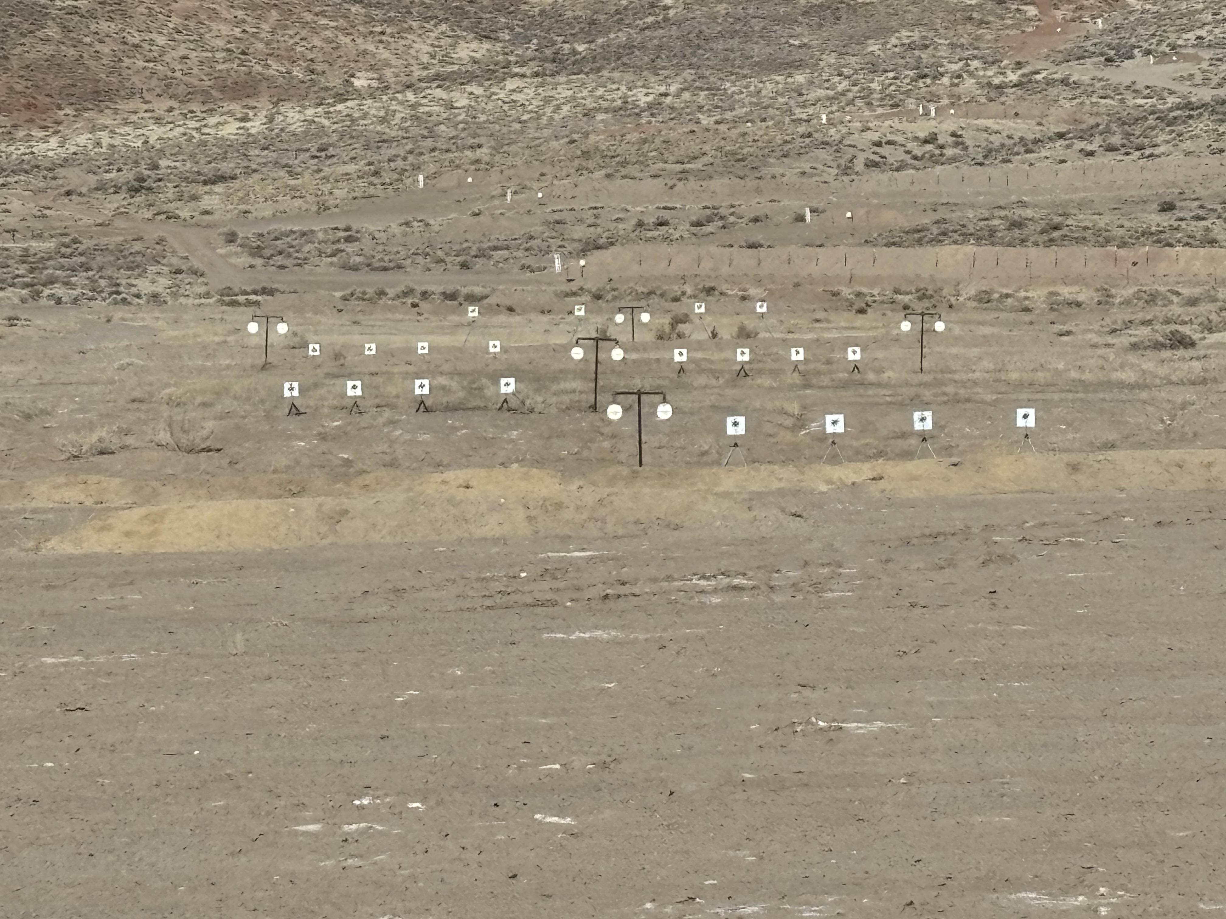

    Local range here used to do a "Mini-Palma" match. It was on an NRA Highpower range with pits, scored on 5v paper targets at 150, 175, and 200 yards. I miss that match.
    This was our long range varmint match before our range was closed...this match could easily be modified a little and turned into a 22LR match by changing the distances and if the targets are set up so they moved freely when hit that eliminates the need to paint targets ever string...old conveyor belt works very well...so does old fire hose but will need replaced more often...I am hoping now that they are slowly starting to reopen our range they will get this match running again.

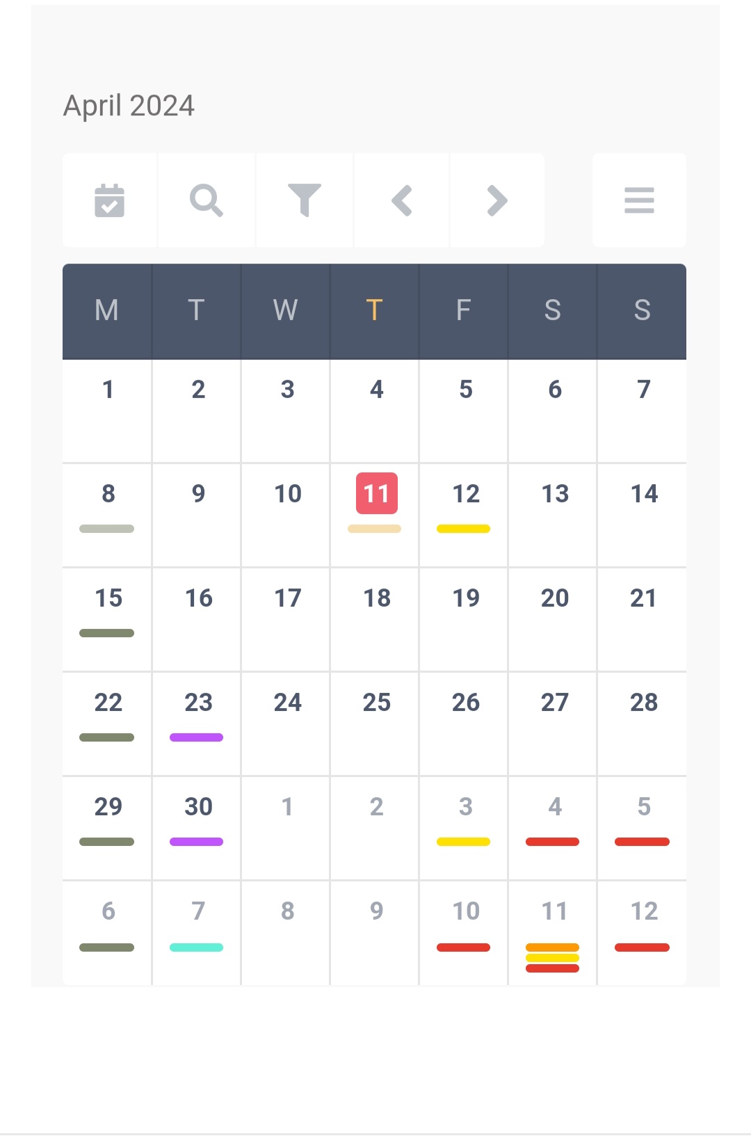

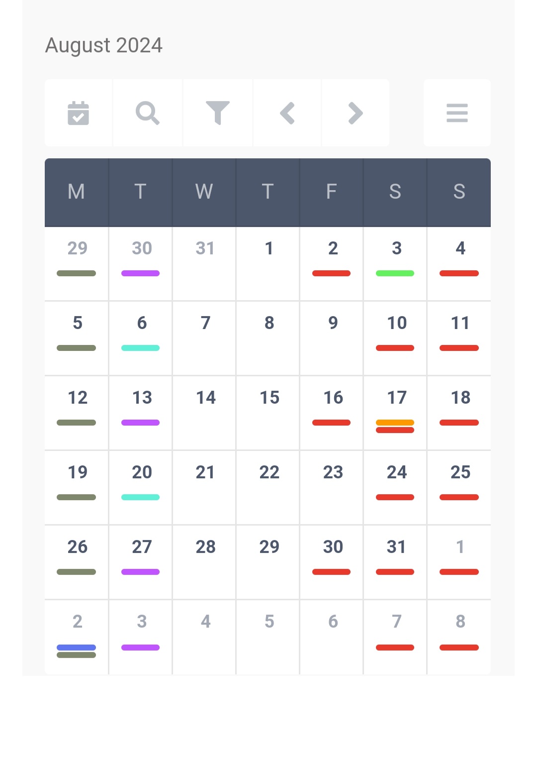

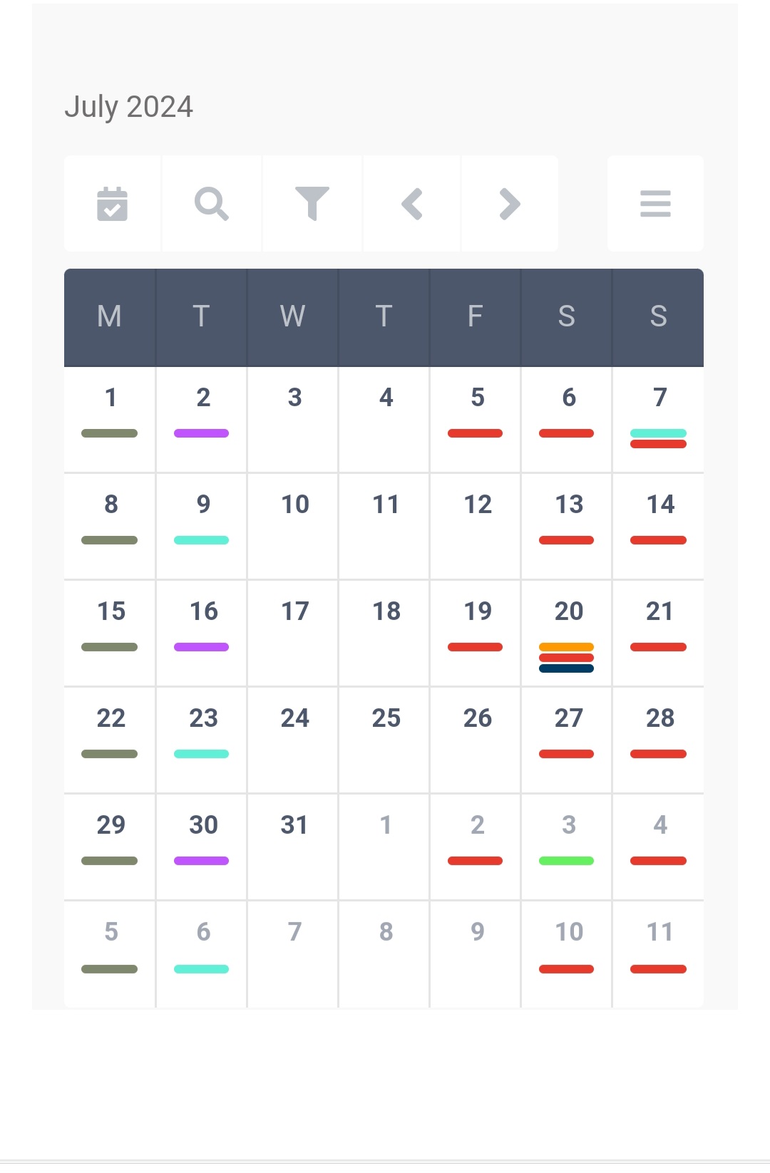

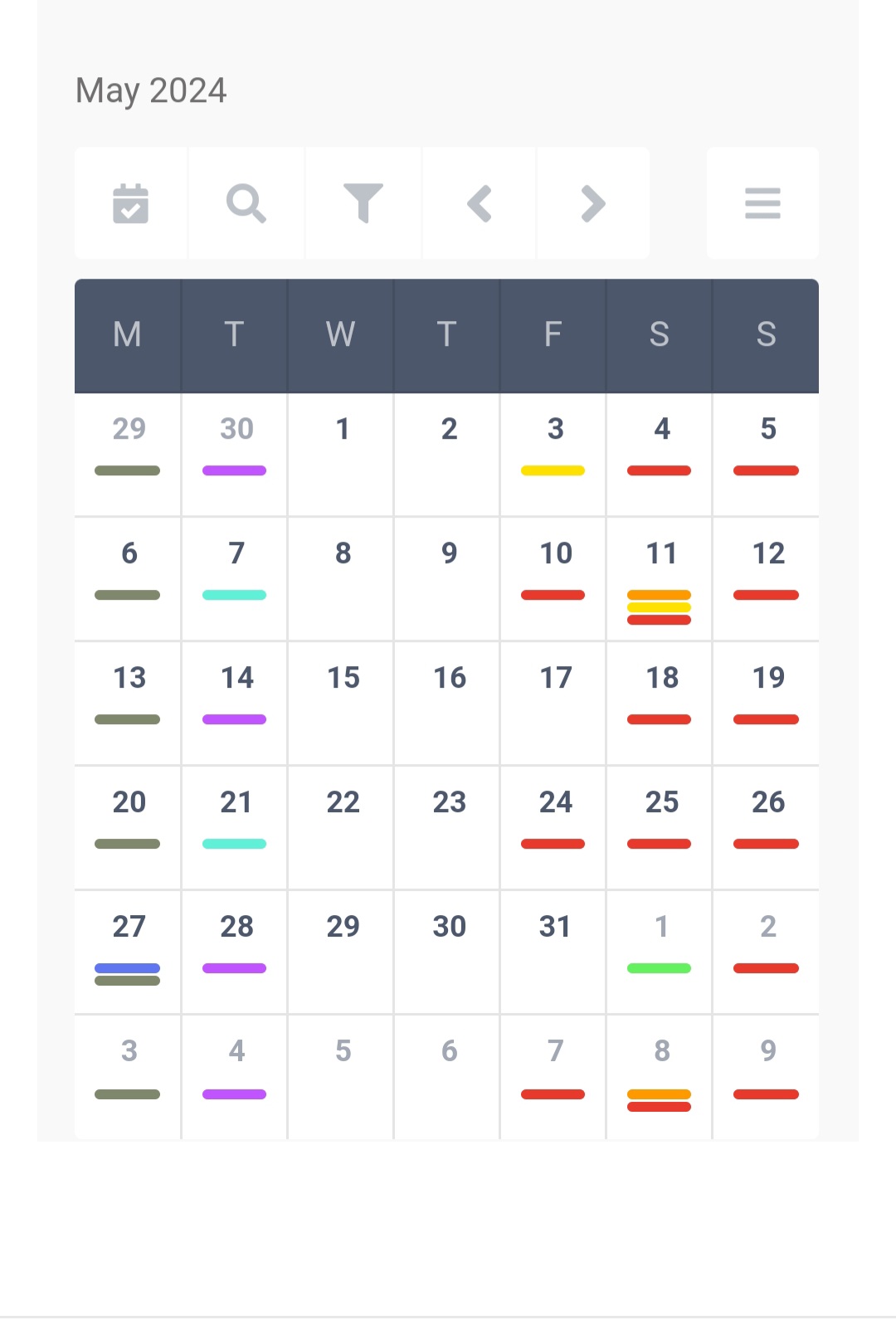

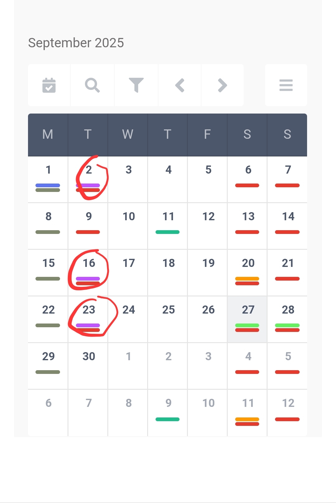

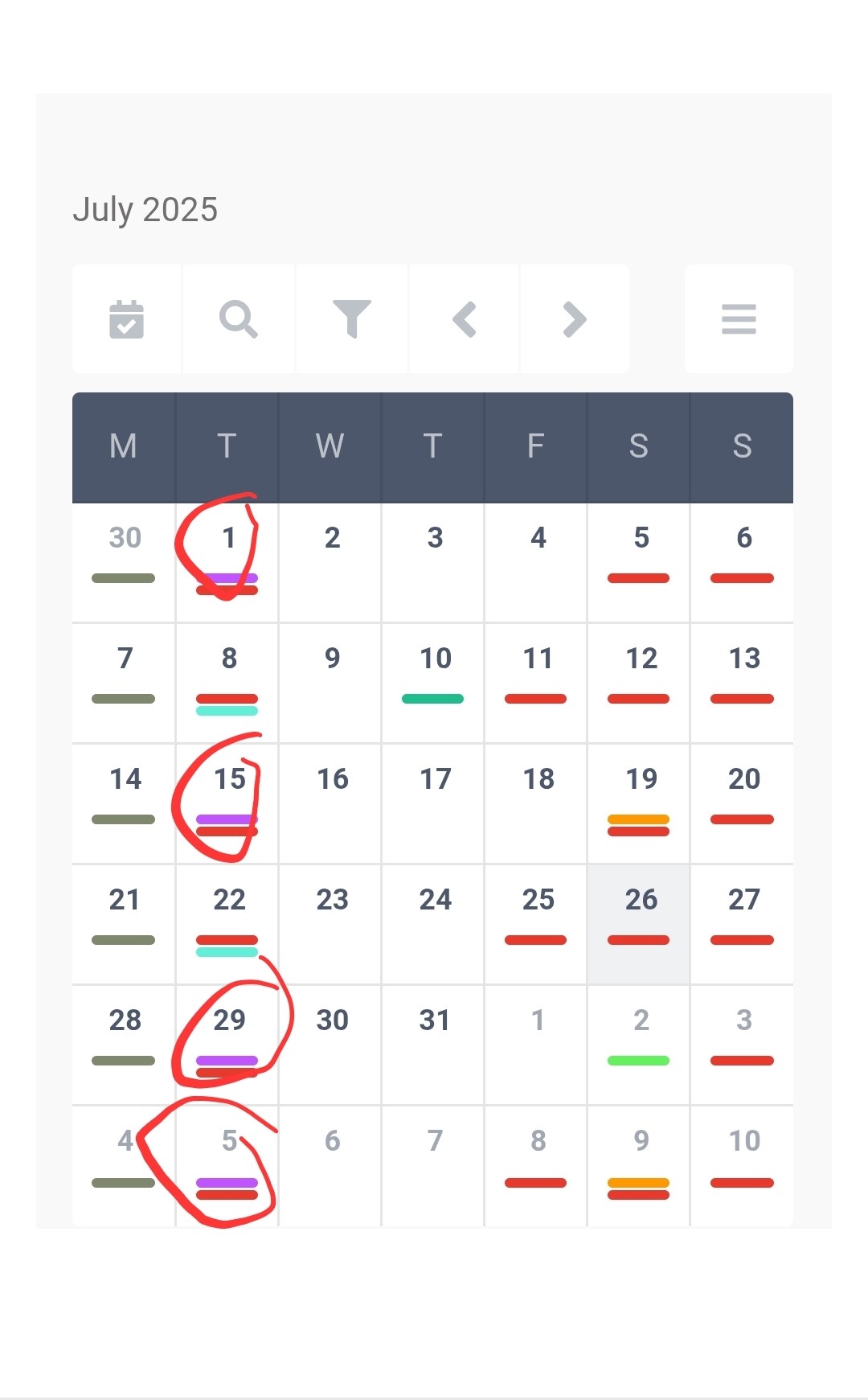

    This year's schedule (2024)....all the purple indicators are for LR Varmint. Matches are on Tuesdays and start at 6pm sharp. Be there ideally by 5:30 or so to sign up and pay your $10 entry. They have a cheaper rate for members if I recall.
    Also using this to bump this thread so maybe more people will get eyeballs on this and maybe ideas to try this for themselves on their ranges.

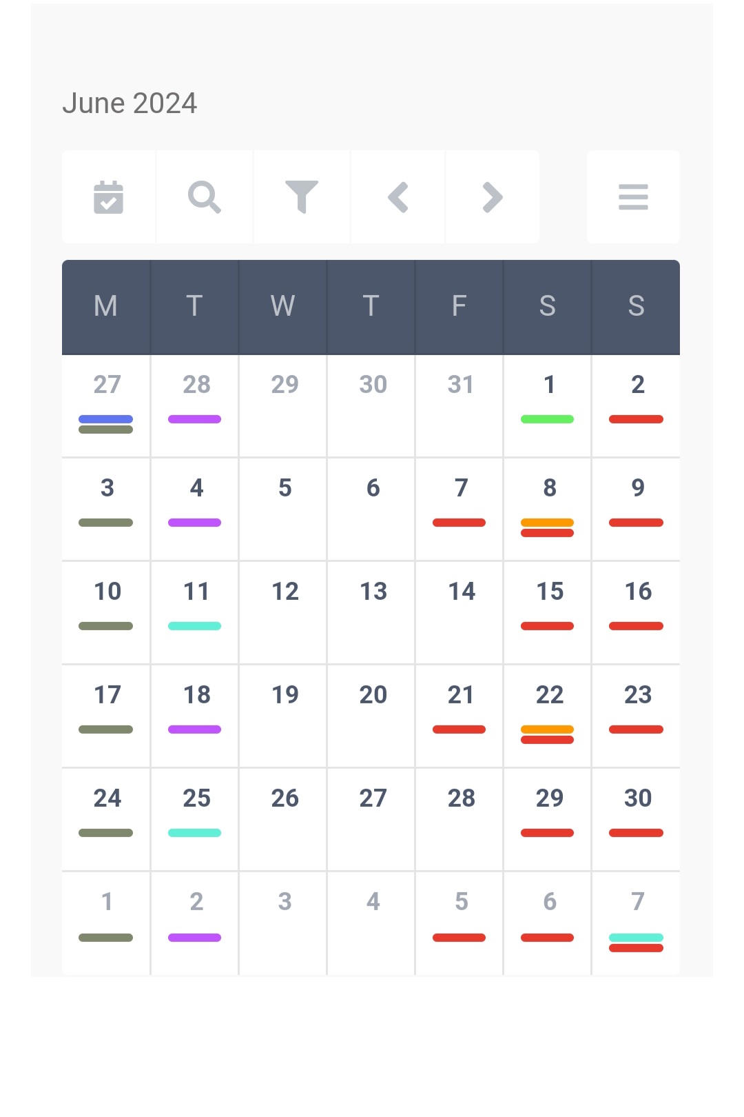

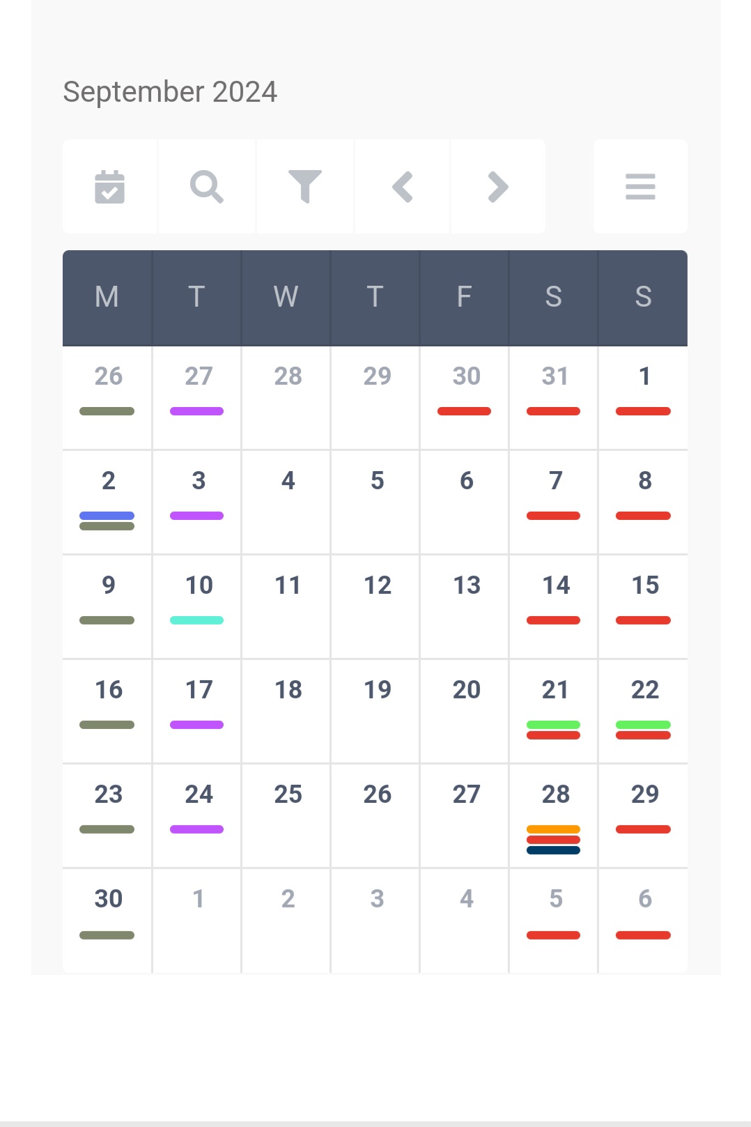

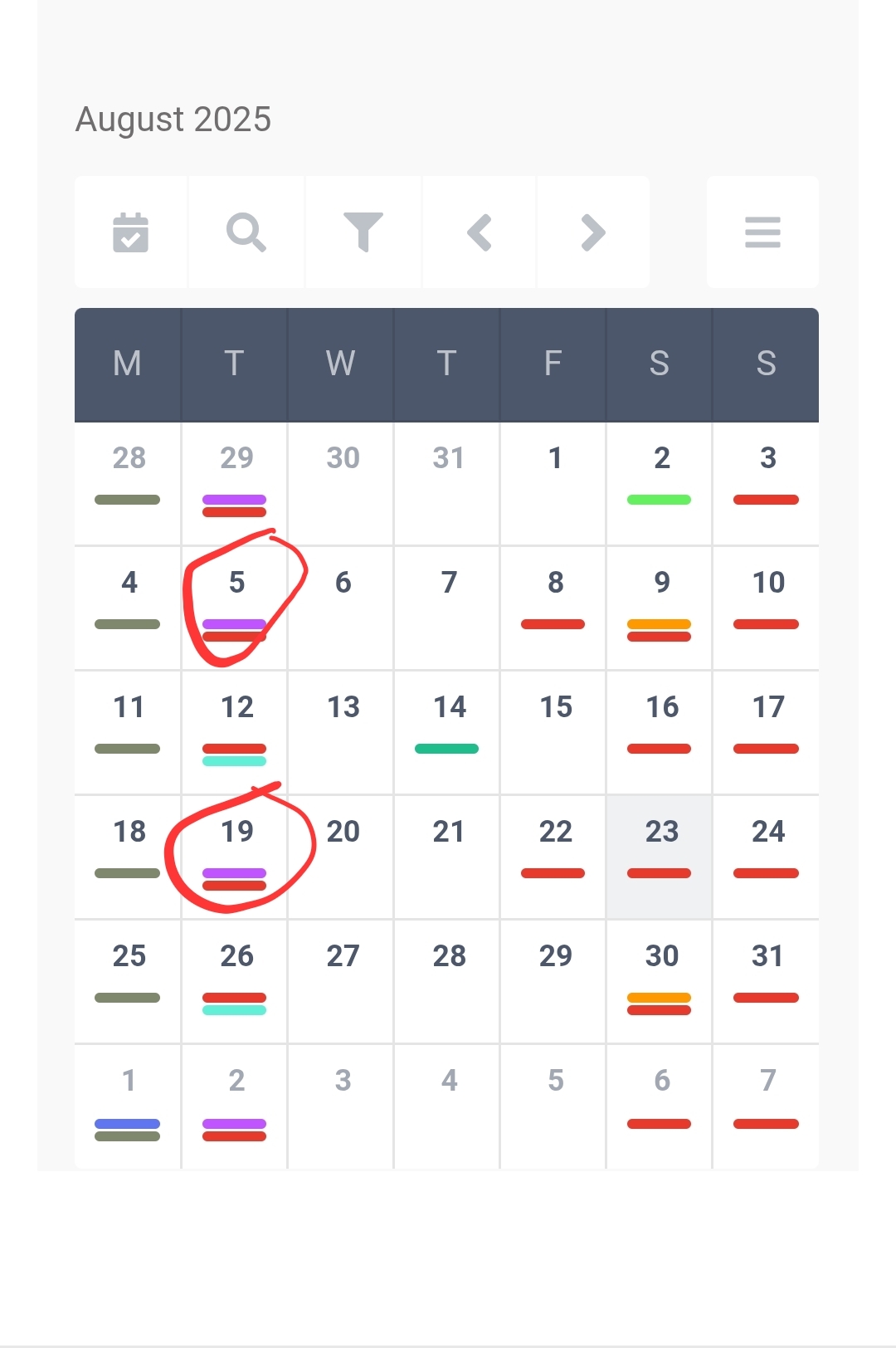

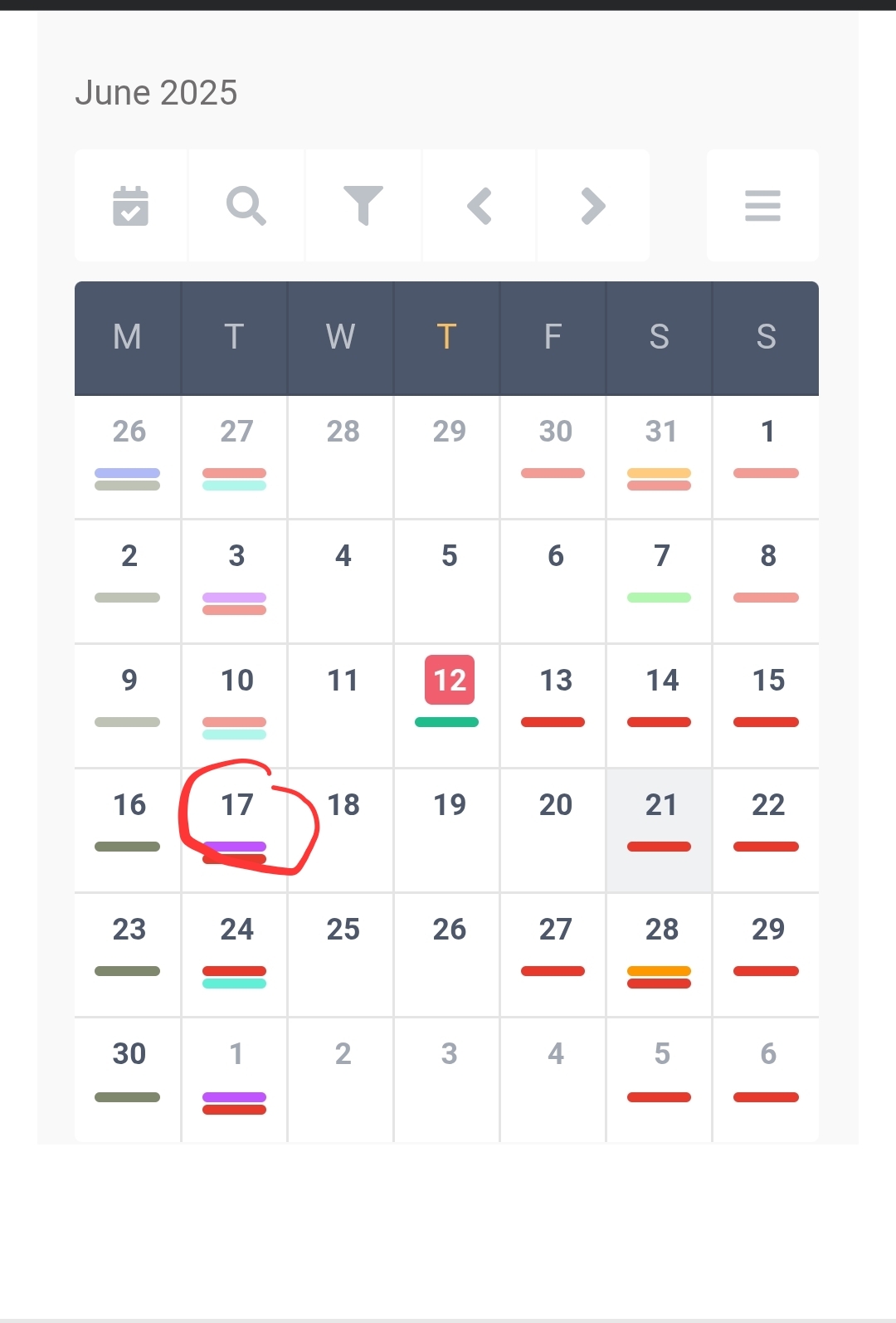

    Been busy with work.....also got forgetful. Here's the schedule for this year's Beacon Hill Long Range .22 matches in Volga, SD going forward for 2025. Also a good bump for eyeballs for people looking for a new game to play at their home ranges or for area people looking for a match to try. I also heard a rumor that next year Watertown, SD might get traditional IBS rimfire benchrest type match going. But that is so far just a rumor.

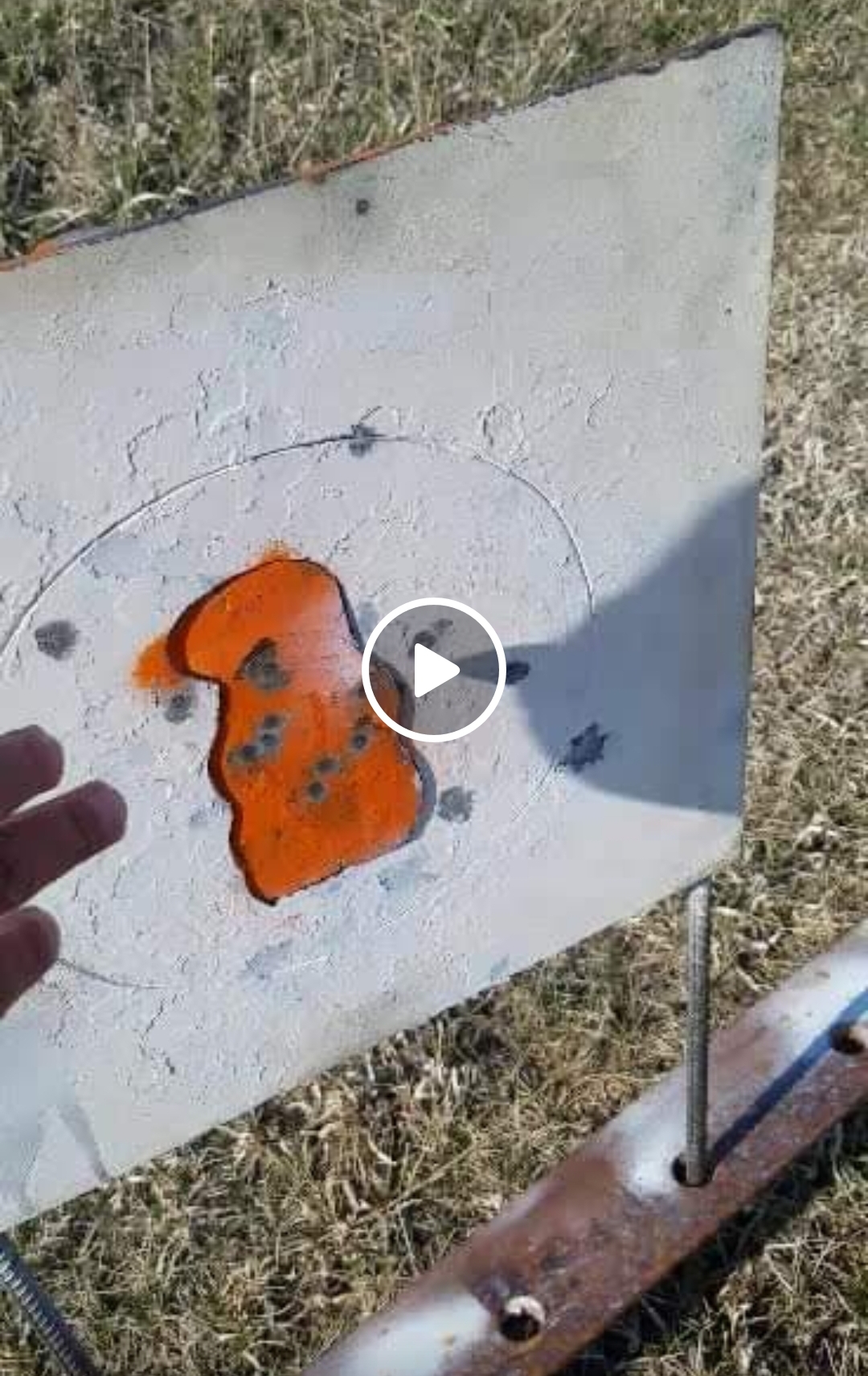

    With repaints in between this really doesn’t need to be that complicated.
    A smear of orange paint in the middle of an appropriate sized plate, and then lay a cardboard cutout of a gopher (or any other shape) over the orange and spray around it with white. If you really need the scoring ring you can do a disc of cardboard on the center, then spray around it with yellow paint. Hit will be super easy to see, and honestly, at extended distances aluminum plate would work just as well and can be hung on “shepherds” hooks.

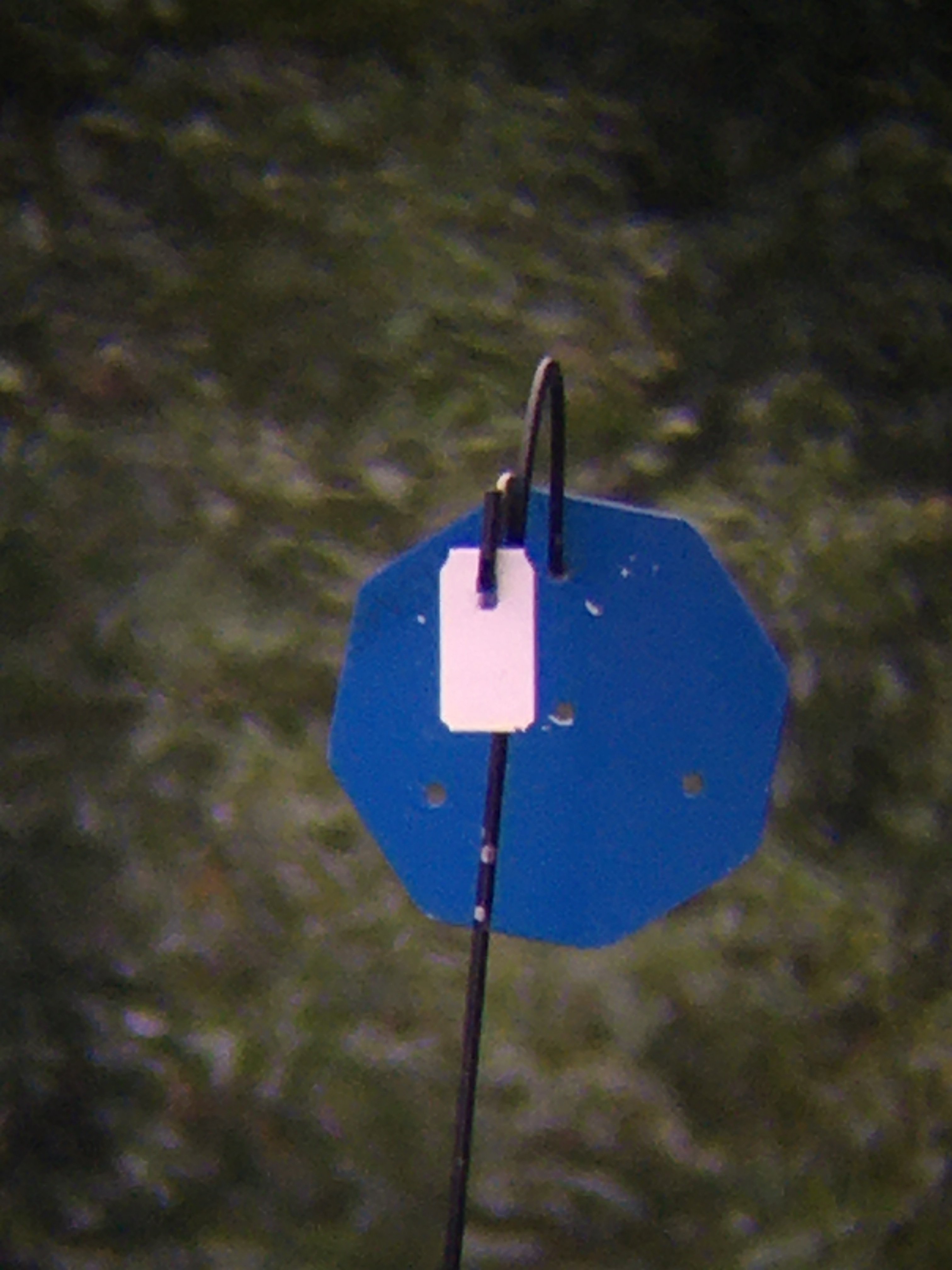

    Pic is of a soda can dinger in front of an aluminum plate, picked the hook up from a gardening center.
    Point being you can make it as complicated or simple as you wish. I myself have been considering a game with silhouette targets of known size (golf ball, tennis ball, 12oz soda can, etc.)

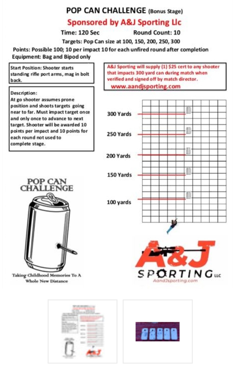

    The beer can challenge is quite.....well.....challenging single stage or event. My buddy has shot it like 5 or 6 times now and hasn't completed it. The 300yd beer can target is pretty damn small. Its pretty doable to clean 100, 150, and 200 yard plates. The 250 and 300 usually eat up rounds. I got lucky and have done it in 6 shots before.

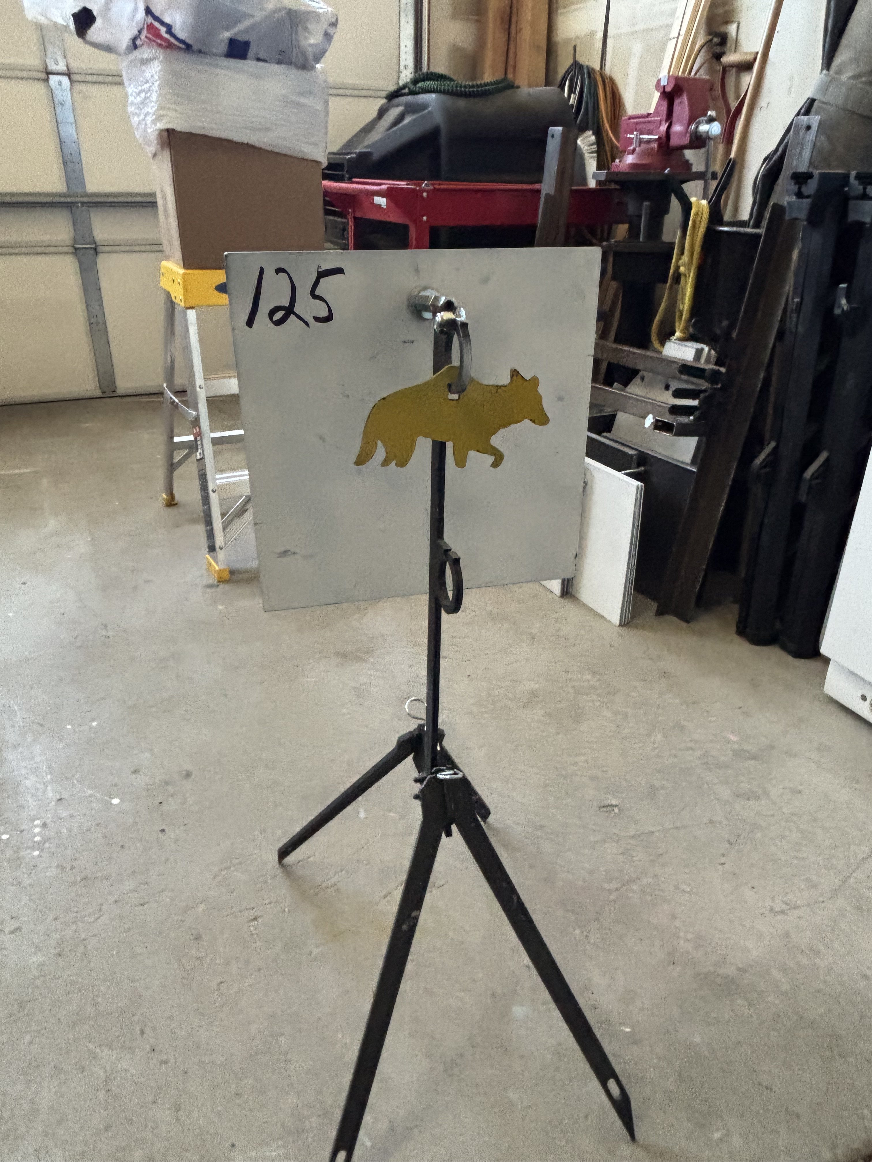

    I am trying to set up a Long Range Varmint match at our range here.
    We have shot a few practice matches and ppl love the match problem is all the weekends are taken and the match that blocks mine does not draw a lot of ppl so I’m pretty sure my match will replace that match next season
    We have…
    Bobcats at 100yds
    Coyotes at 125yds
    Squirrels at 150yds
    Pigs at 175yds
    Deer at 200yds
    And I think after a match or 2 I may change the yardages to…
    100
    150
    200
    250
    300
    The round hanging targets are for sighters which are unlimited on your first string but you can not shoot the animals until your ready to shoot for score.
    There’s more to it but that’s the basic idea.
