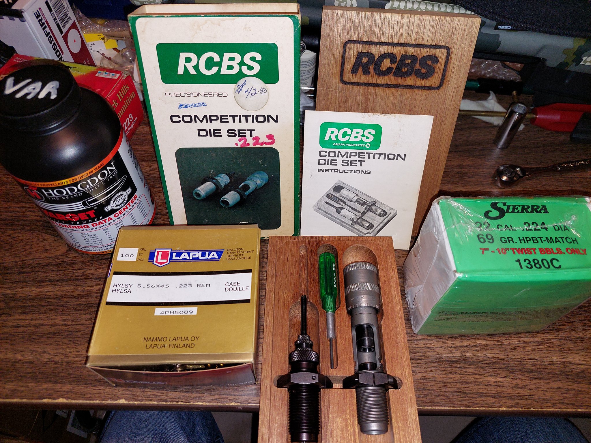

Want to spin up a few test rounds for a New GAP 223 Bolt Gun. Tried some Red Label Blackhills 68 HP factory, and the results were disappointing.
I have a little Varget left, new Lapua 223 Rem Brass, and a box of 69 SMK (1380) (brass and bullets are 15+ years old). Lucky to find the stuff in my basement :)
Sierra is listing an accuracy load of 23.6 grains for this combo. Nearly their max loading. Hodgdon is listing 24 grans starting load.
Thinking of starting @ 23 grains, anyone have a pet load for the 223 with these components?

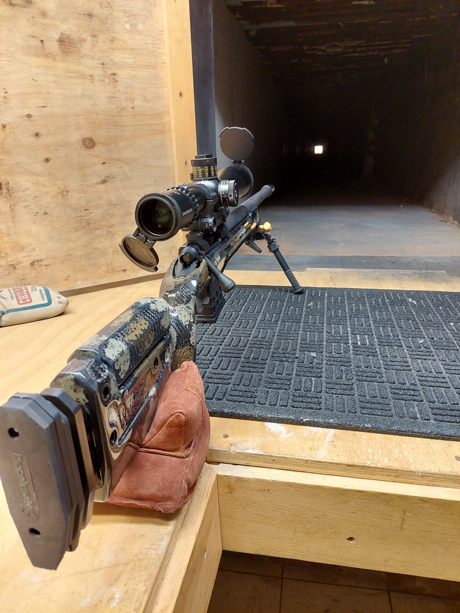

From a indoor range @ 100 yards best grouping was:
Pulled out some old stuff to spin up my test. :)
