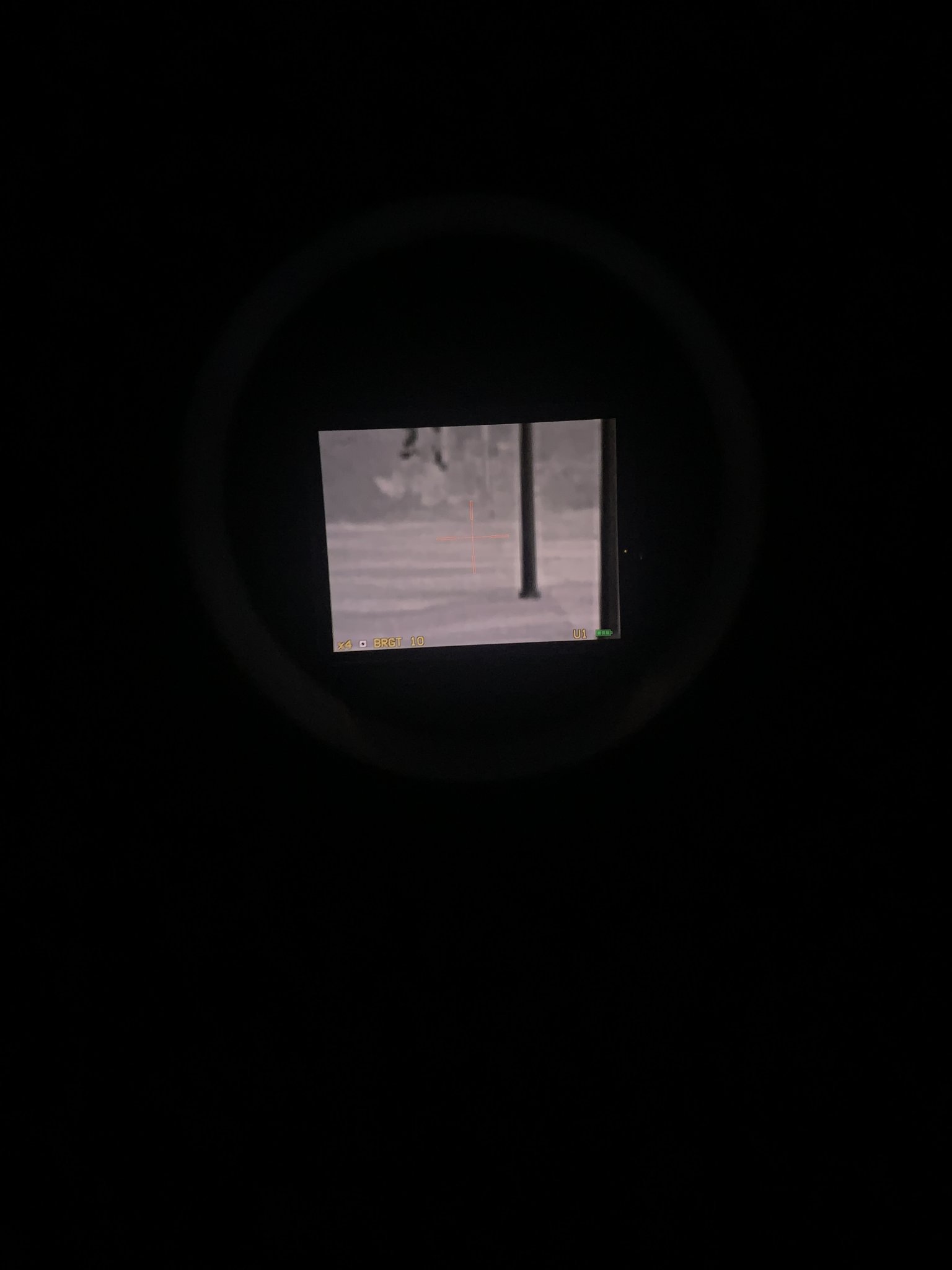

O40 at 70yds on 2.5x
note the step ladder by the chicken coop

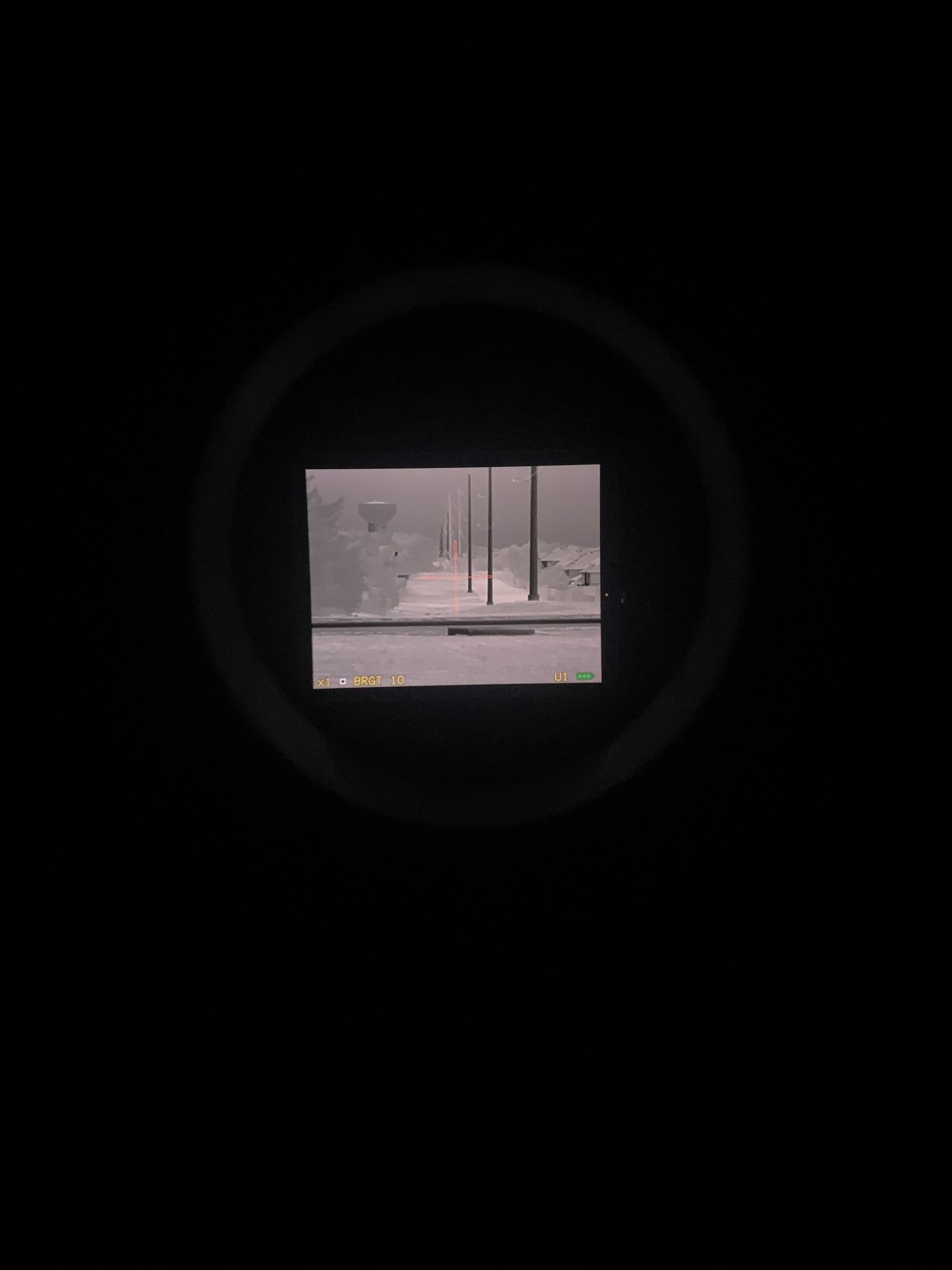

8x

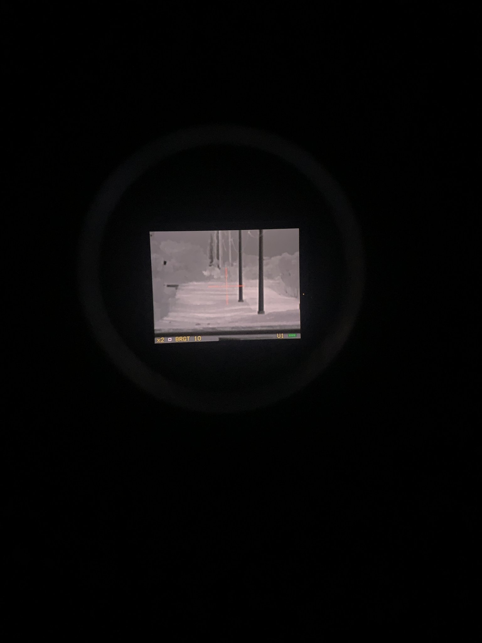

and the step ladder again at 15x
8x
