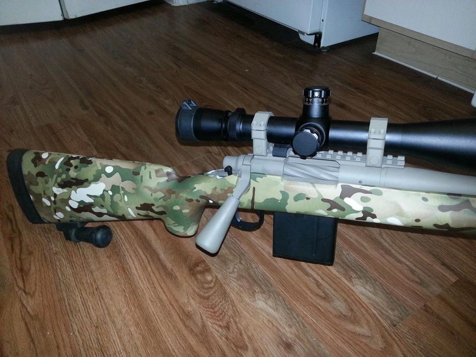

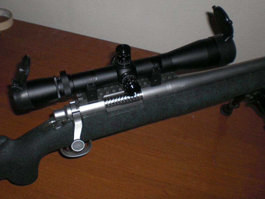

5R, good man...Congrats. When i built my 5R, first scope i purchased was the target version of the one you mentioned, the Leup 4-14. Its a great scope, however I kept kickin myself for not getting the 8-25x. I want to say with a coupon and sale i got it to the door for 1250ish from optics planet. I agree with above about the moa turrets and mil reticle, kinda blows.
I use badger ordnance rings and rail, no issues...
1st pic with the 14x when she was new, 2nd pic with 25x after a recent cerakote of rings, barrel etc etc..
Enjoy the rifle
