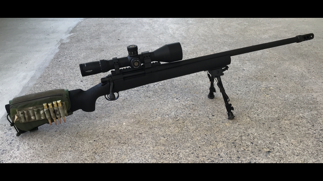

Thanks to everyone who answered some of the questions I had, here is the completed rifle.
For the muzzle brake look at the Area 419 self-timing brakes, you can get an adapter for the can and have QD functionality if you're planning on going back and forth because cans are great for hearing protection but recoil reduction is minimal.
