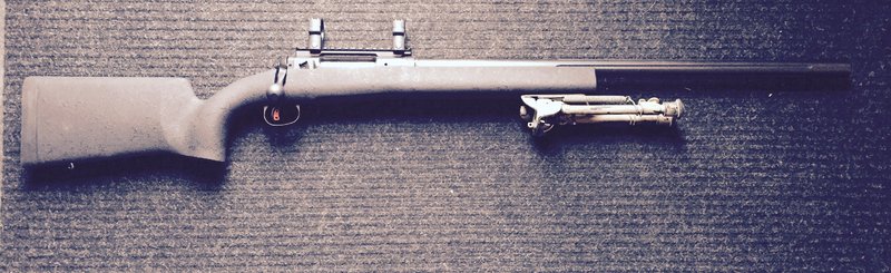

This is my rig. Brand new Savage LRP in 6.5 Creedmore. 26" heavy barrel, light flutes, accutrigger, H&S Precision stock. This is how it sat in the safe since January. Opticless.

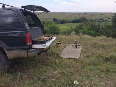

Went out to western Nebraska today. I had a list of tasks I wanted to complete.
1- zero
2- correct turret value in AB
3- true muzzle velocity
4- shoot like a BAMF at long range
i got a good zero alright. Had to reset my zero stop from the last time I zeroed it. Immediately started having problems with my rifle. The little "tang" that the Savage trigger has kept locking up & I would have to recock several times to get it to release. I had just drank a cup of coffee with a kick of sugar in it & I really got frustrated. My back was cramping something fierce from a short night sleep in my shitbox camper. I had no cell phone service where I was at & couldn't look up a cause for this malfunction. I picked up camp & headed out to set up a long range target. Figured I could get it to fire for a couple of shots. Once I got up in higher country I consulted the interwebs & figured out that if I lowered my bolt softer, I would not have this malfunction. I set up a steel target at 1010yds from my chosen firing position. I ended up shooting a box of 140gr ELD Match at it with about 6 hits before I got dialed in. Then I switched to 143gr ELDX's & got 20 hits in a row. I know burning a box of ammo to get dialed is not legit. But it was a start. I think now that I ran my correction threw my solver I can start way closer than I did today. Going to try & set up my tall target test in the morning. I'll set up several targets at varying ranges & test my new dope. Like I said, not exactly legit but it sure felt good to get consistent hits at that range.

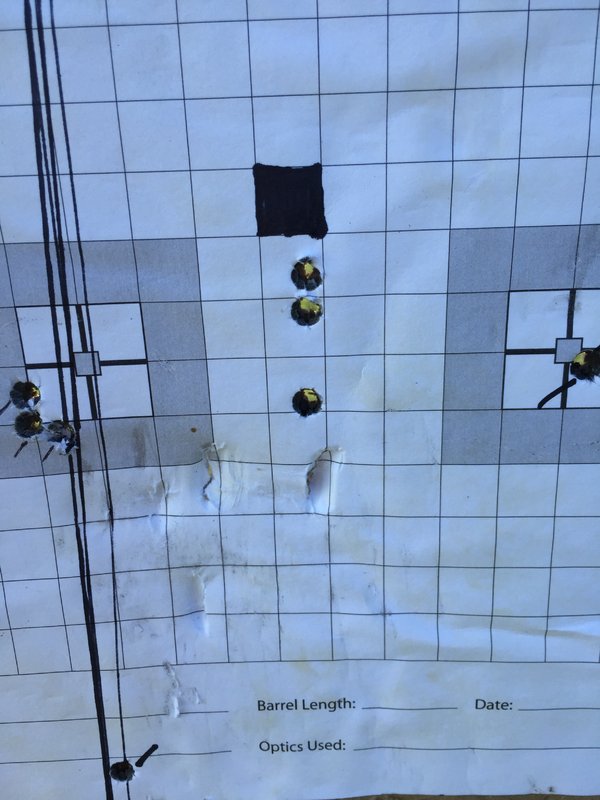

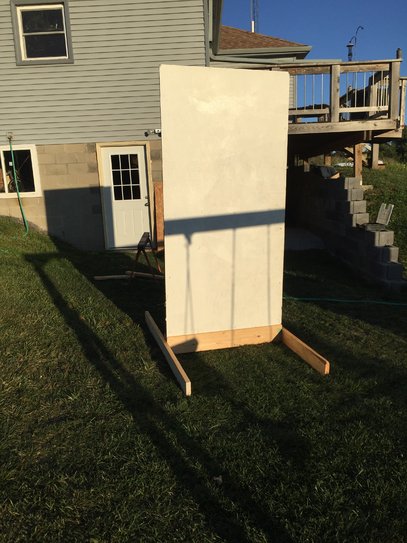

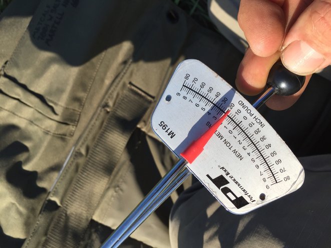

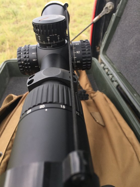

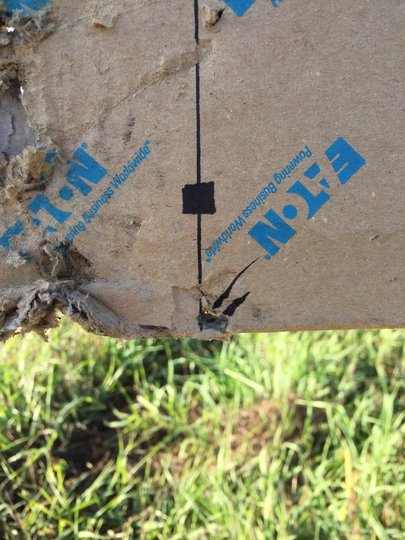

Out again this morning & started at the 100yd line again. Was going to shoot a tall target test. I couldn't get my rifle to group worth a shit. I had some weird vetrical stringing. My zero had shifted 1 1/2 lower again. Seems like when I dial up, then back down & hit my zero stop my zero shoots low. I did get out a torque wrench & torque my optic rings to 18in/lb. I did not have them quite tight enough. I'm not blaming the optic yet by any means. I'll dig into my manual & do some more testing back here at home from 100. I did not feel good enough about my groups to do a tall target test & headed back out to set up a few longer range targets. I had one right at 1000, one at 985 & another at 8somthing. When I got back to my firing position I realized that 2 of the 3 were obstructed by trees. I went ahaid & dialed in for the 1000yd target. Today I shot an azimuth & entered my latitude for coreolis. Still took till shot 5 to get my first hit. I was really darn close starting out though. I would say I was just waisting ammo to hear steel ring at a 1000. I ended up dialing 8.75mil up & a mil of wind.
