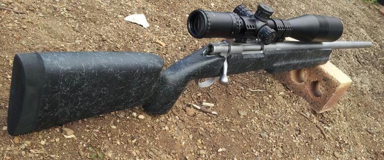

My howa 308 was almost identical to yours before it got an extra 6" of barrel and single feed bench stock. Hopefully it's new barrel shoots as well, asking for better is asking too much. Twas a tack driver.
Currently building my 3rd Howa a 338 375ruger switch barrel.

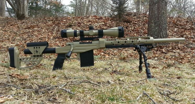

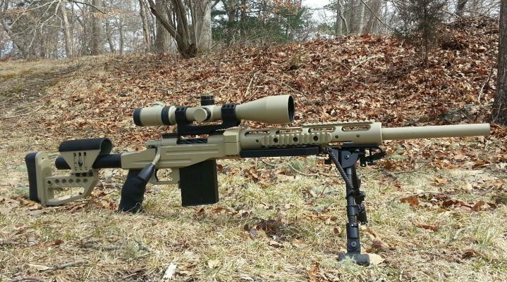

Love my Howa and I am finally done with her. Started as a simple .308 with 20" and now....

Jeremy, It is the XLR and around $800 with all the options. As for the B&C, it was a good stock and I had that for over a year before I upgraded and I picked it up from Red Hawk. It shipped out same day and I had great CS with them. As far as painting scope and rings, if it is a DIY then there are a ton of tutorials on this site. Simple Krylon or in my case Rustolium, clean and prep the surfaces, hit it with a bit of fine grain sandpaper to rough of the surfaces, hit it with primer and then spray. It will wear off so if you want something longer lasting then creakote is best.
And on the Howa, they make a DBM system made of hard plastic. I picked one up to T&E and it worked great. I had no issues with breakage and my rifles see heavy field work and I am not a bench shooter. I still have the system, although replaced with the XLR magazine system, and it held up with over 1000 rounds. It goes against the grain, not getting the metal, but I give the Legacy DBM system five stars. So if you want a magazine system that is a very good and cheep alternative.

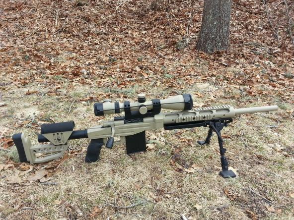

Here ya go!
Stock is OD green and the barreled action and scope are earth brown. For some reason, the pic is way smaller on here when you open it, than it is on my computer.
