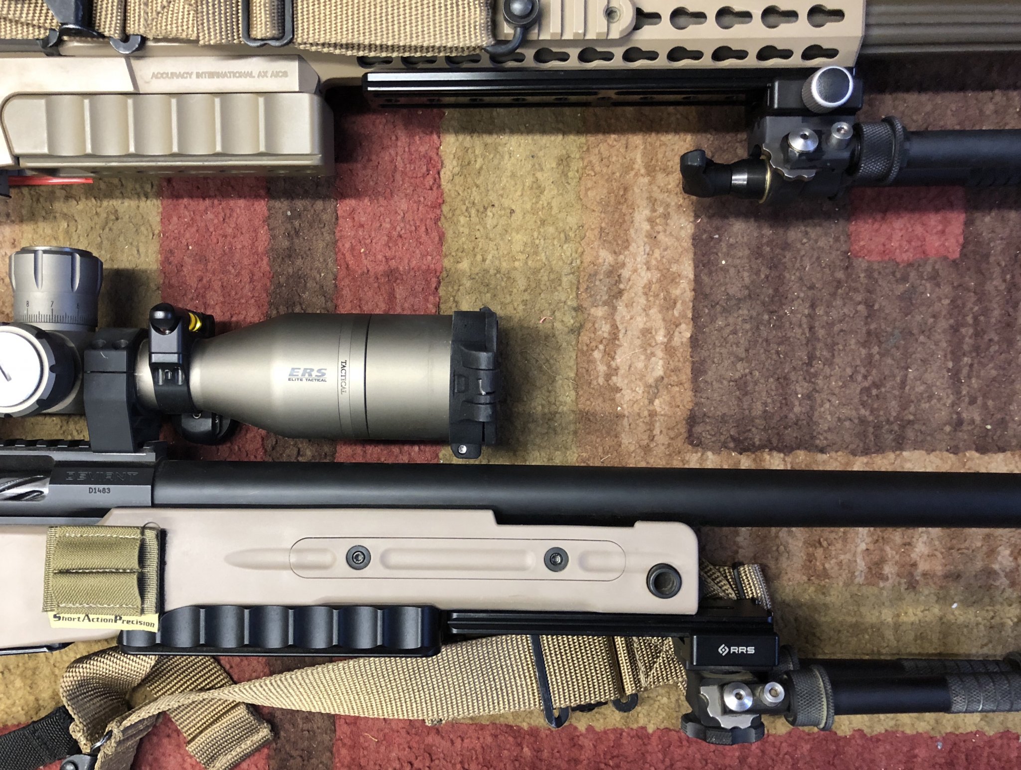

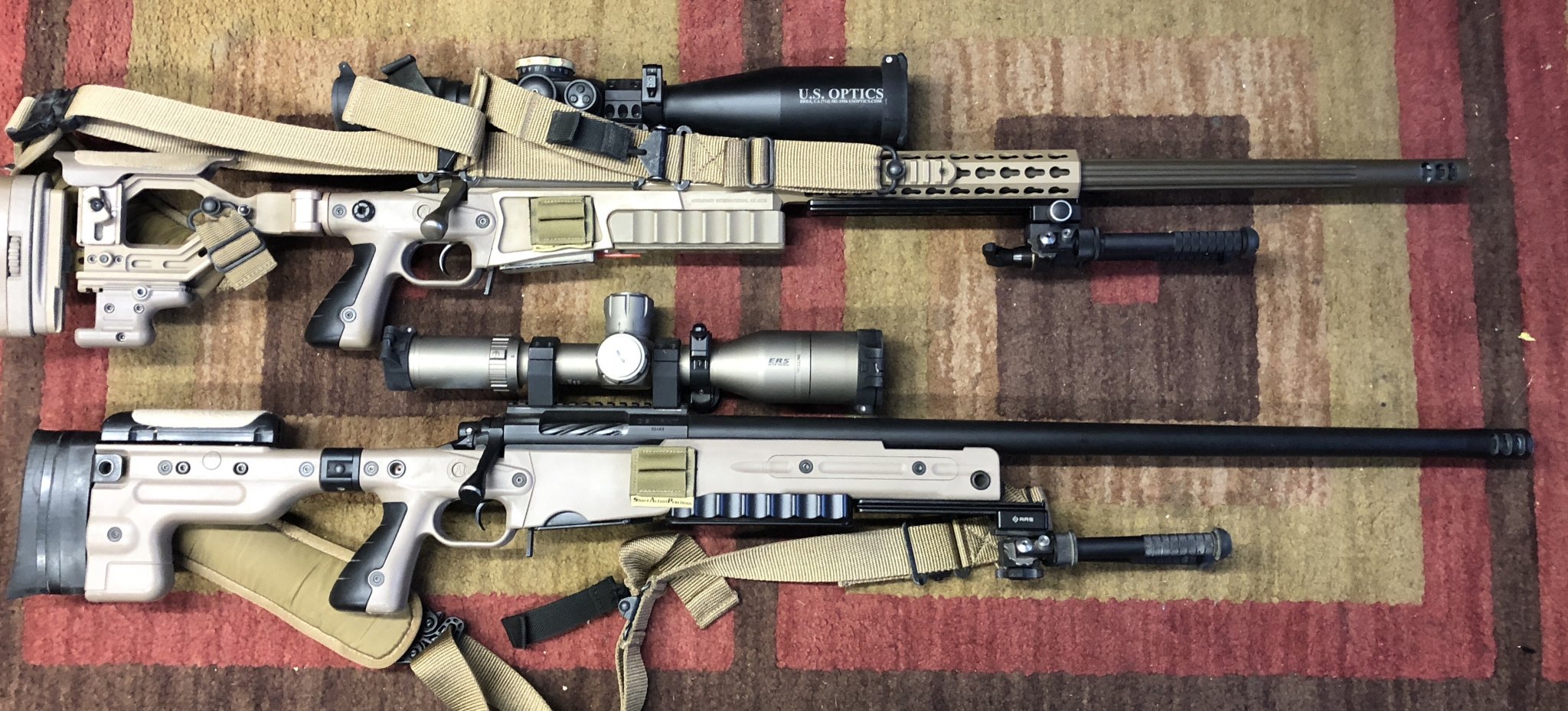

    I have been using full length ARCA Rails cobbled onto the forearms sense RRS came out with the conversions for Atlas and Harris bipods.
    Not only does a device like this allow you to quickly slide the bipod to shoot off a barrel or other small foot print, it can work like an MPA front barricade stop. Maybe more on this later. But these are a game changer :)
    Anyway, HRD-Gear is making a few very cool offerings. Here is one (top in the image) for a SA AX.. keymod at Mile High.
    https://www.milehighshooting.com/hrd-gear-afax-09-full-length-arca-rail-for-ax-sa-forend/
    The gun at the bottom shows a 6” standard ARCA rail (not RRS dovetail) on the AT chasis. It extends to the same distance the spigot mount would. This was done BEFORE a full length HRD-Gear AT option was available. If I was going to do it today, I would forgo the RRS handgaurd /dove tail and go the 11" HRD-Gear.. You will need the SLOTTED version for the AT to clear the spigot release on the bottom of the chasis. https://www.milehighshooting.com/hrd-gear-uaf-11-full-length-arca-rail-for-la-forend-11/
    The top one is the new HRD-gear sold at Mile High. The also have new universal 9”-11” slotted versions..

    On the Mile High web-sight they show a 9" HRD rail for $175 for the AIAT. Can I assume if you get the 9" version you don't need the RRS rail?
    Yes, in hind sight, that is what I should have done on the AT in the lower picture in my OP.
    FWIW I used standard short Arca style camera plates on most my rifles long before RRS made the SOAR product line. The image below is an example:
    When they came out with their chasis specific plate/hand plates. I added those.
    I was not until they came out with a way to mount the bipod to the RRS 1.5" and ARCA dovetails, that I starred cobbling to together longer forend options as in the image below. The man issue I found is that most cheap camera plates do not lock up thin the RRS 1.5 dovetail.. So it was a complete pain and trial and error process. That is actually a camera plate hogged out to fill the profile of the hand guard.
    Thats why the AT in the bottom image in the OP shows both the RRS plate/hand guard and a longer camera plate.
    Once I experience the speed and versatility of the RRS bipods and the dual use as barricade and recoil stops I was hooked.
    If you have M-lock Henderson Precession makes very nice full length rails that are setto RRS 1.5 dovetail standard.
    Hmmm...not seeing the 6" rail for the AT on the website. Any specific reason?
    Sorry, I was not very clear.
    The 6" is my cobbled version before I found the HRD-Gear's AX offerings. It is also because I already had the RRS hand guard/ Dovetail adapter. I used a 6" slotted rail and drummeled out (widened the slot) a section for the AT's spigot release and used heavy T-nuts that I had for another project. The setup falls short of the entire one piece AT solution now offered by HRD-Gear but was a $14 option https://www.amazon.com/gp/product/B00CHDR82G/ref=oh_aui_detailpage_o02_s00?ie=UTF8&psc=1
    If I was to start from scratch on a AT I would get the HRD-Gear for the AT choosing either the 11" and ditch the spigot mount that almost always has play or go with the 9" for a flush look.
    BUT you have to go with the SLOTED version to clear the QR in the chasis for the spigot https://www.milehighshooting.com/hrd-gear-uaf-11-full-length-arca-rail-for-la-forend-11/
    But it is nice to see they also have a bunch of options for other chasis.

    Is that a CAL bipod above photo? Are you using RRS arca adaptor
    So just to confirm if we do have the RRS AT plate already the 9" or 11" HRD rail will still work except they would not be flush but can replace the spigot mount? I like the idea of getting rid of the spigot mount but would like to keep the RRS plate as well.
    I went with a 6” and got just about the same extended footprint as with the original spigot.
    The 9 inch might be nice, but you would have to do a bit of work around if you’re going to keep the RRS handguard. Also my concern would be that you would have about 5 inches of cantilever and that might work the key mod a little hard.
    The one on the AX is definitely a CAL...the adapter looks like an RRS as well.
    Yes, RRS adapters on the CAL, PSRs and Harris. The reason one is backwards is I was on a stage we’re i needed to adjust left handed.
    Btw I am using the bipods as barricade stops on the target side. Running the RRS yo on one side and the bipod on the other to create a sandwich
    That makes complete sense, since the CAL has the integrated barricade stop built into it. Just flip it around, so the BS is facing the shooter, and slide it back until it clamps between the RRS AI adapter and the bipod BS. Right?
