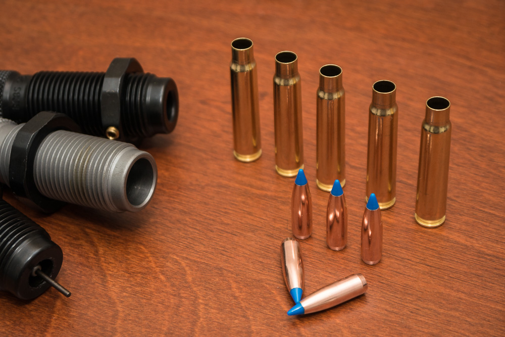

    Taking a gamble on a new cartridge. The dies came in first, so I started resizing brass and preparing to start loading. Obviously, I'm excited to see if this idea works out!

    I haven't heard of 25-223 until now, but it sounds there are many names for the same thing. 25-45 AR, 25-223, 25-45 Sharps ... this gives me a better idea where to start with load recipes. Hopefully I can find one with the powders I already have.

    I was drawn to 24-45 Sharps because it's a simple neck-up from .223, no fire-forming or case trimming or anything special. Now I'm doubting I'll be able to improve upon the Sharps load of a Speer HotCor 87gr going 3000fps, at least in a magazine-fed AR platform. DK made a wise choice in going with a bolt gun.
