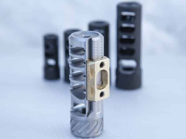

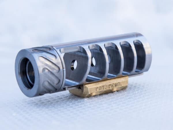

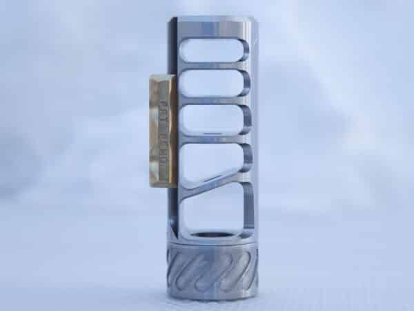

New Insite Heathen brake with an interesting slidable brass tuner. Also interesting that they went to straight ports as opposed to rear angled on the original Heathen.
It's an interesting take on a tuner brake, certainly not like any tuner or tuner + brake combo I've seen before.
I've been talking to Harley at Insite Arms about this, apparently one of the ideas behind it is that you can remove the tuning weight without having to remove the brake.
Apparently the ports are every bit as effective as previous generations, and send even less gas back to the shooter.
I'm not huge on tuners, but it's a pretty neat design.
I agree, it’s the first tuner brake that I’ve actually been tempted to buy and it’s pretty reasonably priced.
Very neat design.
And the cool thing with this design is if you don't want the tuner, then just loosen it and slide it off.
What I would like to see is some positive detents for each tuner position, so you can lock and move the tuner through the positions without having to use set screws or any tools.
I personally hate set screws. And a tool-less method of moving a tuner between positions would be a better mouse trap than all the current solutions.
