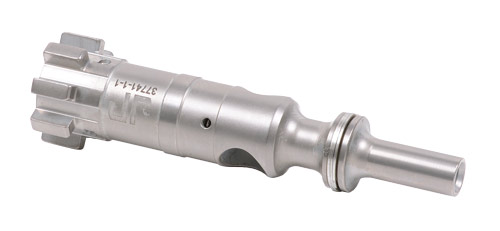

Guys I wanted to let you know if you diddnt already know that JP's 6.5 Grendel is out. I just ordered a new 6.5 Grendel Enhanced bolt from JP. I have been waiting for months for there release and its finally up on there site. It is Nickel Boron plated and by the pix of it looks awesome!. I have the AA bolt in my new SCR-11 and what I have read it is a fantastic bolt but by the looks of the pic the finish and machining looks awesome.
Cant wait to try it out.

Well I received my bolt from JP today and I will tell you that the Nickel boron finish and the machine work on this enhanced bolt is awesome!!..This is top shelf and the price is worth every penny. Im glad JP decided to include a 6.5 Grendel bolt to there enhanced .556 and .308 bolts
WOW!!
