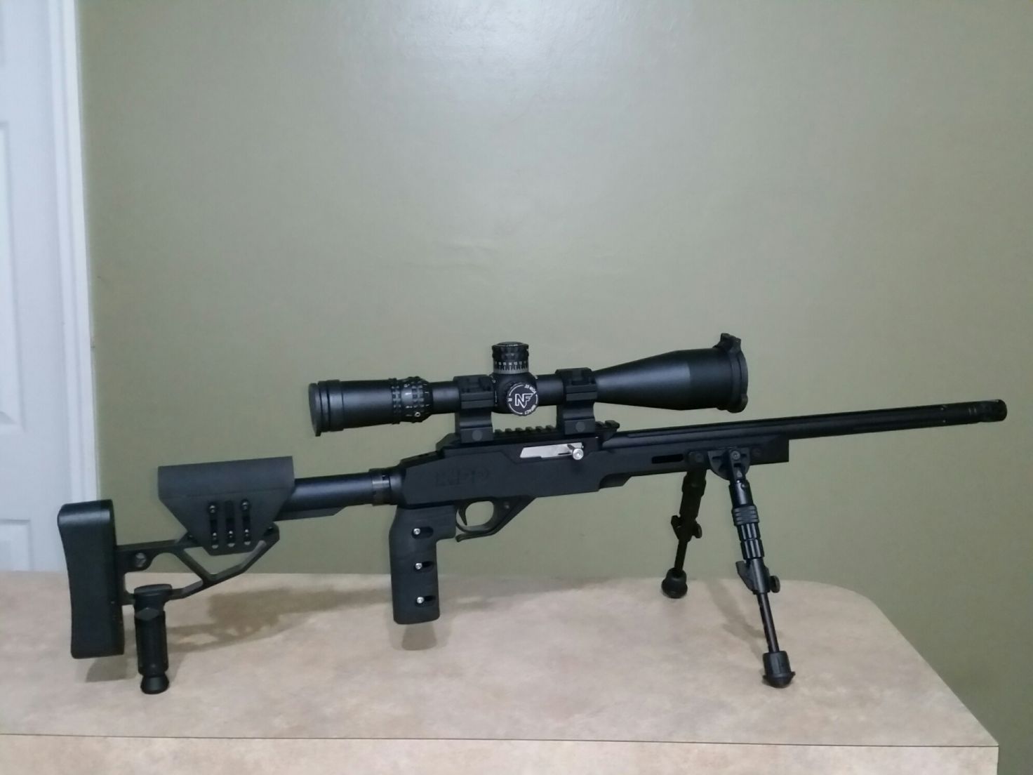

The Kidd chassis arrived late today. I've had limited spare time to work with it yet.
First thing is that the T/CR22 action is loose even when torqued down pretty tight and using the "rear stabilizing screw". A Kidd take-down screw might fix that... but there wasn't one included. I do have a Kidd take-down screw on order that hasn't arrived since it's shipping with an entire Kidd slip-fit receiver.
I bought both the Magpul and Hogue grips that Kidd offers and was unimpressed with the feel of either. Separately I ordered a Masterpiece Arm EVG grip, but couldn't get the screw lined up. It'll likely need some modification to work and I'll try fitting it when time allows.
Here's a picture with the (loose) T/CR22 and a stainless 16.25 inch Feddersen bull barrel:
Is the screw too long?
I had that issue with my PMACA and just used 2 washers to cinch it down.
Here is a picture

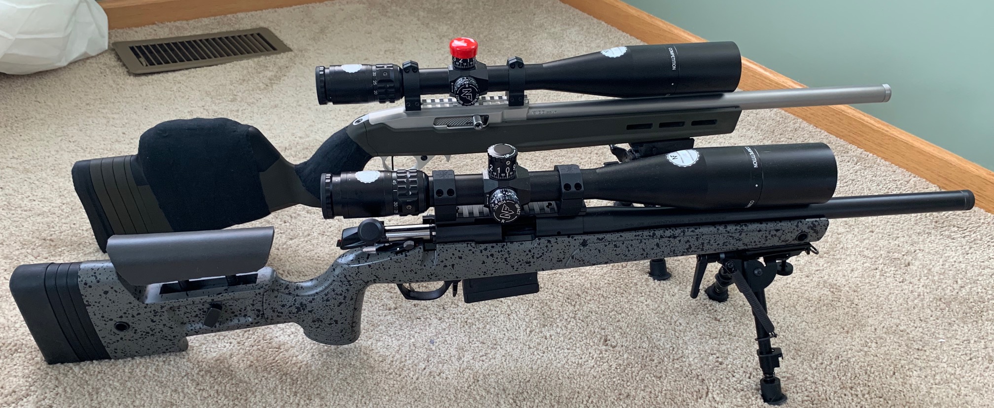

Kidd Supergrade wearing a Magpul 10/22 stock and my Bergara B-14R.
I've been drooling over the McMillan A-5 Tactical for about 18 months now and finally placed an order for one last week The down side is the factory said it has a 4-6 month leed time so I will be shooting the Bergara a lot more until the Mcmillan arrives. (Pix attached of what the stock/color scheme will be).
