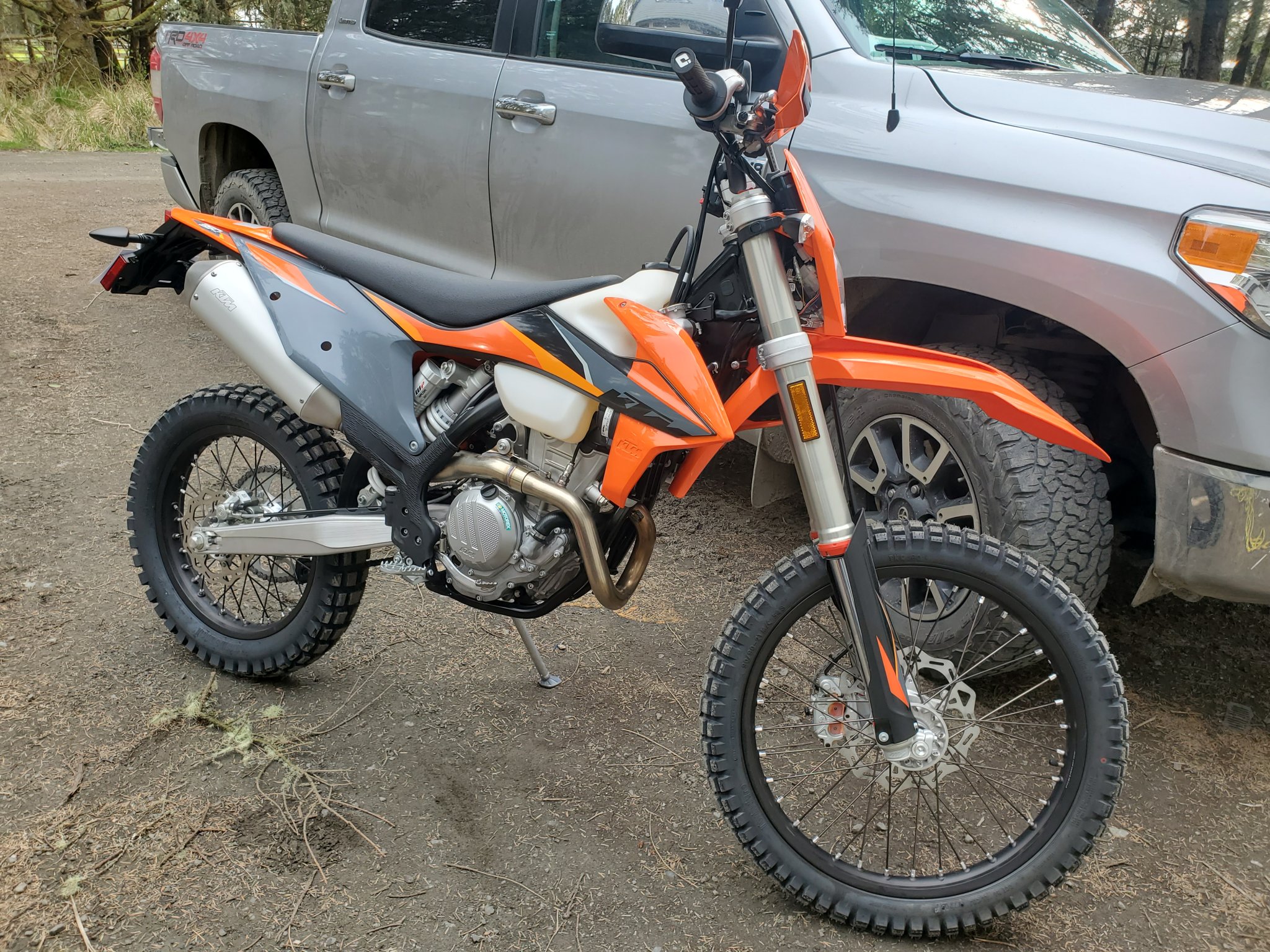

I just got a new KTM exc 350. I got home and the dealer is closed now.
So my problem is this thing start just fine, responds to the throttle while I'm in neutral. However as soon as I try to go it sputters and wants to die. In first gear I can get upto about 9 or 10mph where it dies. It starts right back up, but it will not accelerate at all.
Doesn't have a kick stand kill switch from what the salesmen said. Has a auto retractable kick stand instead.
I don't think it's bad gas. It could be, but it's a 2021. It starts easy and seems to be cutting power with the ECU for some reason or another.

That thing is sweet, street legal and all. Very cool by the way. Fuel injected, did you check the oil and water? I know its crazy but some of these bikes have low level sensors.

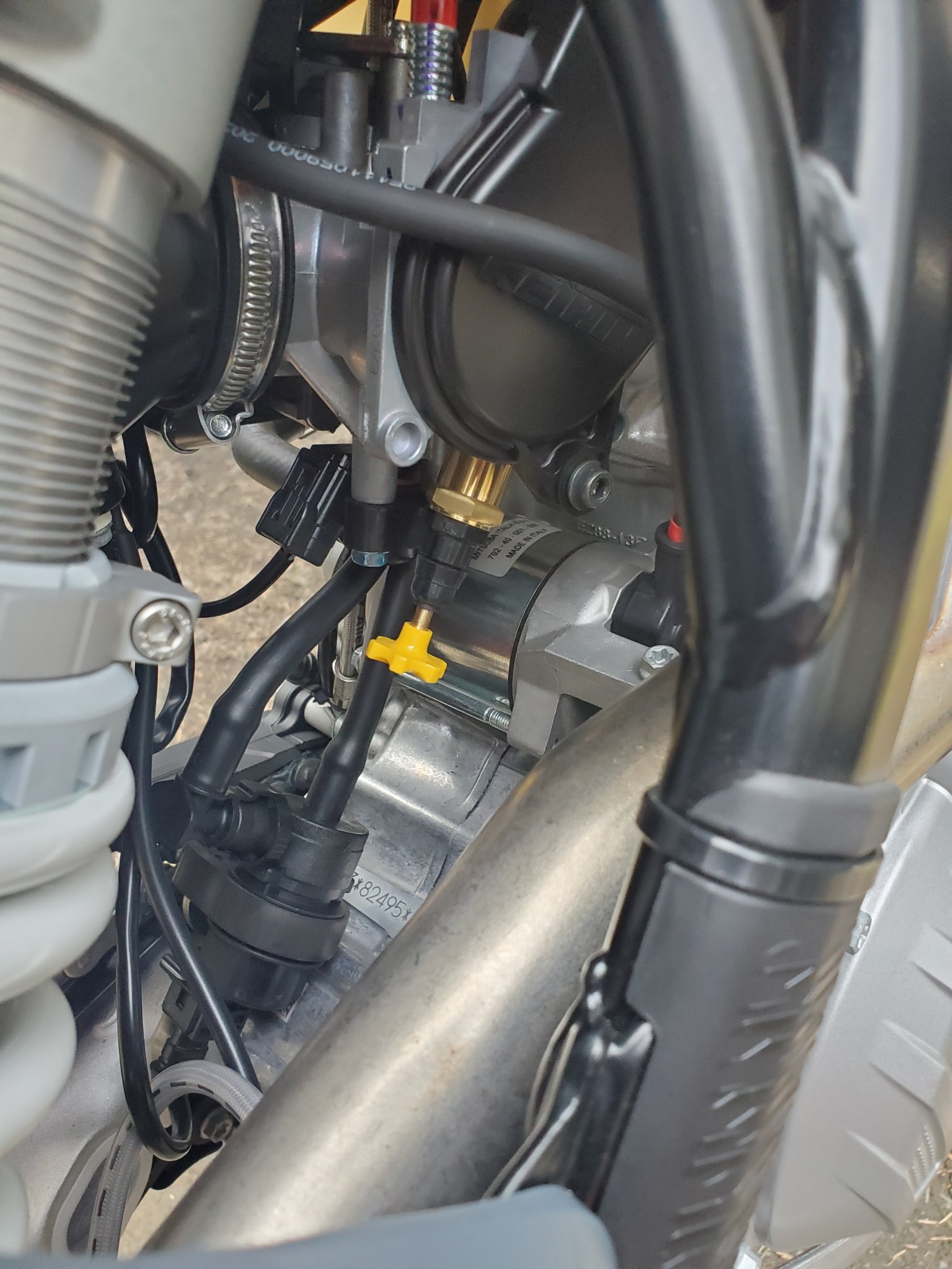

Thats a flame arrestor
Its supposed to be there. Check your oil and water and remover the air cleaner and check that something didnt get sucked into the intake
