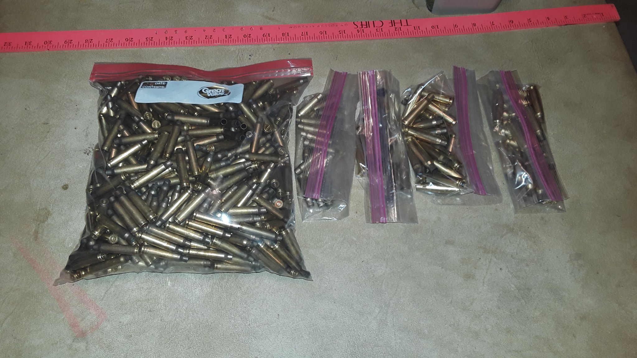

Yesterday's collected brass, sorted.
Over 500 223 and 1/3 to half will need swaged, the good stuff.
Lake city will need swaged and it is good brass.
Depending on what the range is selling for cheap 75% may need done.

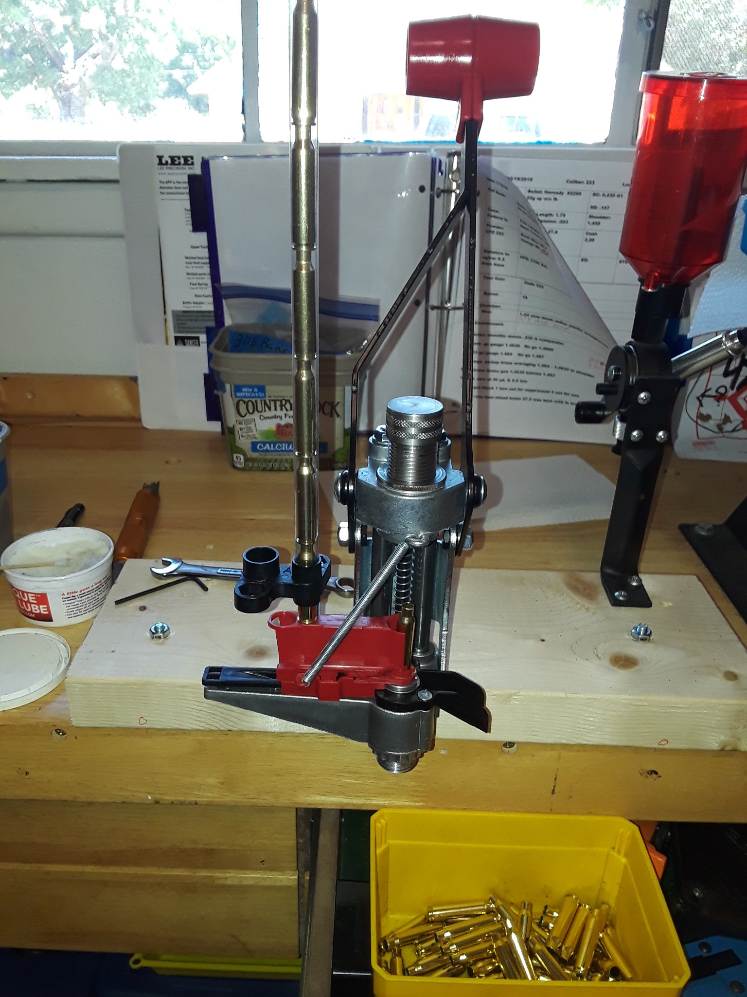

So I received my app press yesterday.
First impressions,
Small,
Plastic parts, (they disclosed that in description),
The Xpress shell holders do not match hight / thickness of standard shell holders, you will have to reset dies.
Instructions seem slightly vague will see after scrounging up mounting hardware and a base.

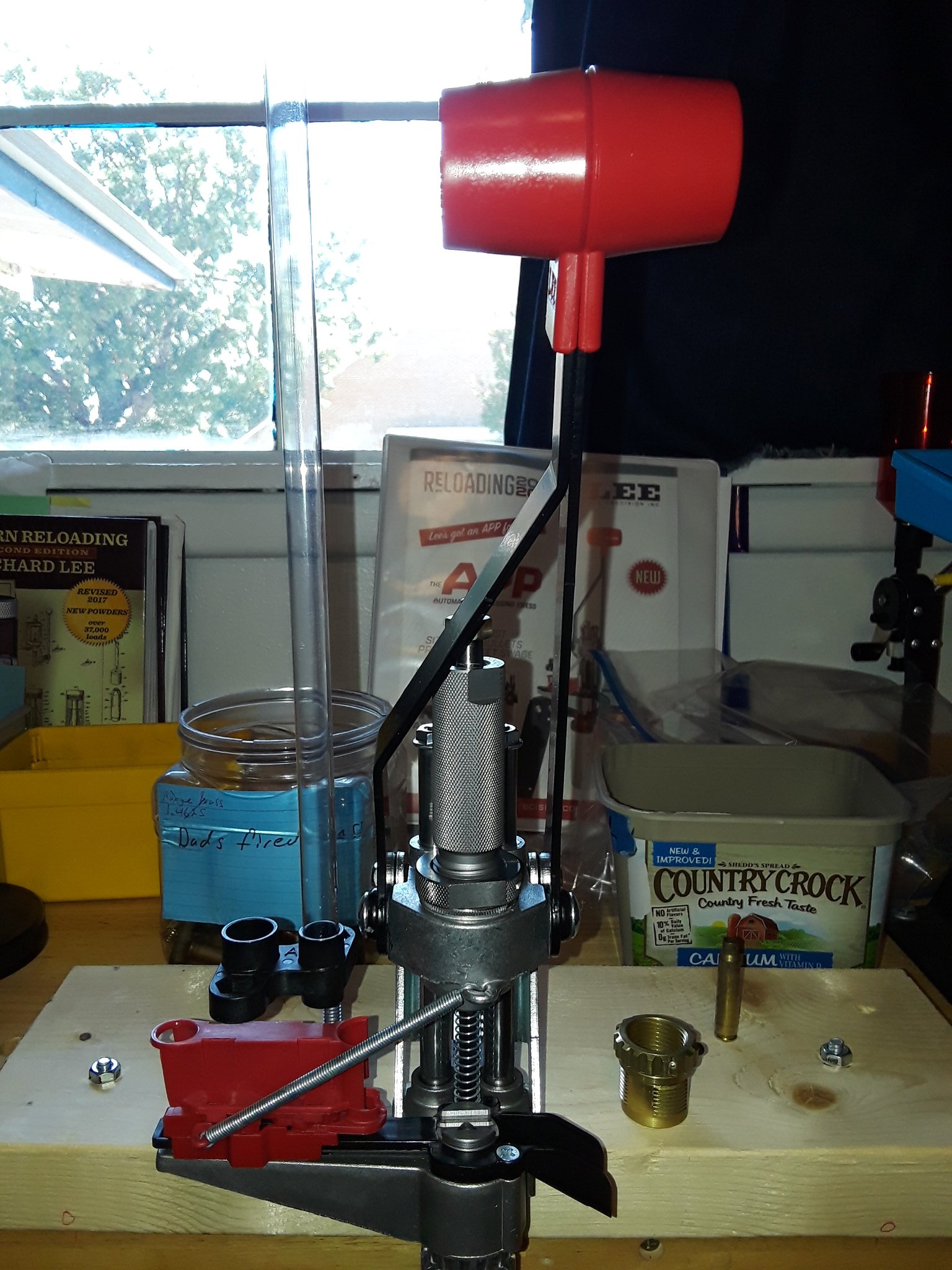

I have been using mine a couple months.
had planned to use it for decap with universal decap die. I put the four tube lee case feeder on. Pretty straight forward. I have had no problems with the x shell holder so it makes the process much quicker.
i also was able to resize 9mm cases on the press with no probems IF you lube them. I used Hornady one shot and according to instructions let it dry. 9mm cases sized easily with no hang ups.
I played around swaging some primer pockets. Worked as advertised. Use the press within limitations and you should be happy
I will try sizing 45acp cases and if it doesn’t work I’m still pretty pleased.

I didn't get a 4 place tube feeder.
Pop up a picture of your rig.
I did the APP on an inline fab mount. Added the 4 tube feeder and a mighty armory universal decap die.
quickly process a bunch of 223/5.56 decap and 2nd pass for swaging.
I tend to wet tumble so need to pop the primers unless you want to dry for hours.

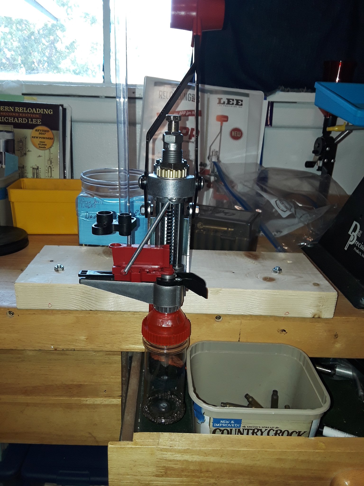

Well the saga hits a stop.
Hornady universal decapper won't clear the handle.
Looks like my lyman would work if the stem were not broken.
I set up a die I had to not touch shoulder and adjusted the expander down and after a lot of tweeking decap is functioning.
So far pita.
Reactions: 4thandbleek
So now it is running a sinclair mandrell like butter with the feeding hickup occasionally.
A little sizing wax in ever other neck runs smooth.
Decapper and mandrell is worth the price in time saved.

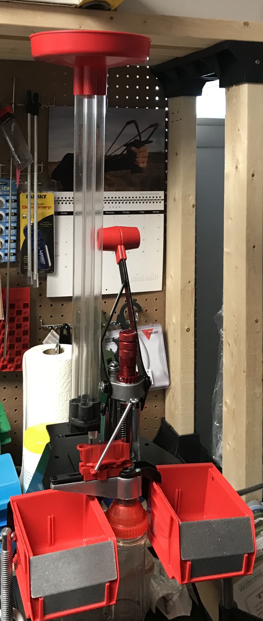

God forgive me! I ordered the APP erector set, the tube things, and the round widget. I'm going to use it just to de-capp all my brass. I'll be using an FW de-capping die, which likely costs more than the Lee APP. I too am mounting it on an Inline Fabrication Q/C plate. I just had to come up with a better solution to de-capping than placing each case on a shell holder, running a lever, and then taking it off. Talk about monotonous.

Even though I got a chuckle out of this press when I first seen it on here, I started to investigate it a little more and actually ordered one. Also ordered a dillon case feeder for it and mounted it to one of my benches with a inline fab mount and put a piece of rigid conduit in a flange and mounted that to the bench for the case feeder.. This setup is for now a decapping setup exclusively. All worked pretty well for a short time, now it seems to have an issue with fully returning to center over the shell holder. Kind of annoying, I emailed Lee and they are sending me out some replacement parts, hopefully this fixes the problem. Lee's customer service seems to be top notch, this is only my second Lee product..
