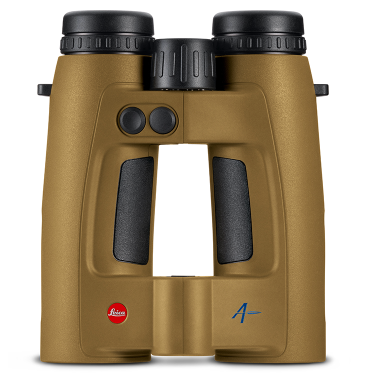

Leica has introduced the new Geovid Pro 10x42 AB+ with Applied Ballistics Elite.
1) Applied Ballistics Elite Engine onboard.
2) Shot Probability Analysis
3) 3000 yard/meter ranging.
4) AB Ecosystem connectivity (Garmin Watches, Kestrels etc etc)
5) Temp, Pressure, Humidity, DOF etc onboard.

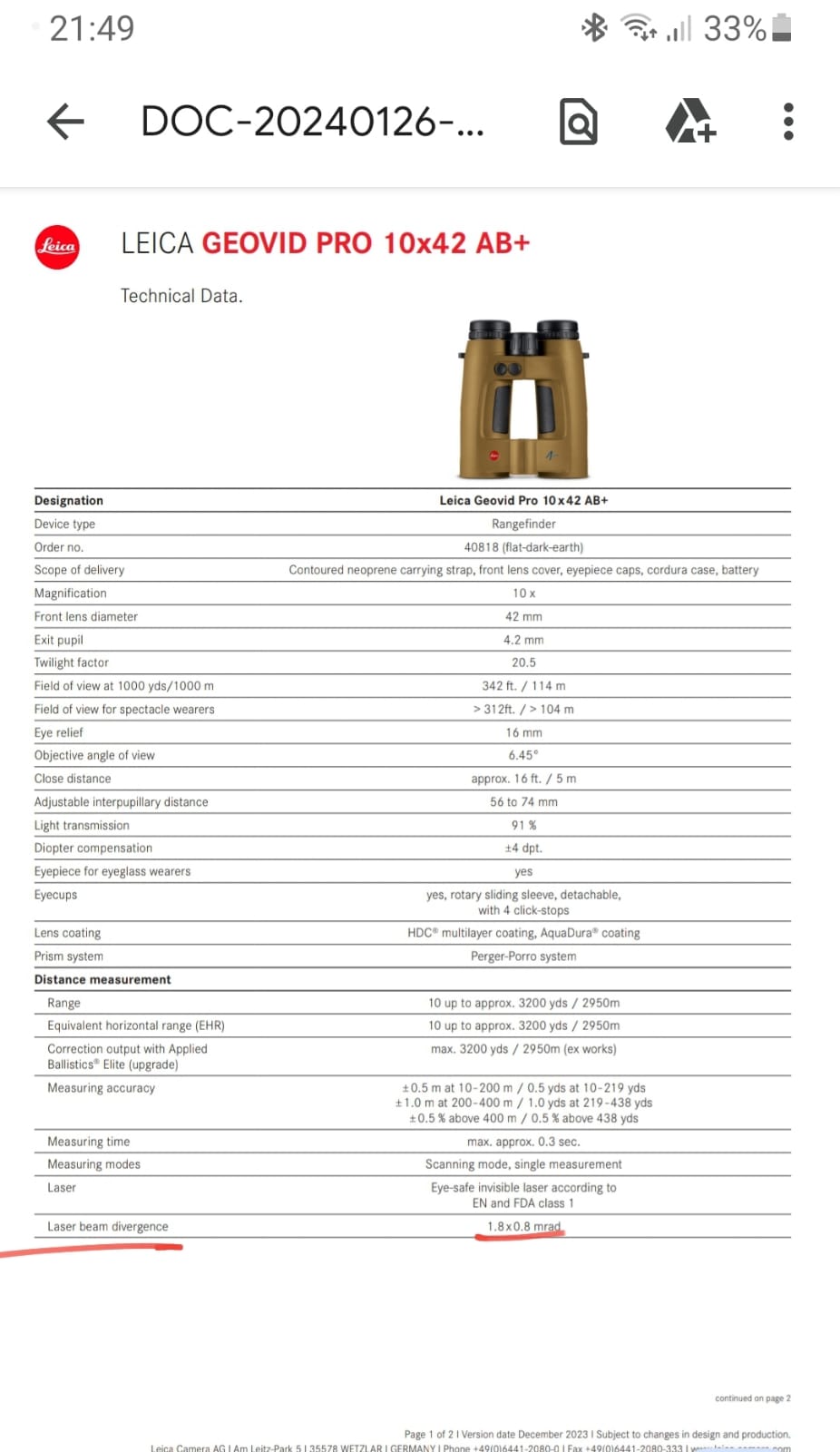

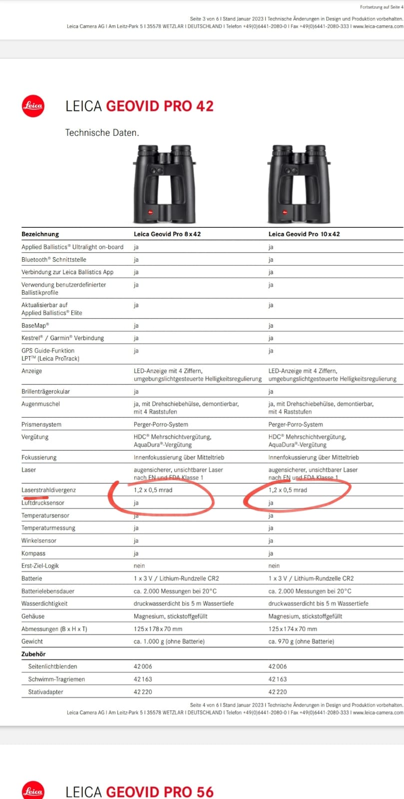

I would like information from a reliable source regarding the laser beam divergence size of this Leica Geovid Pro AB+
I found the following:
- I now use a Leica Rangemaster 2800.com which has a 0.5x2.5 mil laser beam divergence
- A friend of mine, now uses a Leica Geovid Pro 10x42 (the black one). On the official Leica website it is mentioned that it has a laser beam divergence of 1.2x0.5 mrad. (both for the 8x42 and 10x42 versions), but in the product manual the information is different and it is mentioned that it has a laser beam divergence of 0.8x1.8 mil (vertical 0,8mil and horizontal 1,8mil)
- Also, according to the Leica website, the Leica Geovid Pro AB+ has a laser beam divergence of 1.8x0.8mil
So:
2800.com 0,5x2,5 = 1.25 mrad
Geovid Pro 1.2x0,5 = 0,6 mrad or 0,8x1.8 = 1,44 mrad (it is not clear which value is the correct one)
Geovid Pro AB+ 1.8x0.8 = 1.44 mrad
It is absolutely surprising to see that exactly the top version Geovid Pro AB+ is listed with the largest laser beam divergence, even greater than the one from Rangemaster 2800.com.
It doesn't even make sense to compare the 1.5x0.06 mrad (0.09 mrad) from Sig 10K ABS
Since I'm considering putting my money down for a Geovid Pro Ab+, please tell me if what I wrote above is correct, or if not, which of the contradictory printed official data (attached below) is wrong?
Thank you in advance

The correct number on the pro 32's is 1.2x.5 mil. I questioned Hamilton about this back when I reviewed the Pro 32's.
Can Hamilton confirm the beam divergence?
From Hamilton (2 weeks ago but my e-mail has been a bit swirly since a recent update and the e-mail got buried and never showed up as unread):
"Pro 42s and Pro AB+ have a larger 1.8x.8MIL beam divergence. They’re using a new emitter and this was part of the laser gurus’ design for best performance overall, not just target specificity."
So, the pro 42's and Pro AB+ are not using the same emitter as the pro 32 is and the beam divergence is a bit larger on these newer models.
