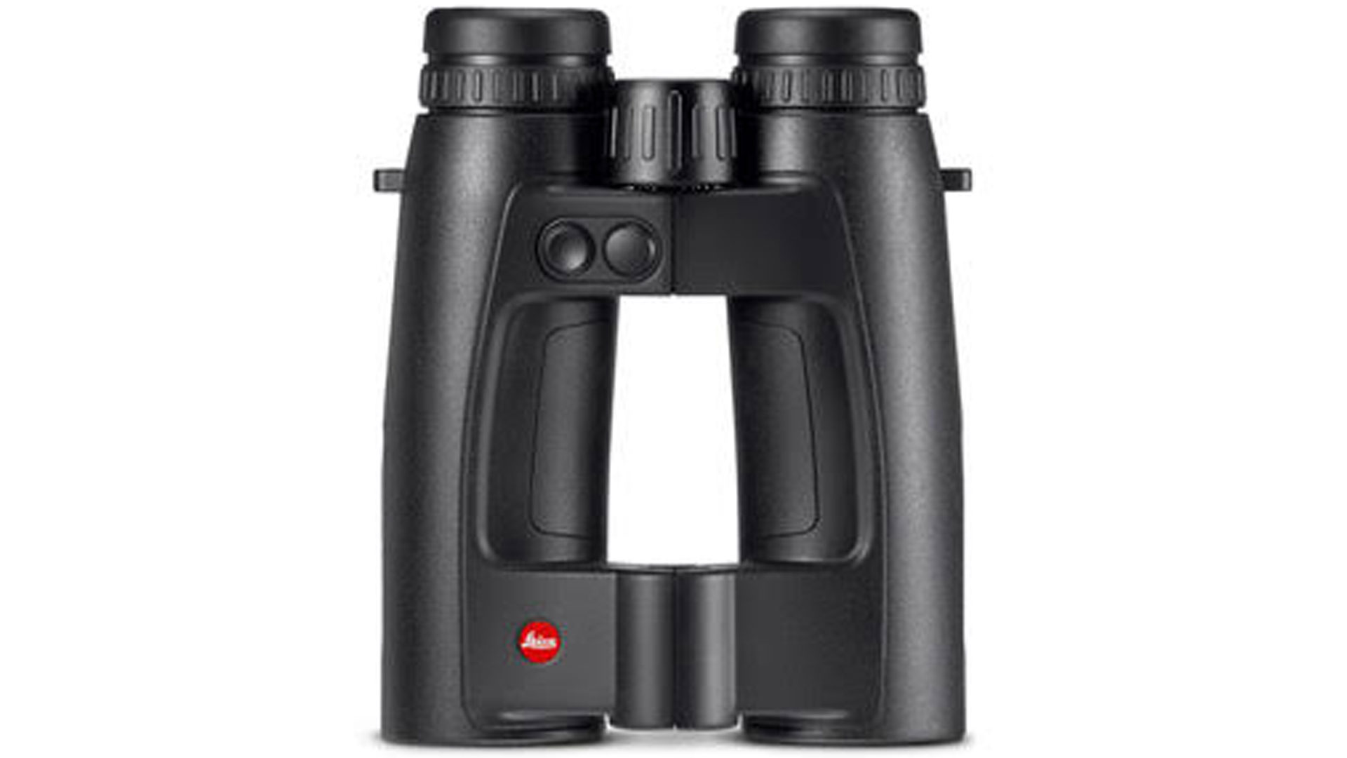

New Leica Geovid PRO 42

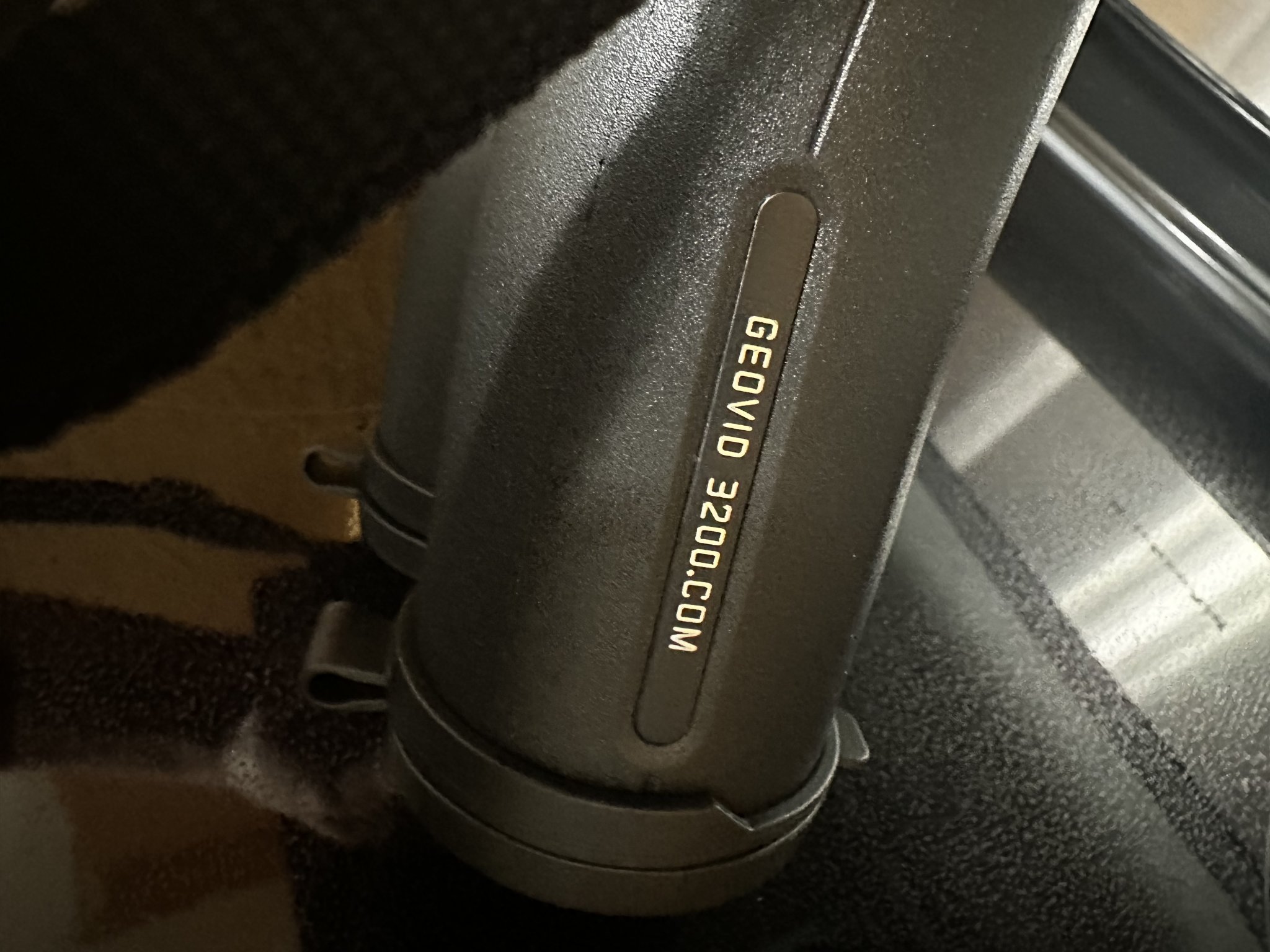

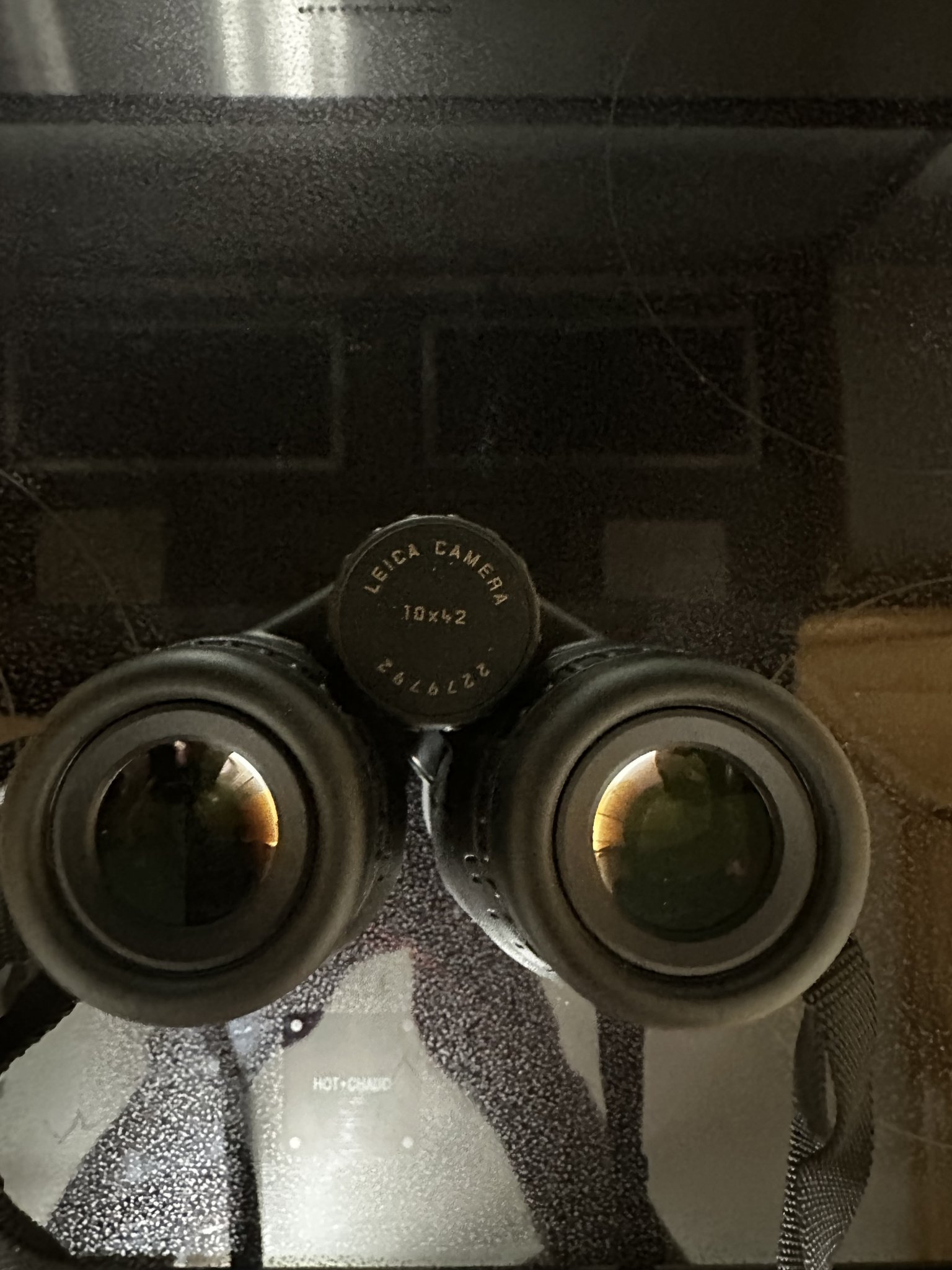

So I have the Leica Geovid 10x42 just not the pro version, does anyone know the difference between the pro and non pro verion? All I could find was the pro version has the GPS Leica protrack. TIA
You likely have the 10x42 3200.coms.
PRO 10x32’s came out last year, PRO 10x42’s come out this April.
The PRO’s have the full Applied Ballistics and weather sensors on board, that’s the biggest difference. So no need to connect to a Kestrel for environmentals, whatever you can range you get dope for elevation and wind. Also a much easier app and menu, better connectivity via Bluetooth to phones and kestrel than the 3200’s which kind of sucked for Bluetooth.
3200’s seem to have a better laser for ranging, with smaller beam divergence, at least better than the 10x32’s. Haven’t seen on the 10x42’s what the laser specs are.
You are correct, guess i’ll have to buy the new Pro’s. Thanks for your help
