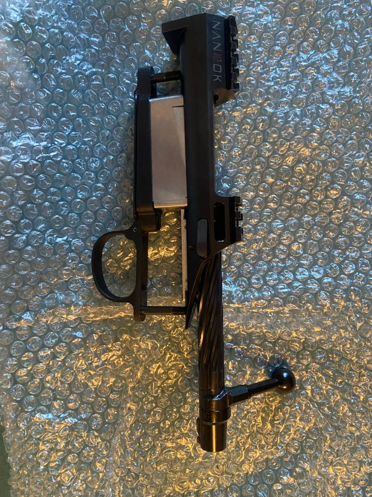

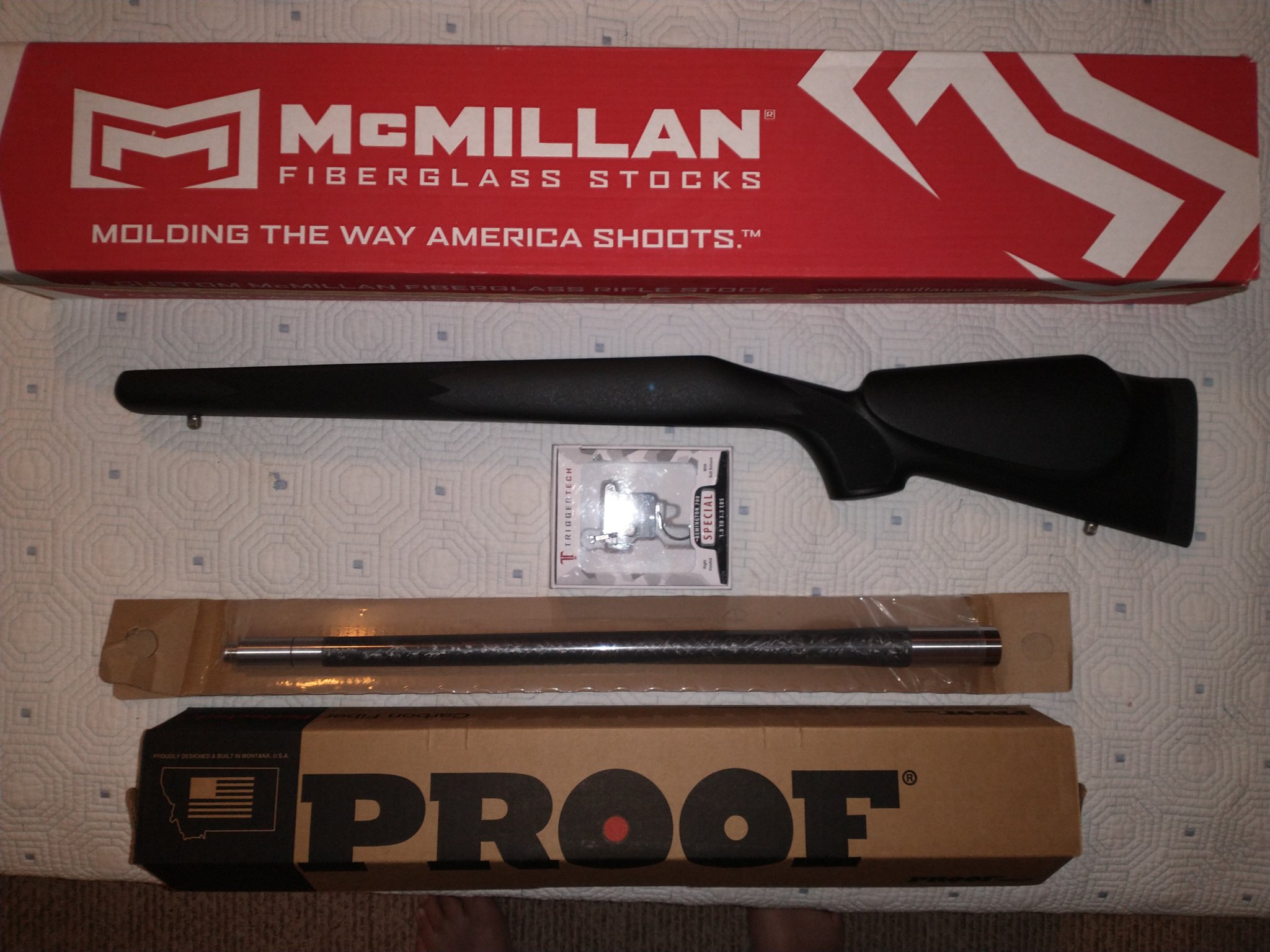

All the pieces are in-rout . All in my hands by first of week next week . I likely wont be able to thread & chamber it till January but that aint that far away.
Im tickled like a youngin on December 25
Gonna be a 7-08Ackley
Nanook action
Proof sendero light 8 twist 20"
Mcmillan Remington Hunter edge fill
Alloy floor plate w/ wyatts extended box
TT special single curved

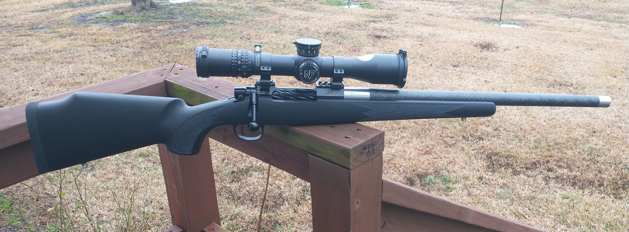

Getting closer.

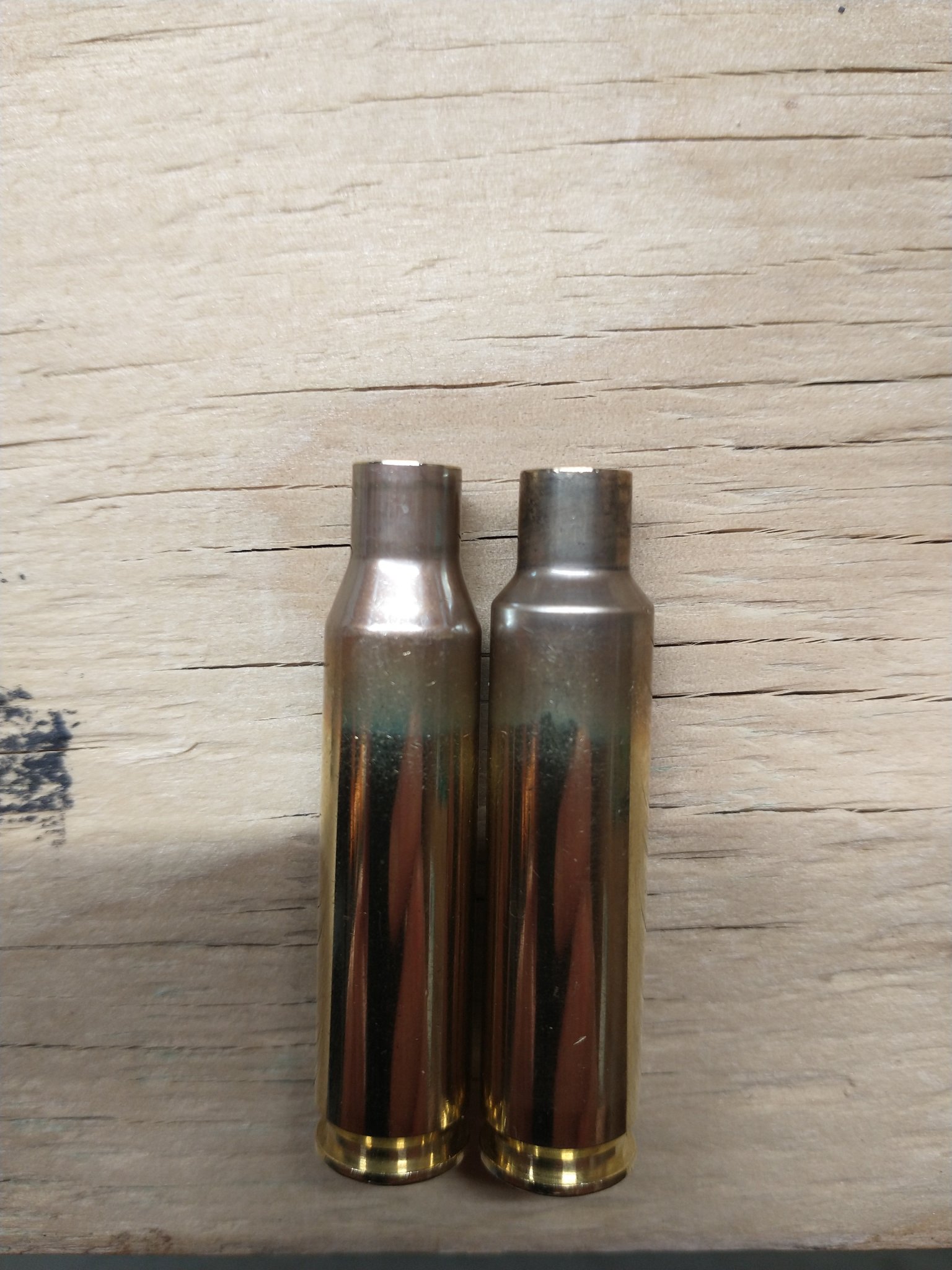

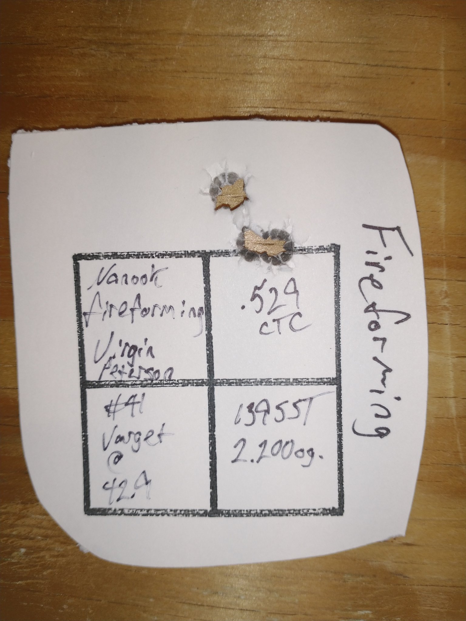

I took peterson 260small pocket brass & ran it acrost a K&M .284 expander that I polished down to give .282 neck ID .
Checked trim length then chamfered & debured.
gonna load a nominal load of 4350 w/139sst in the lands ( to keep the case pushed against the bolt face )
and send em.

I decided to send action and barrel to LRI for marriage/chambering/muzzle thread.
Did the order on the LRI website and mailed barrel first of week.
I guess maybe they are closed this week or extremely busy as My local FFL nor I have been able to make contact with them via email or phone.
Maybe by next week we can get their info so My local FFL can send receiver out to them ( and Yes I know I could just take ownership of the action and ship it myself without a receiving FFL number but our local UPS or USPS wont handle it for me and I refuse to use our local fedex ).
Brass is prepped and ready though 😁
You should get an email with an order status update once it’s received into their system. Try to get Kalli on the phone if you want more info (option 7 on their phone system). In my experience they do not respond to email.

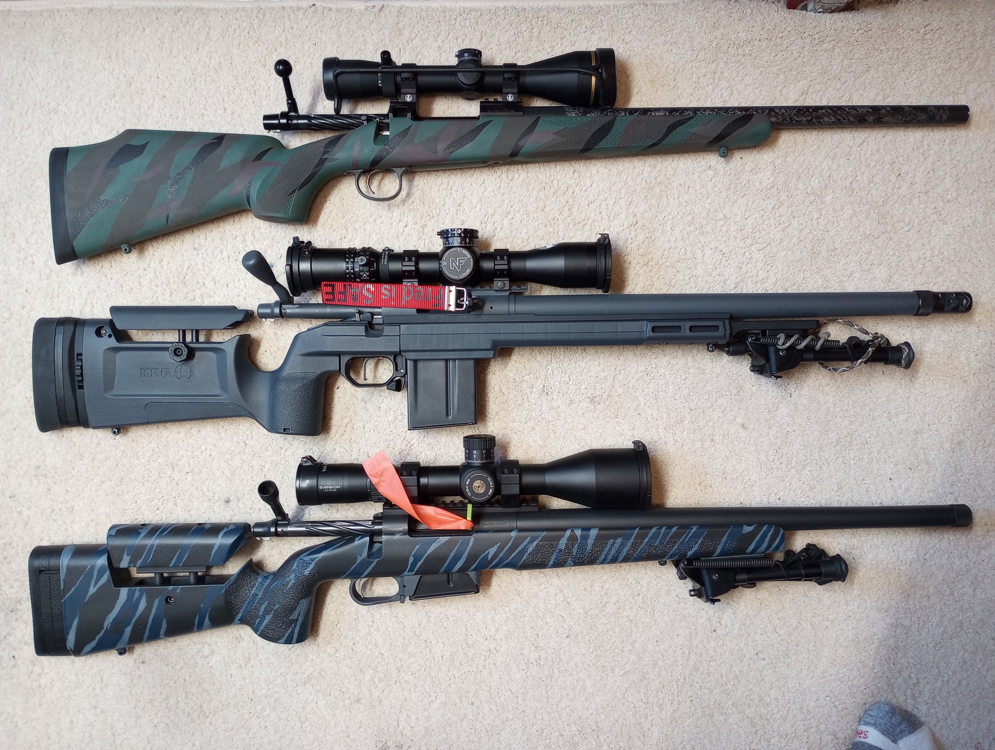

I have a lightweight (5.9, wanted to be closet to 5...) 22" 7-08AI on a Model 7, trued and barreled by LRI. Have not shot it yet :/
My reasoning for the 7-08AI was that to my eye, it would provide the highest performance in a standard bolt face short action I could get. Also, fireformimg from regular 7-08 is a plus

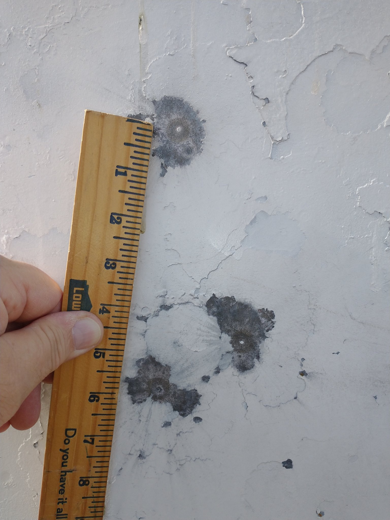

Started frieforming . Averages .6 grouping with fireforming load
139sst , varget , #41 at bout 2760fps

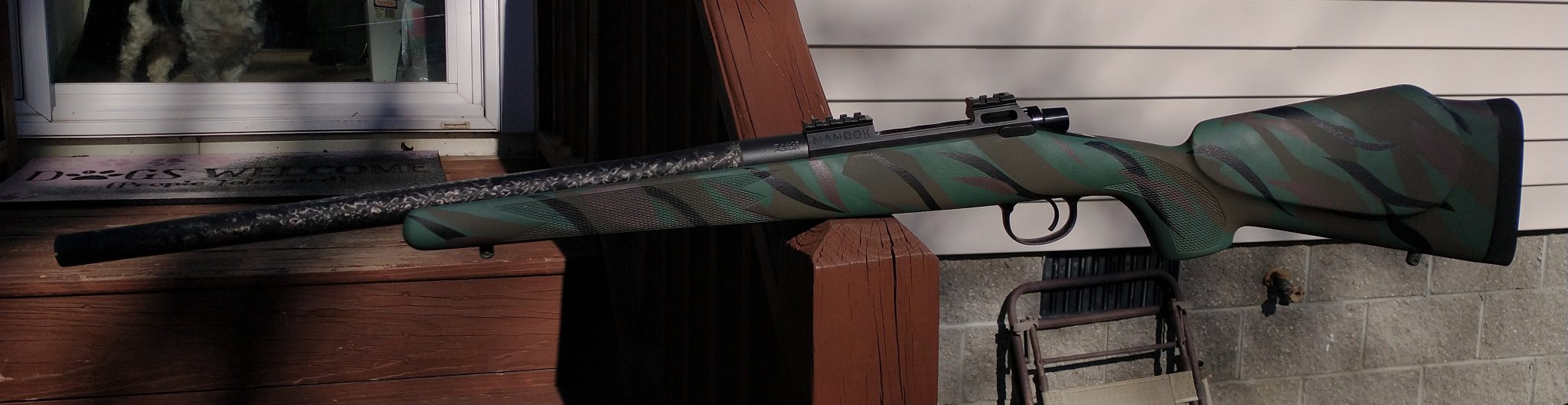

Try and remember to get pic of rifle when sun is out
100 & 700 during fireforming
Reactions: mpwolf

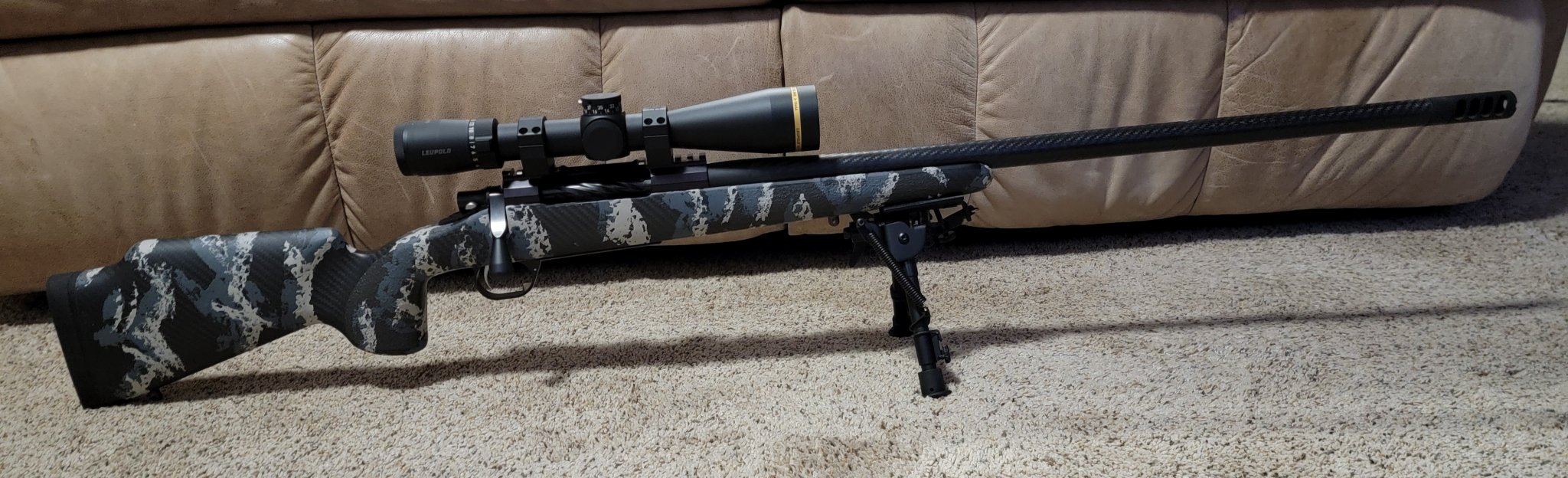

I really like the 139gr SST......I've found it to be a deer smasher over the last couple seasons. Probably not exactly what you're looking for in a developed load, but that fire-forming load sure looks like it would work in a pinch!
Anxious to see this rig in a daylight pic.
I suck at taking pictures.
I like everything so far except the bolt handle on the Nanook sits proud/high and I have to run the NF higher than I like..
I think a scope with a smaller ocular housing or a modification to the bolt handle are gonna be in short order..

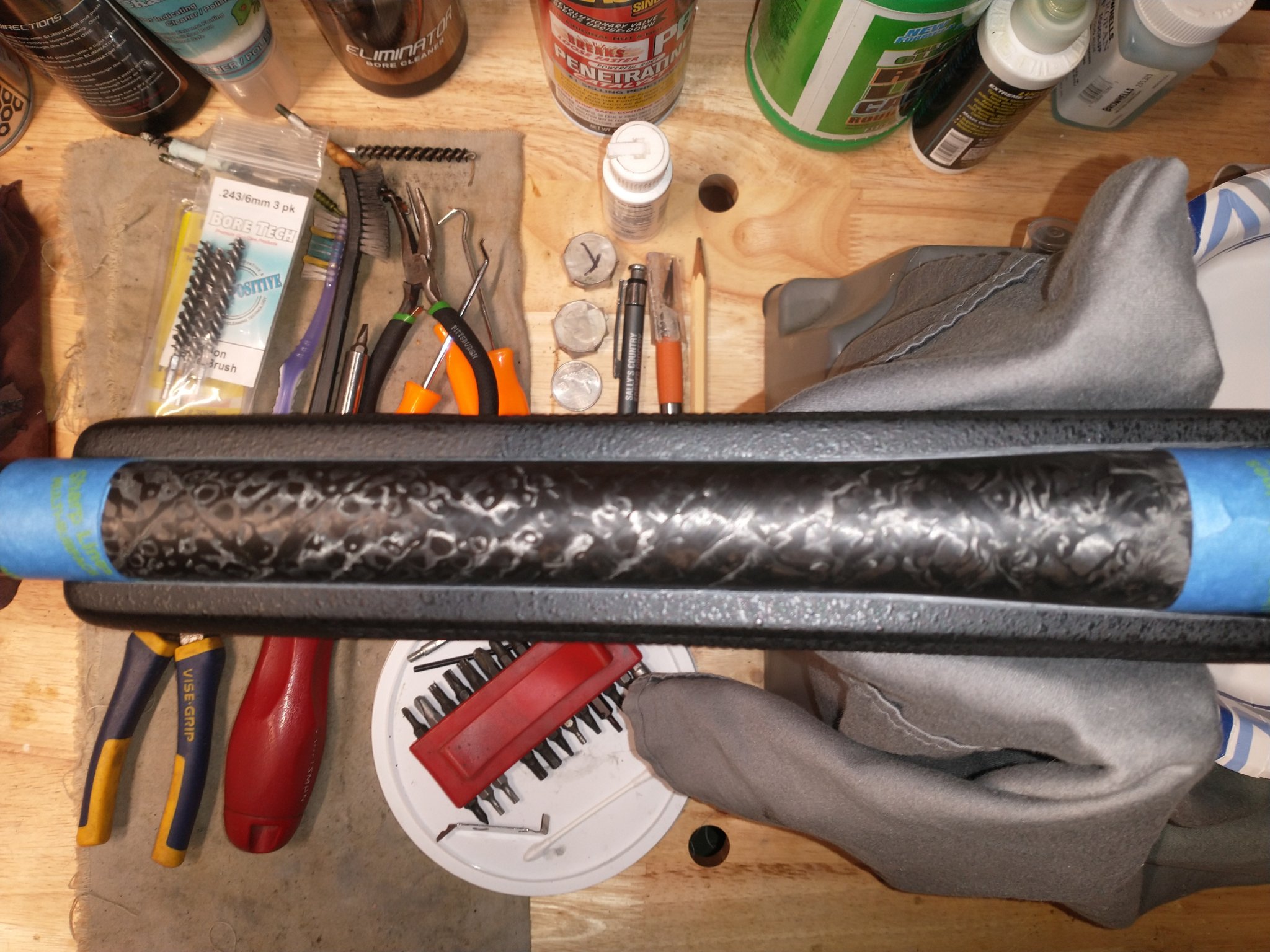

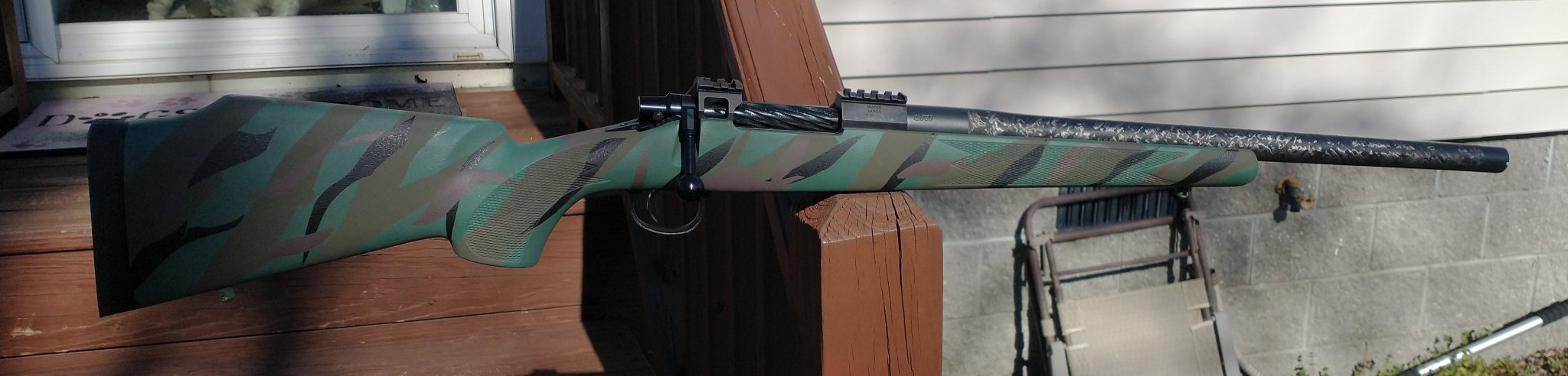

Gonna paint the stock woodland green, woodland brown & OD.
Gonna paint the shiny bits charcoal.
While my fat ass cant hold it still enough to get a ragged hole ...... the rifle is easily a sub .5 ( 3shot group ) on the three bullets ( 139sst, 150partition & 150eldx ) I've played with. It does sub .75 ( 3shot group ) on a fireform load w/ 139sst & varget !
RL15 & Varget are working nicely! 4350 runs out of room in the case before optimum velocity ( it is a 20inch barrel after all )
