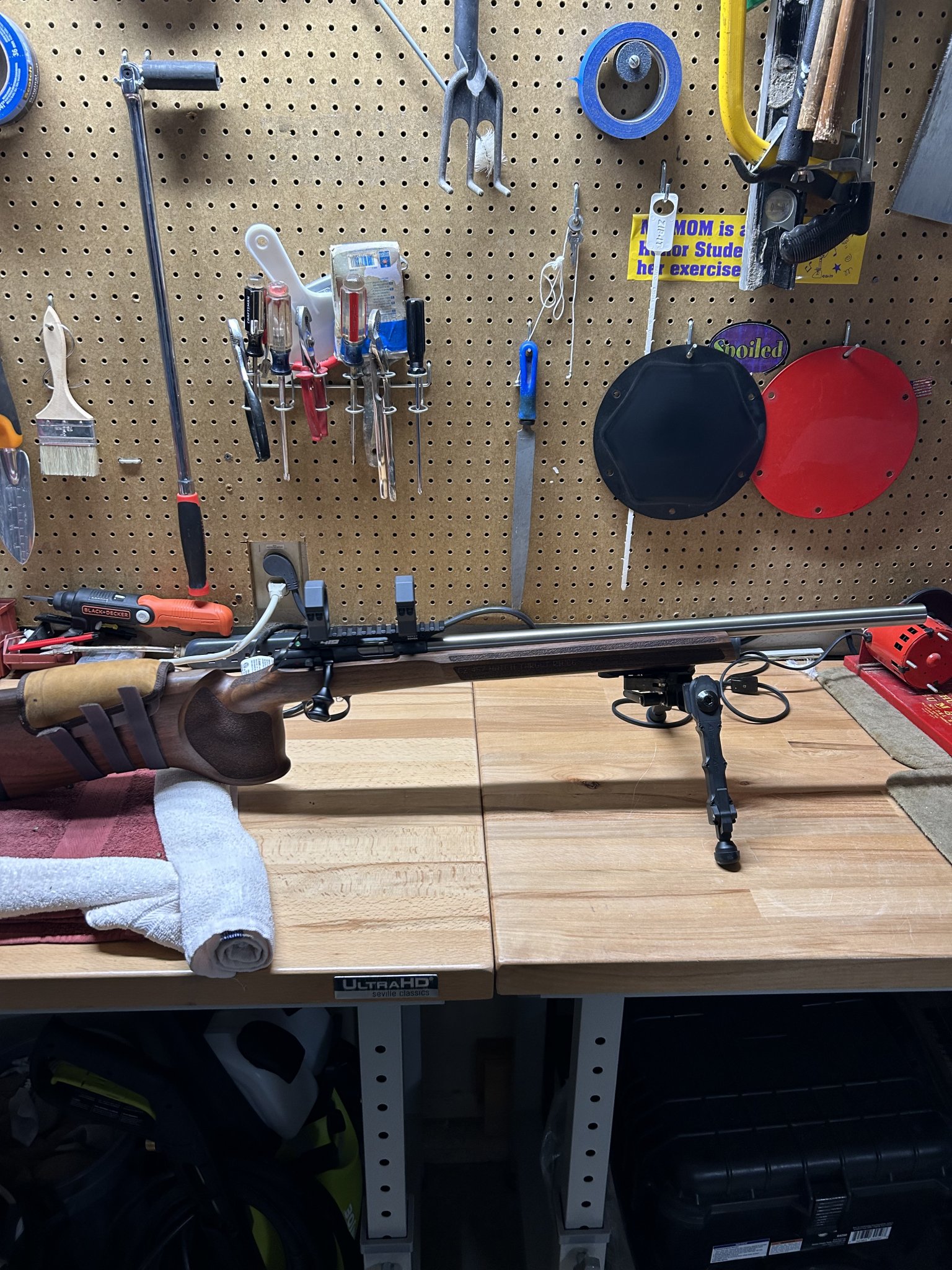

Here is the CZ 457 MTR with need Lilja 22in .900 straight contour looks like. If fit in the stock with no clearance issues. Other mods are AREA 419 30MOA rail and bolt knob new Timney trigger set at 1lb.
Now if the dam wind will quit blowing I can do some testing.
Got a chance to shooter her a bit this morning before the wind came up. Shot 2 sub .3/4 moa groups at 50 yards with Lapua Long Rang and Center X before the wind came up. When I got home had a package from Pet's Pillars waiting. It was a new firing pin. I installed it this evening without issue. So hope no wind in the morning so I can test some ammo.
Here is a list of the mods I have made to the CZ 457 MTR
1 Lilja 20 in barrel
2 Timney Trigger
3 Area 419 30 MOA rail and blot knob
4 Pete's Pillar firing pin.
5 Tract Torric 4.5-30X56 MIL Scope
5 Looking at different chassis options to put the action into.

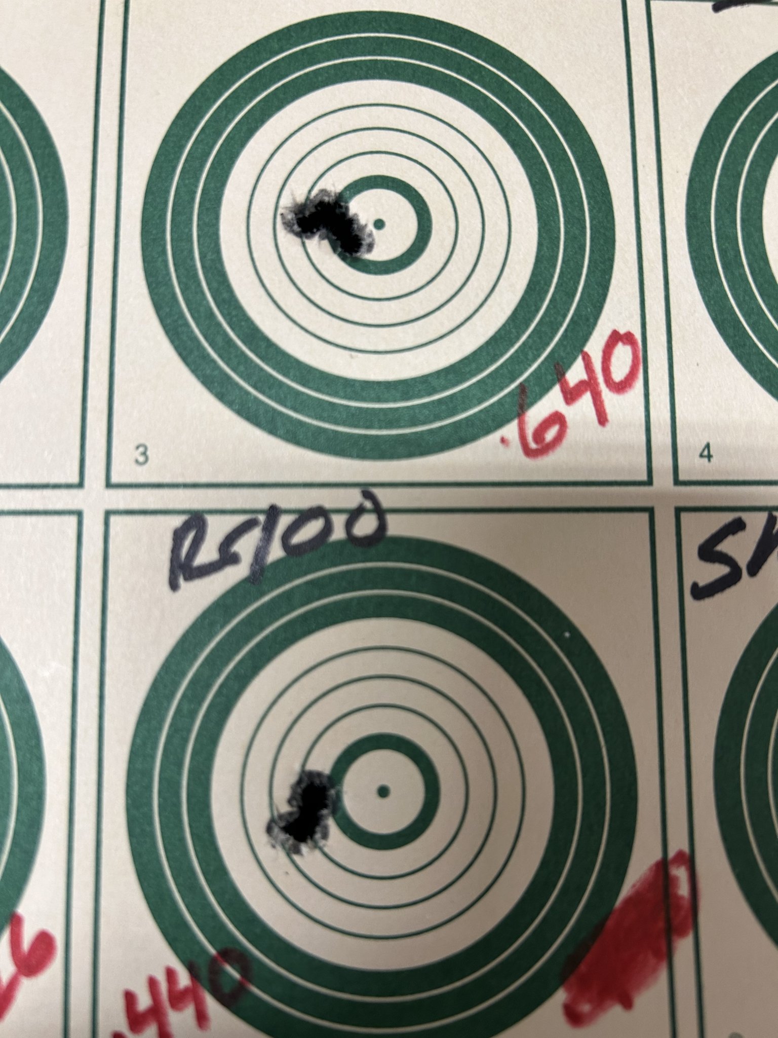

Got out to the range and did some ammo testing today. All ammo tested at 50 yards. I shot 5-5 shot groups.
Lapua Long Range Best group .669
Lapua Center X Best group .726
RWS 100 Best group .440
RWS Rifle Match best group .998
RWs Target Rifle best group 1.021
Eley Team Best group .491
Have Eley Tenex and Eley Match Rifle shipped won't have until the 26th.
Here are the 2 best groups.
