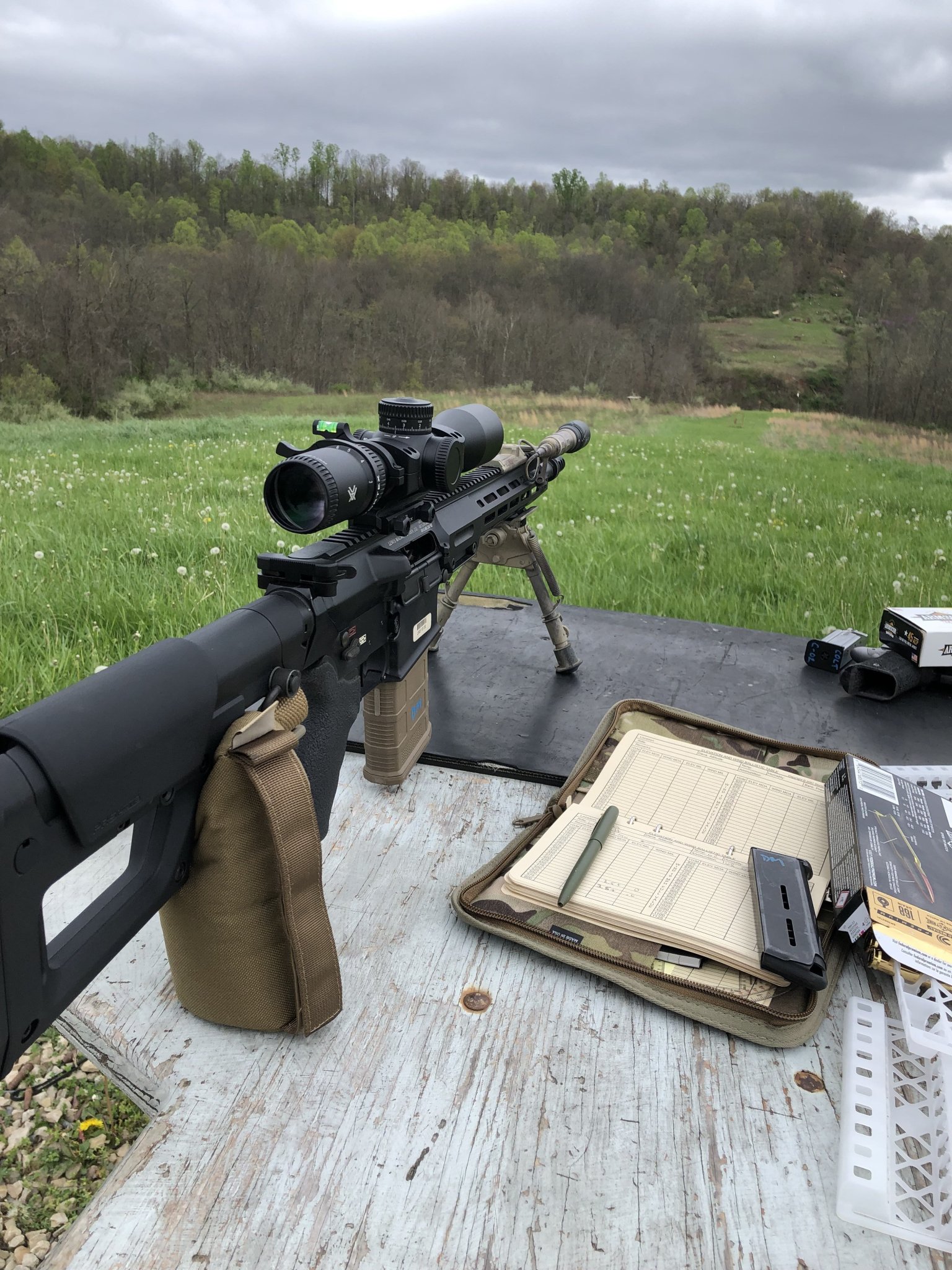

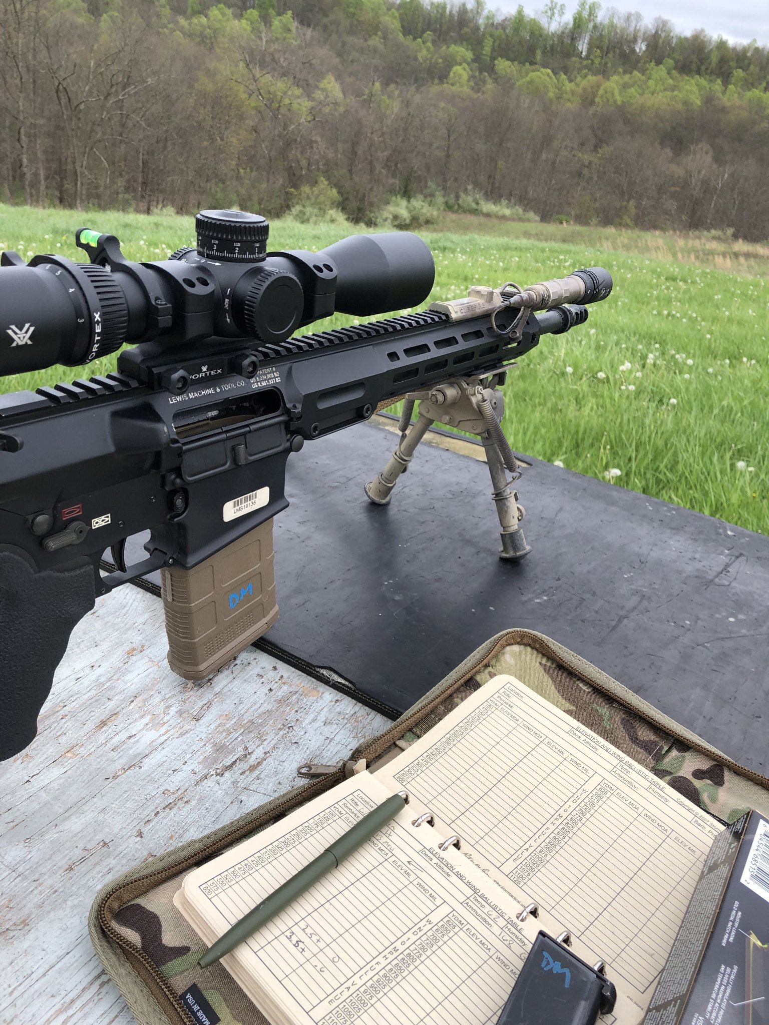

Hey all,
First of all, brand new here, looking for a little bit of advice on my first precision weapon. Im looking to create a dope card. I understand a dope card is Data on PREVIOUS engagement but allas I do not have that and im hoping I can make one ahead of my first shoot when I get the gun in a few days. I bought bulk 165 grain federal gold medal match and im rocking a 16 inch barrel on this Defender H. I was hoping someone could plug this into one of their apps and tell me exactly what my dope would look like out to 1k. Also, if you have any recommendations on apps now that Strelok is gone id appreciate it, the hornady app doesn't have my ammo and I've found others to be very cumbersome. Thanks again!

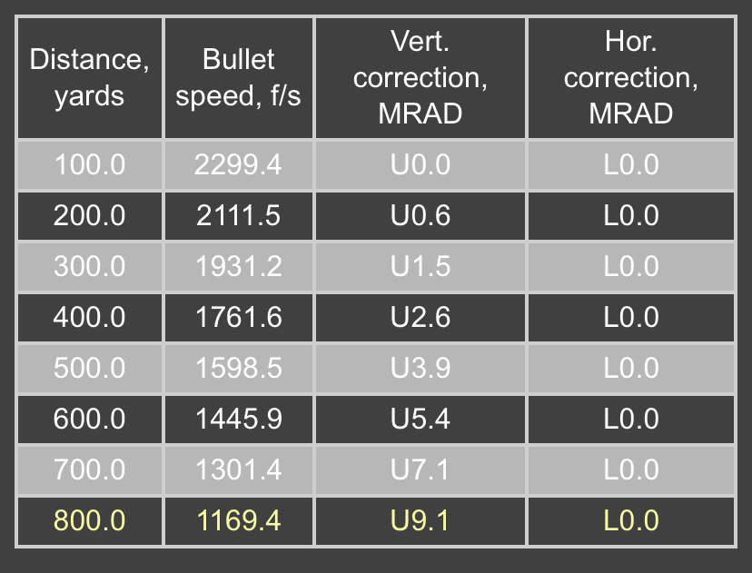

Here. Hope this helps.
72degrees
65% humidity
DA 4405
168 SMK @ 2500 fps
100yd zero
Scope height 2.5” above bore
It’s only as good as the generic inputs

View attachment 8436099View attachment 8436100
