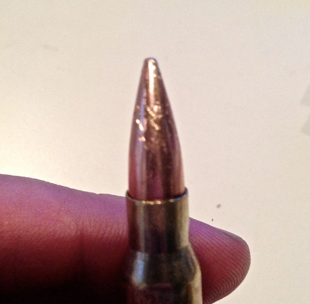

Hello all,
Been lurking on the hide for a while now and just picked up a new LMT MWS 16" CL. Love the fit and finish on it, the look and it feels awesome however I seem to be having a problem with ejection.
Basically the chamber is so tight when I put a round in battery I have to yank the charging handle as hard as I can to get the round out of the chamber. Took it to the range just to check and see if it simply needed some break in and the second round jammed so badly I had to get a cleaning rod to ram the spent casing out of the chamber. T
Took it home cleaned and lubricated it my normal way and just started manually feeding and ejecting rounds trying to loosed it up. Didn't seem to help and it was scratching up my bullets and brass pretty badly. Got one stuck really good and when I yanked on the charging handle to pull i tout it actually pulled the cartridge apart (thankfully I got it vacuumed up before the woman saw gun powered all over her couch:)). Attached is crappy cell phone pic of what it's doing to my bullets.
Anyone have an ideas? I figured I'd ask here since I know there are a ton of other LMT owners before I call them. Really want to love the rifle. scarred bullet.jpg
Some of those scratches are from manually extracting the rounds and them dragging across the barrel extension.

PPU 145gr FMJ Win 308. Not great ammo but I and some sitting around and figured it was good enough for a function check. I measured the round that came apart and its .306 at it's thickest so think the ammo is in spec. I'm happy to pick something else up to try but I feel like the rifle should be able to cycle pretty much anything even if the accuracy suffers.

Whats more concerning about yours is if the bullet damage is from jamming into the lands because of some sort of short chamber situation. Is that damage from hanging up on feed or does it seem that the bullets are jamming into the lands?
You pulled a bullet apart on ejection. I suspect you are jamming and probably shouldn't be with a 145 grain bullet. IIRC correctly another poster had an LMT that was short chambered and he got taken care of nicely again if I remember right his chrome lined barrel became a stainless steel one on correction. Your cloud may have a silver lining if there is a defect.
If the bullet is jamming into the lands and it looks like it may be. The first thing I would do is check the cartridge overall length. Should be 2.800. Then get a case length gauge and check the cartridge case in it for proper case dimensions.
