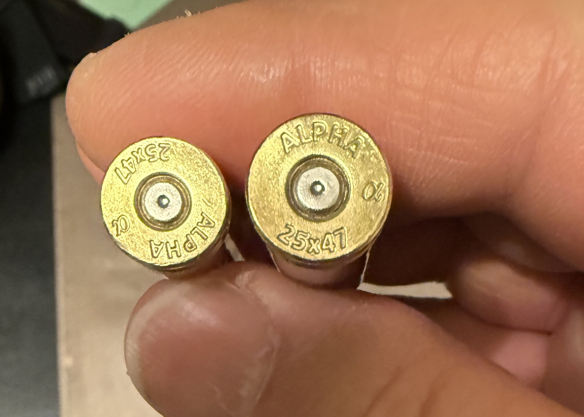

Anyone had ignition issues with this lot of CCI 450’s? I had 3 rounds not go off during a match a few weeks back. Two of the three rounds went off on the second attempt. They are seated .005” deep in Alpha Brass. Never had an issue with this rifle until this new lot of primers. I’m going to try my spare bolt next time I go out to the range.

Seems to me, being .005" below flush is a good place to be. Of course, it depends on how deep you pockets are??? How did the primers look in term of how the firing pin struck them?
Yeah, check with that spare bolt is a good idea. It might be a firing pin issue is you're looking at light strikes on the primers???

These were two of the failure to fire rounds, primer strikes look good. I sent the picture to Tate/Impact as well and he agreed.
It's really hard to tell in those pictures as they kinda look a little light, but not enough where I wouldn't think it'd keep them from igniting.
The other place I'd take a close look at is the case headspace; a short case headspace can cause this issue too???

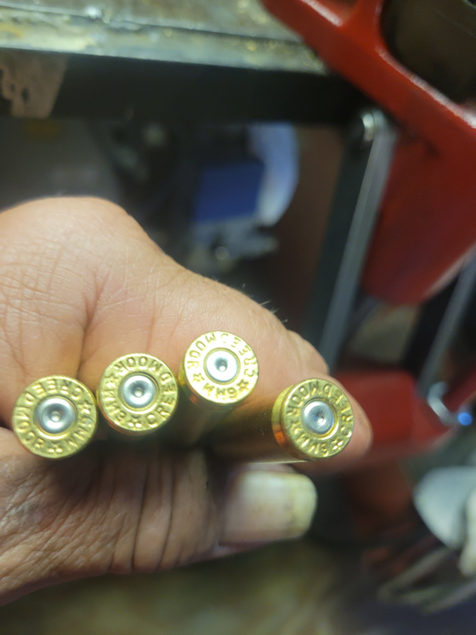

View attachment 8649483BR 4's this weekend. They didn't fire either.
Are these virgin brass?
I suspect the case's headspace are too short. Such a thing makes it where the case is pushed forward enough where the firing pin won't deliver enough force to the anvil inside the primer to cause it to ignite. The primer surface still gets indented, but it's being cushioned by the case moving forward by quite a bit. It's similar to a primer seated too far from the bottom of the pocket.
Yes, they were 1st timers , shot 246 others with no problems ?
Since virgin brass is really not all that uniform in their dimensions (why typically fire forming is done before load development), that pretty much explains the problem for me. That being . . . those particular cases of your lot were too short. :rolleyes:
If they haven't been fired yet, you can measure them (their headspace) and see how they compare to those that have been fired. And to get them fired, you might need to simply use a more sensitive primer. . . like the CCI-400's well seated to the bottom of the pockets??? :giggle:

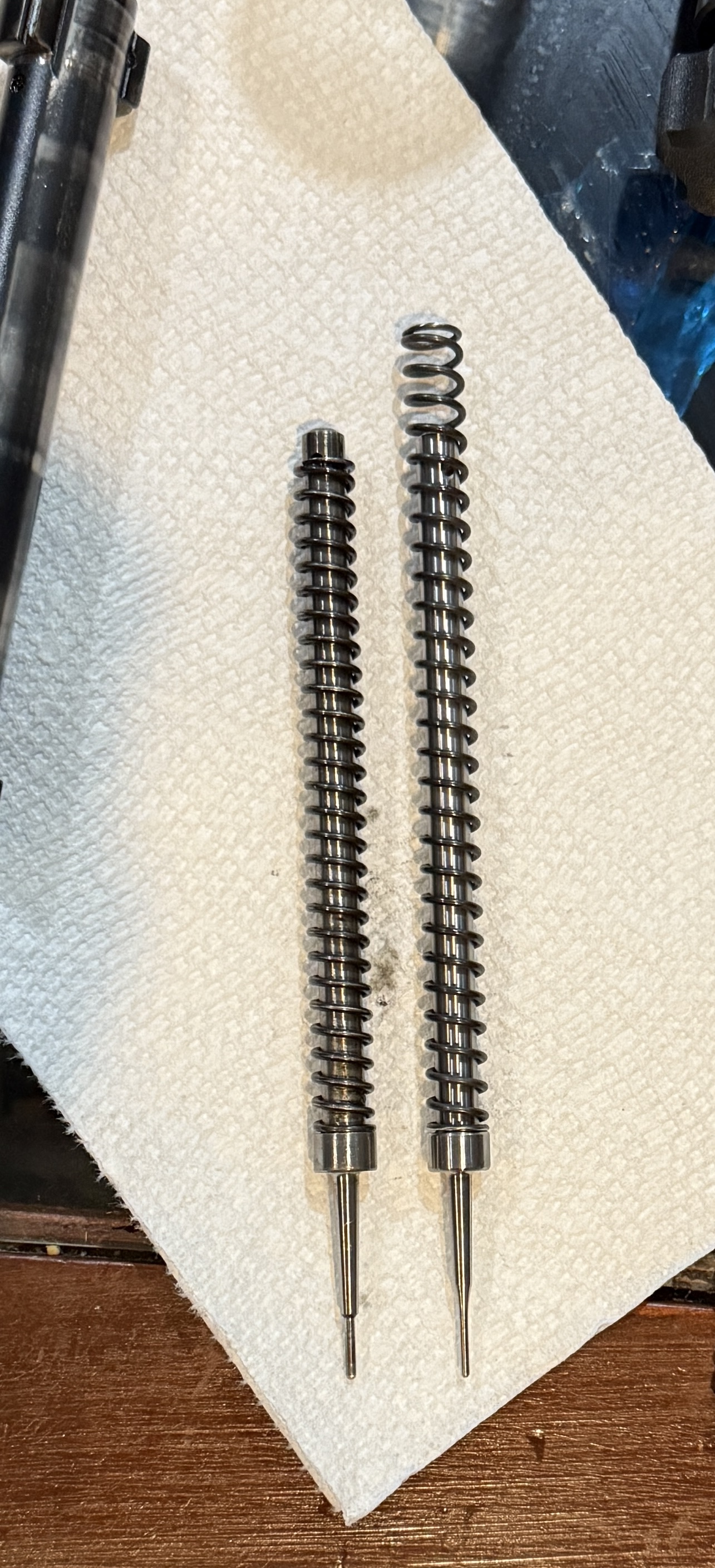

.005" deep seems right for Alpha Brass and 450s, thats where mine sit. Trying to eliminate any potential mechanical problem within the firing system, when's the last time you changed the firing pin spring?
I have never changed a FP Spring, lol. Now that I’ve done some reading, it appears some people change them annually.
@jthor and @LR1845 What actions are you both running, and what springs are you using? I just looked at Impact and they are out of FP springs.
I am running 2 CDG actions right now but going back to lone peak as soon as my barrel comes in, I order 2-3 springs at a time from the action maker, when I get down to the last one I order 3 more. I bet if you call Impact they will send you a spring free of charge. And FYI I do this same thing with a rim fires.
Reactions: superde
Capture as much of the spring dimension detail as you can from your fresh one, as well as your used one.
It isn't too difficult to gin up a way to grab a force at a deflection, and that might come in handy some day.
I still keep spares and usually change them with a barrel if the gun gets shot regularly or every time I catch myself wondering... Sometimes when I am lazy I will just change it, or if I take the time to check and its still in spec I will keep running it. It is often easier to just change it.
ETA: It isn't too difficult to learn to store The Safe Queens with the bolt de-cocked to reduce the long term storage stress on the spring. I have some rigs that don't come out often and there is no point to storing them cocked.
