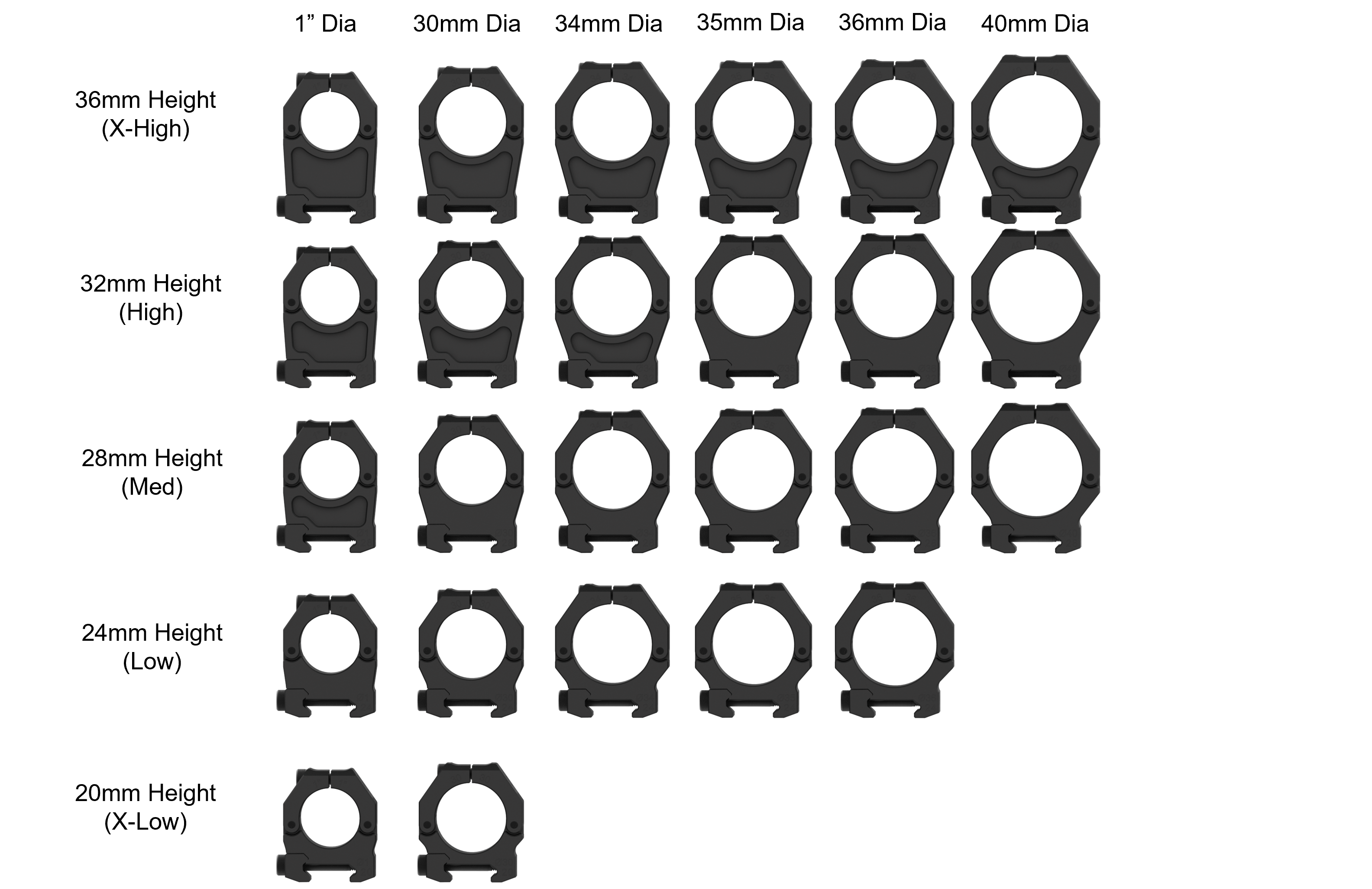

American Rifle Company has given our beloved M10 Scope Rings a new look and a new designation for the 2020s and beyond. Hence forth, they will be dubbed M-BRACE Scope Rings which ought not to come as a surprise considering the recent introduction of our M-BRACE Uni-Mount. See M-BRACE Uni-Mount on the Hide at: https://www.snipershide.com/shootin...pe-mount-from-american-rifle-company.7092685/
The new M-BRACE rings are functionally equivalent to the OG M10s. So then why did we do this? Well, I was just screwing around one day and thought I’d explore a new look for the rings. It didn’t take long to stumble upon something I thought looked pretty cool so I showed the design to others at ARC and all were in agreement that, yeah, they look cool. And truth be told, I actually designed these before designing the M-BRACE Uni-Mount which inherited in good looks from me, no, I meant from the revised M10 design. Now it makes sense that the M-BRACE Scope Rings and the M-BRACE Uni-Mount resemble one another. The new M-BRACE scope rings are also a bit beefier than the originals, again, just because I thought they looked cool that way. And there you have it.
Price for the M-BRACE Scope Rings is $179, same as that for the M10 Scope Rings. We’ll be discontinuing but not discounting the M10 rings so if you must have the originals, get them while they last. Some sizes are already gone.

They do in fact look neat. I assume the lack of serrations is because without having the other part of the attached mount to be the primary moments reactor there are concerns about stability/tube damage/etc with heavy stuff attached?
We didn't think it would take long for someone to ask and it looks like we were right. And yes, you're on the right track. Each of the rings need a rail clamp which precludes integrating a serrated surface on one side. It's best to use an LRF with the Uni-Mount anyway because it can better distribute the loads into the rail.

Bringing this back to life. This may be an unpopular opinion but I think the M10’s were better. Never had an issue with them. I have recently had a couple m brace rings where the scope tube won’t sit easily in the bottom half of the rings. Once you get it seated, rotating the scope to level is damn near impossible, even scratched an NX8 tube. I’ve also experienced more canting/torquing of scope when tightening rings, requiring more adjustment and time leveling a scope.
Has anyone else noticed a difference between the two designs?
He did say he updated them for looks... ;-)
I'm one for two on M-Brace rings. By that I mean I had one set that worked right off the bat once the scope was pressed into the bottom half (and it is tight down there), and the other set settled in after the rifle was dropped several times (on purpose). The scope was wiggling in the rings about .1 mrad worth at 100 yds. Same scope in both cases, first set were highs, second set were mediums.
That said, I had no issues with cant/rotation when tightening. While they were tight in the rings, no issues getting them level either. I don't know if they left ring marks or not.
