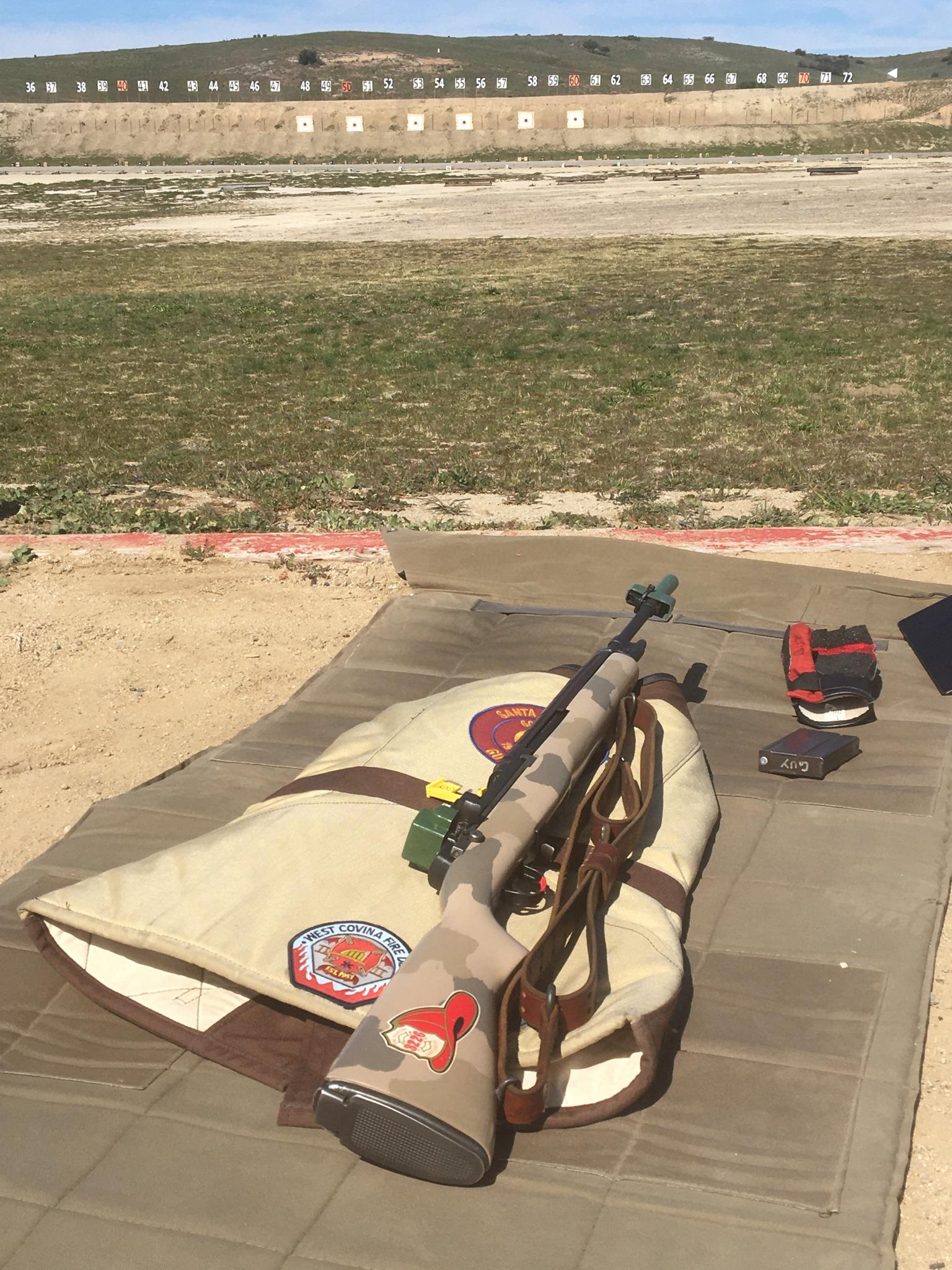

I've had a standard M1-A since the early 1970's, a 3 digit serial # Devine gun. Standard GI with a Fiberglass stock. Bought it for $225.00. I went through scoping it with an original Leatherwood scope. I ended up selling the Leatherwood and kept it with the Irons. With Winchester 168 Match ammo, I was getting 2" or so @ 100. I've kept it original.
About 10 years ago,I bought a Walnut Scout. I zeroed and calibrated the Irons and then put a Vortex Sparc ll on it. I get about 2"- 3" @ 100 with it. It has the California required brake on it and that brake works, making it a soft, straight back recoiling Rifle. I don't intend to use it past 200 or so. I really like it. I wanted to use it as a Hog gun, but I lost my Hog hunting property.
