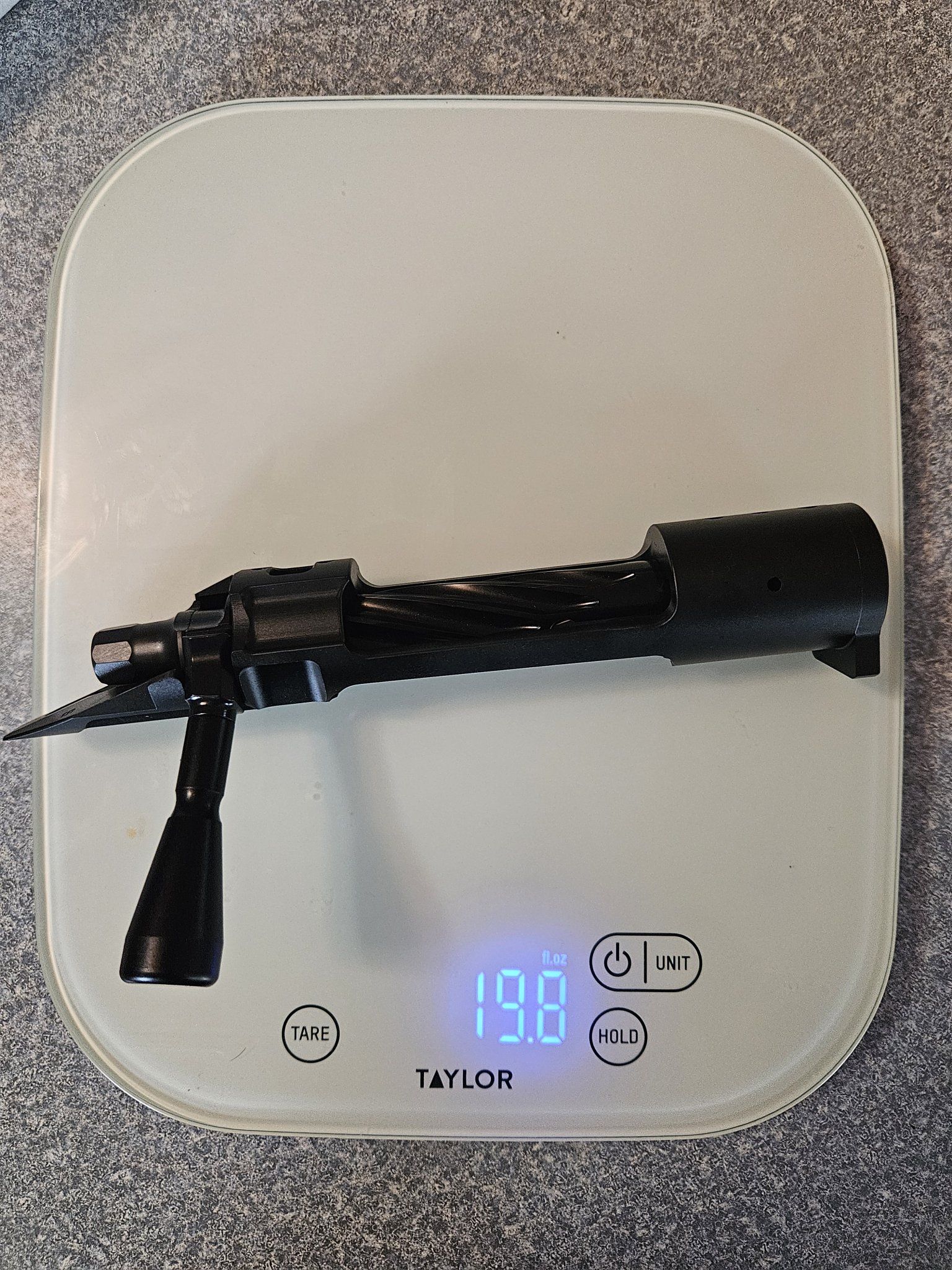

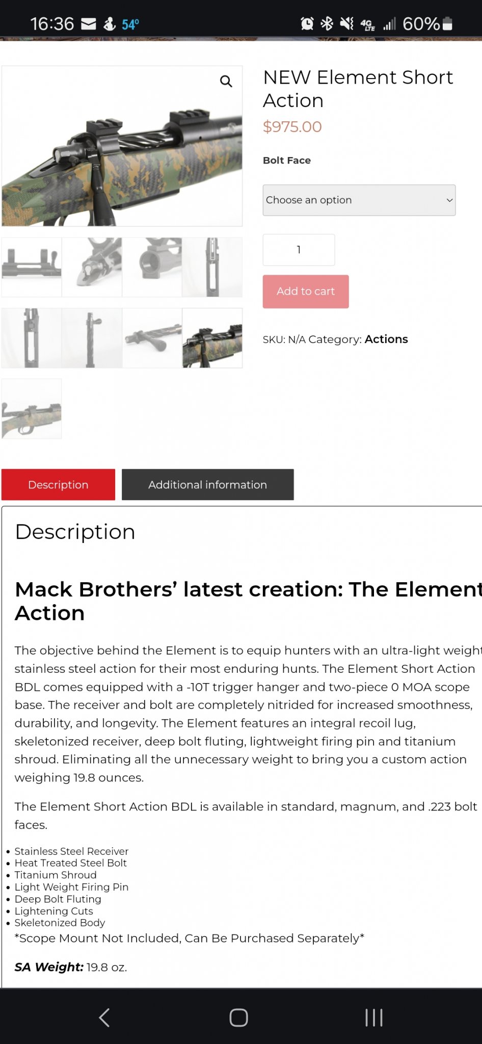

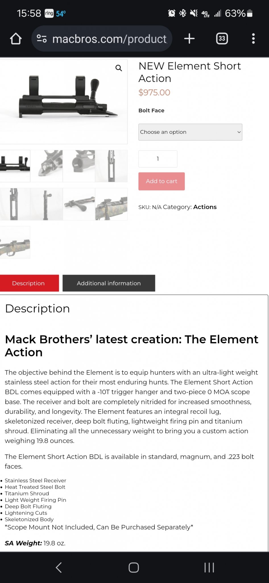

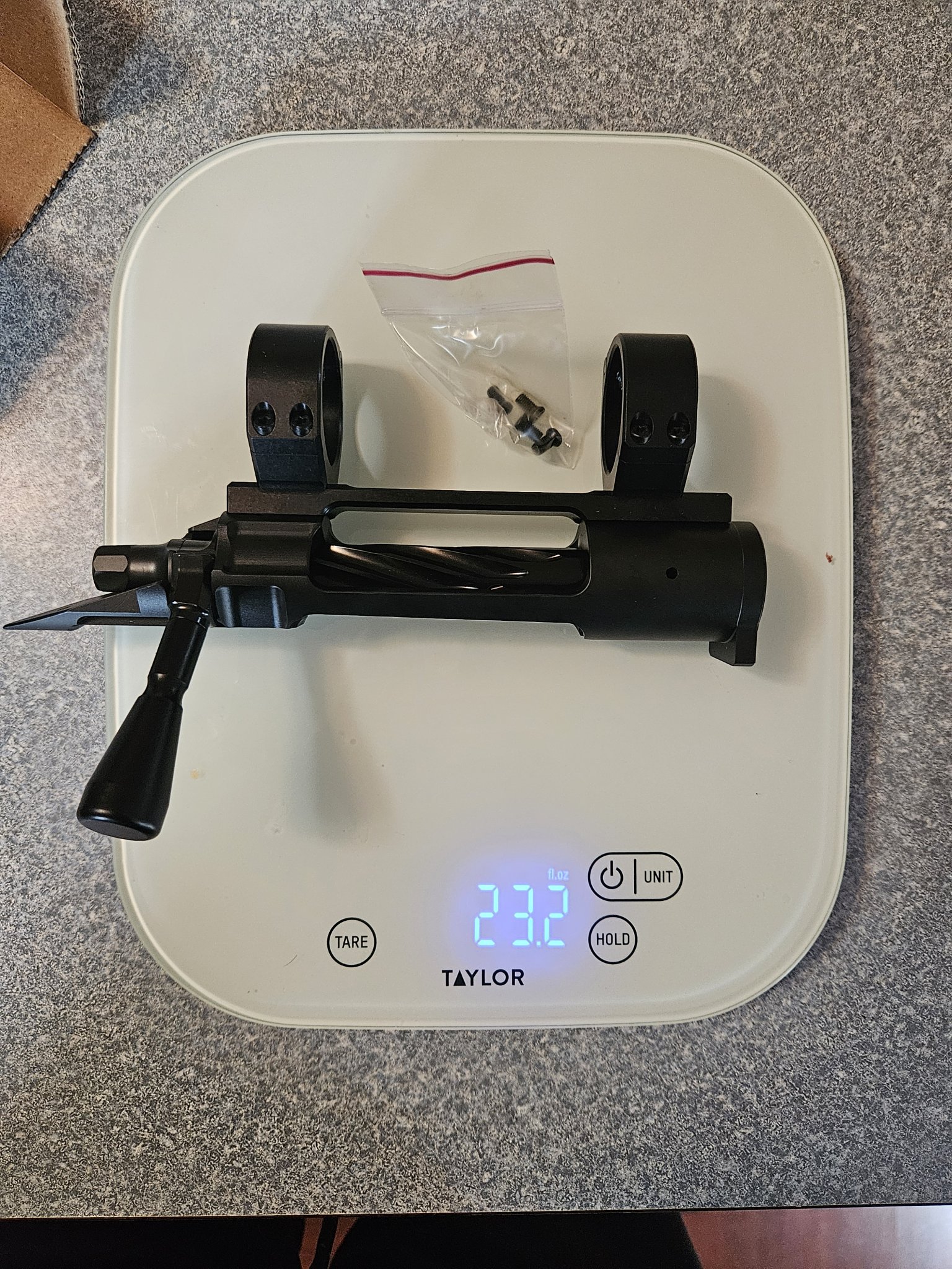

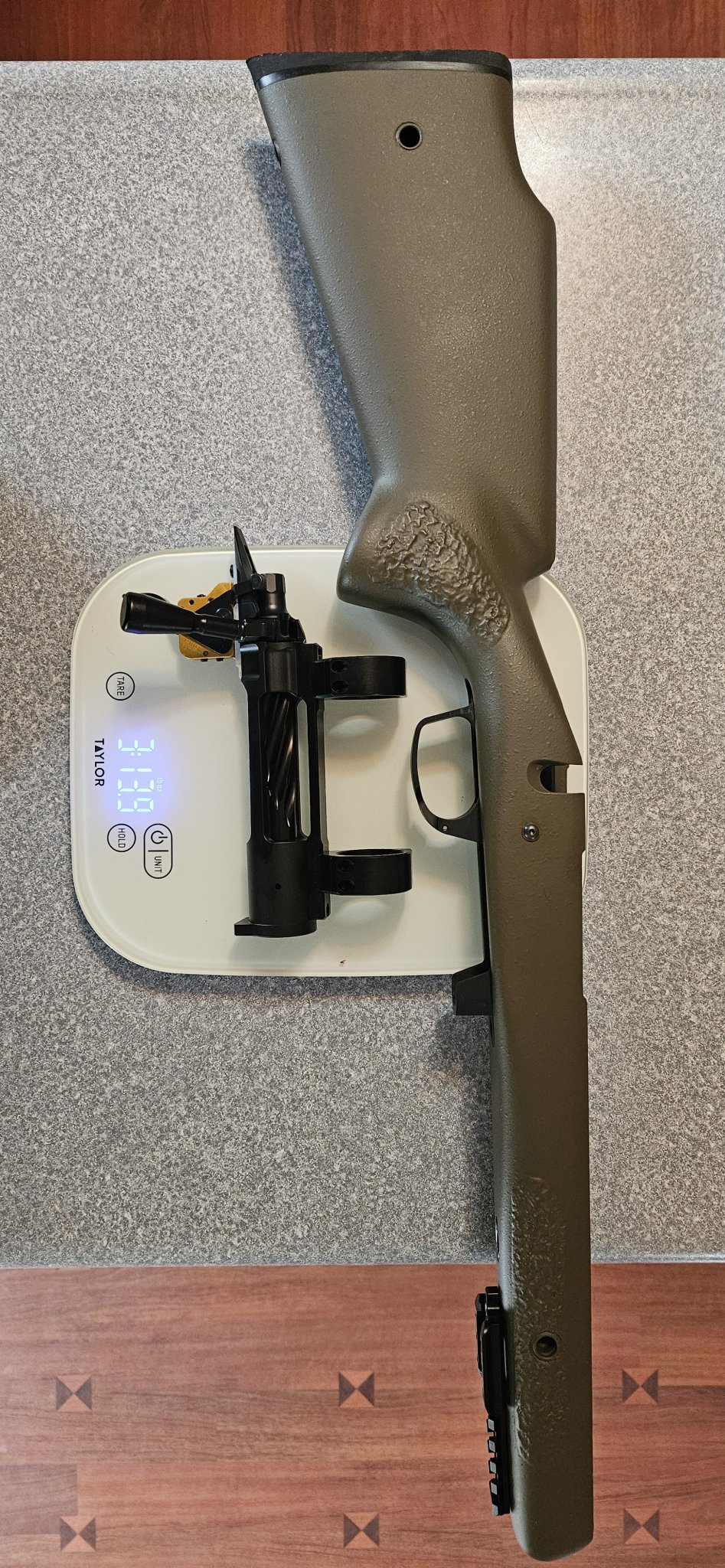

So apparently Mack Bros snuck the Element action on their site before Shot Show. Looking at the specs and price I decided to grab one for a lightweight 308 shorty build. I also grabbed their lightweight integrated ring mounts.
I'm surprised more people aren't talking about this action. As far as I can tell it's the lightest stainless action and way cheaper than the other options in it's class.

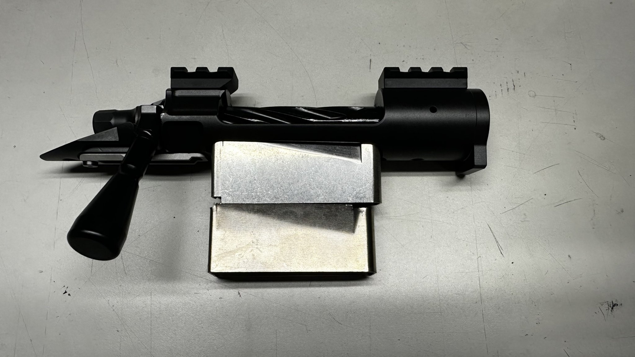

Curious if this action is compatible with AICS or possibly AW magazines. I can't imagine it's only designed to be BDL compatible, where you can take a factory 700 and use an AICS system.
Either way I'm digging the weight!

The standard evo 2 does, there’s about a zero percent chance the element has a shorter magazine cutout. Theyre calling a “short action BDL” in the description.

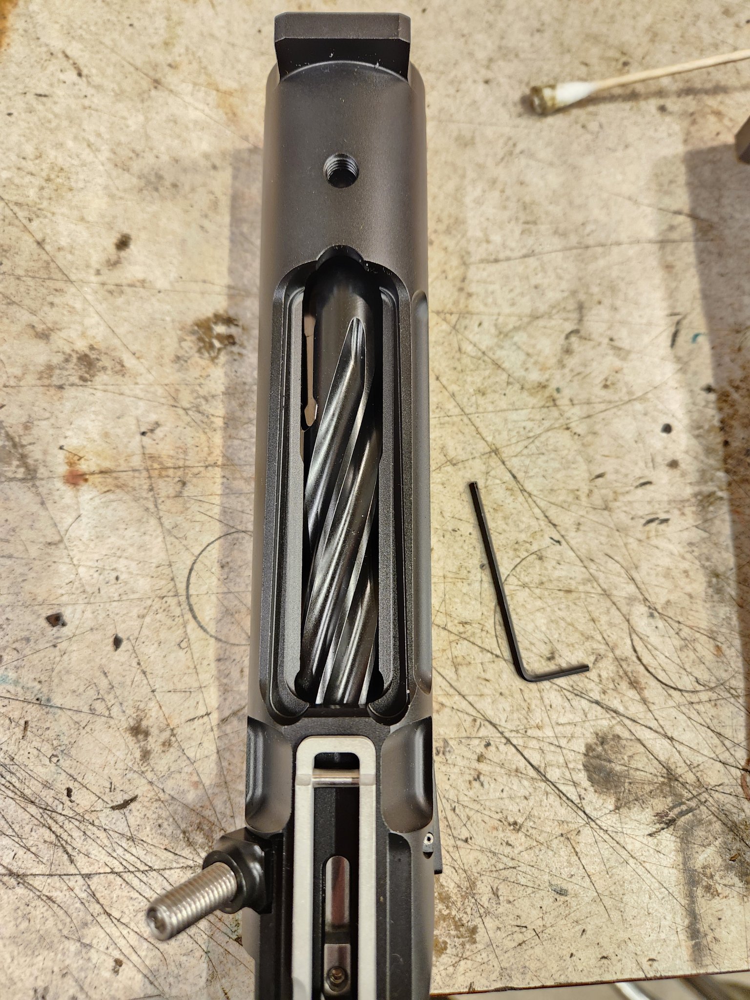

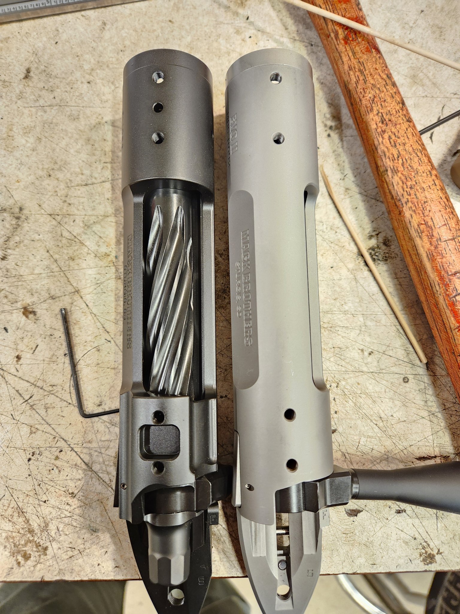

Stuck a set of calipers in the Element today, 3.210" magazine cutout on the receiver.
Here's a quick snapshot comparing the top of the Element to a closed top Evo as well.
The standard Mack Evo takes Stiller two piece bases, the Ti takes Nosler pattern.
The Element mimics the Evo, I think. I'll confirm in the morning when I can get all three of mine side by side
From what I was told by mack bro's the evo2 and the element are same bases which from what I have been seeing
I was told they were same base screw spacing as defiance, but will have to verify against my anti when my ffl gets back from vaca.

Yes, the BDL cutout is for a Wyatt’s extended mag box assembly and AICS pattern magazines will work perfectly. AW mags will not work in the Element or EVO with a BDL cut. AW mags will work on the EVO2 DBM action.

If ultralight is your game the Pierce shadow is even lighter than the Mack.
Recently, chambered a 6 Creed on a EVO…I was a little disappointed in the top lug engagement but it shot well.
Pierce Shadow
: long action 22.4oz
: short action 20.9oz
$1150.00 fully nitride coated
Mack Bros Element
: long action 20.06oz. $999.00
: short action 19.8oz. $975.00
Both actions are fully Nitride coated
