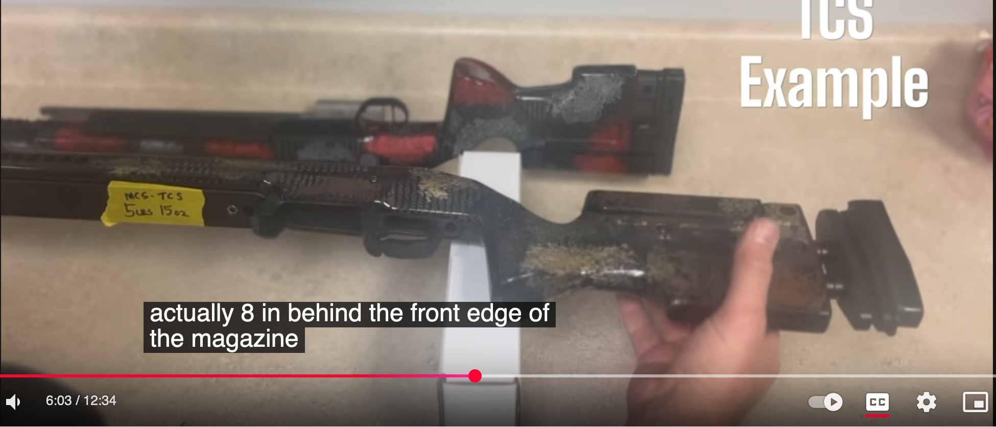

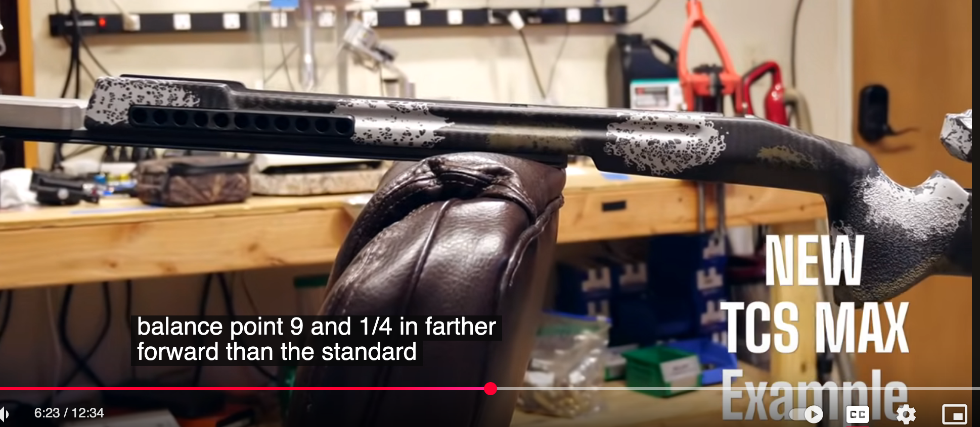

Would you mind popping out your BA and measuring the balance point of the empty stock? It might be very interesting to test these claims empirically. You would need to do this on a narrow balance point, like .75 inch (nominal 1x wood).
I don't pretend to be an expert in manners history, I'm just noting these guys are doing the hidden steps that are non-obvious to make their claims credibly (if not actually) true. That means, IMHO, somebody did some proper analysis in addition to marginal tweaks.
A key piece of evidence is there is an emphasis on lightening the back-end of the stock, not just weighting it out front.
My gun is shooting great right now so I'm not going to pull the BA just for this... but I promise I was already planning on doing what you asked and seeing where my "old" stock balances on something thin to see where its CoG is located.
Why does it matter how the empty stock balances?
Reactions: Hennig and R_A_W
None of my stocks or chassis have balanced in front of the mag well empty (without the BA)
I got my empty TCS to ~7.5lb with the 360 precision steel rail. G3 Razors are fatties too. 30” MTU, balance point was >4” in front of mag well

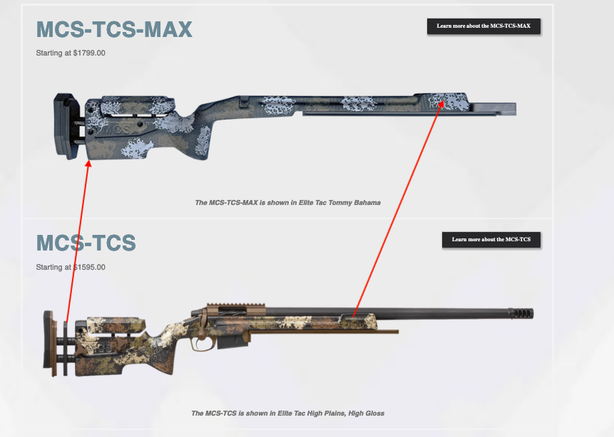

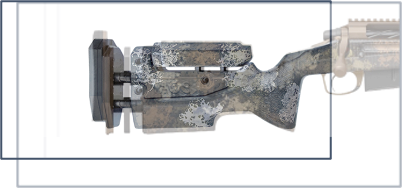

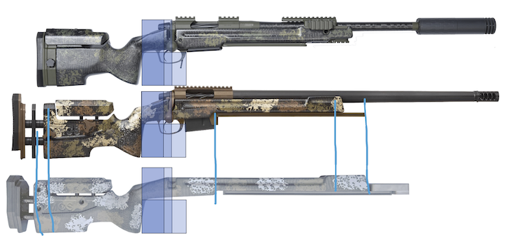

This is my attempt to same-scale each stock for reference.If this is correct, the changes to the rear is evident. There is some evident fore-arm extension. The grip area looks unchanged.
I think your scaling is off/wonky lol…
The only changes made to the rear end is a bit of aluminum instead of steel with the KMW hardware and supposedly/allegedly them tweaking the fill a bit. The forearm didn’t get any longer either, it’s the same length as the original’s.
They make a quality product.....no doubt. I just wish they'd invest in some new tooling for the wait times, and maybe work on adjustability options. not every one who shoots is an NBA size guy.
Well, here is the curent website. 100% these images on their website are not the same thing.
Thats not to say the website it legit tho, LOL....Post #25, to my naked eye, looks to have a dimple-less forend and that longer looking bag rider, with single (shorter) hardware set in the backend.
But I have no idea what this "correct" history is or is not...:ROFLMAO:
The "Gen1" TCS did have dimples in the front and the front elevated section of teh foreend was slightly shorter. The stock was a little different as well. I don't think many like that were produced, as those changes happened pretty quickly after the stock was introduced
Reactions: ma smith
I do hope the new one is improved in some ways I may have missed.
But if you look at the pic of the TCS-MAX and OG-TCS again, the pic of the TCS-MAX is tilted starboard a bit (you can see it in the butt-pad hardware). So, if someone gets the new one next to the old one, let us know if anything changed dimensionally IRL lol..?

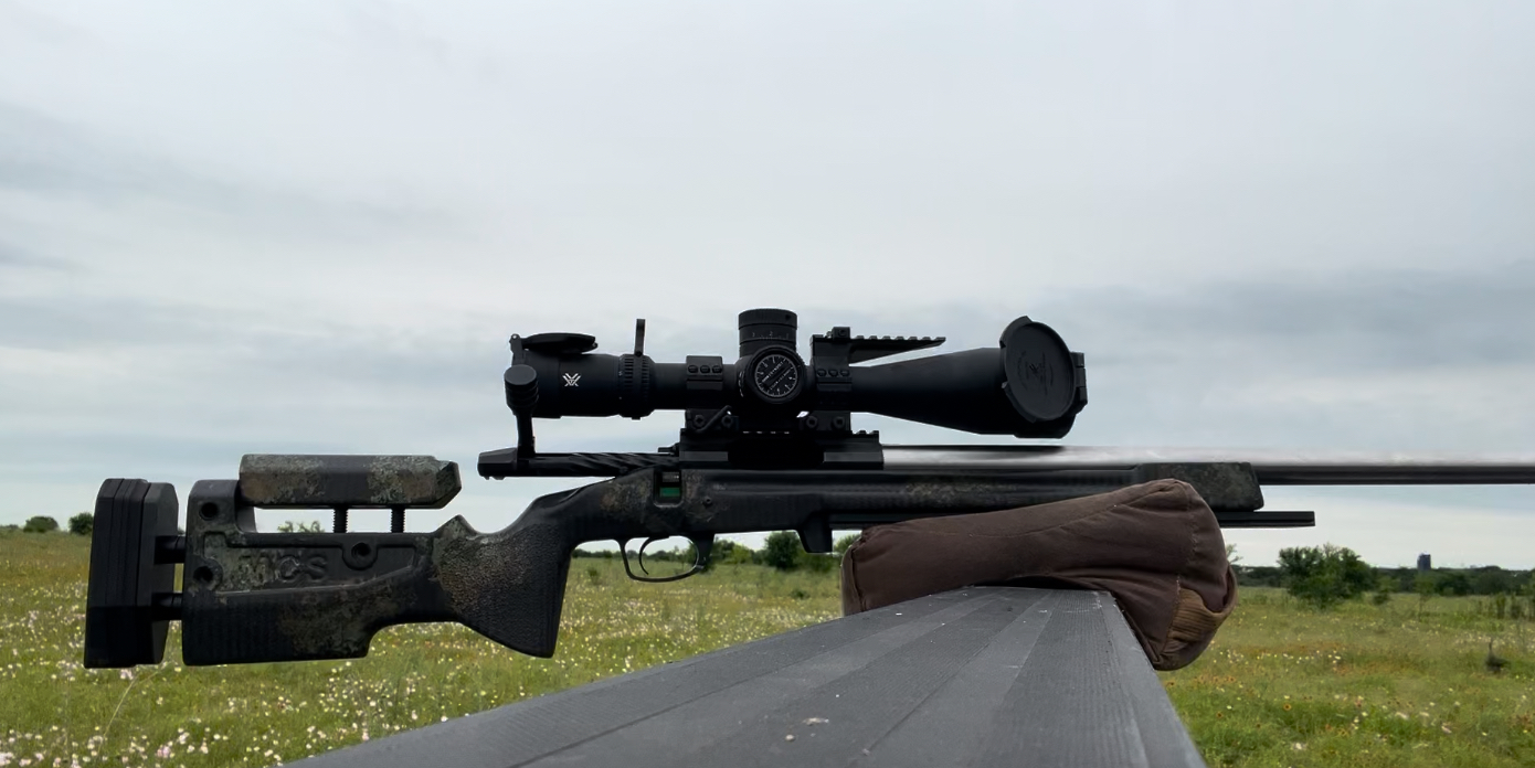

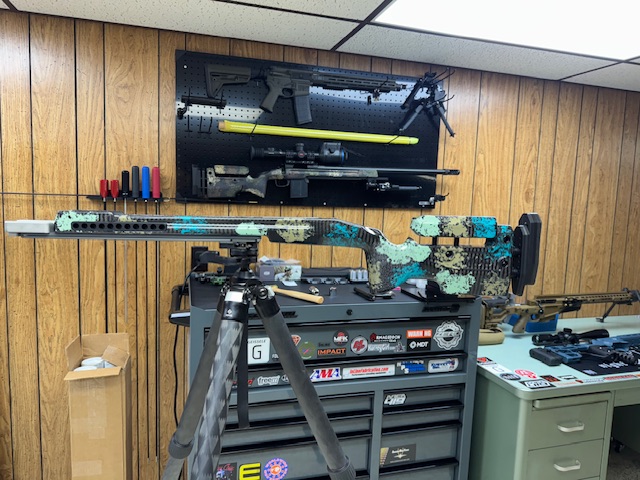

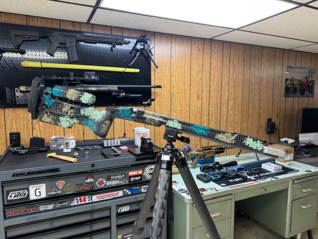

I got lucky and snagged a high gloss saltwater TCS Max the other day. I don’t really love the idea that it needs its own bottom metal. I’ve had great luck with the manners mini chassis, so trying the micro chassis is new to me, and like I said by the looks of it I’m not sure I love it, but time will tell. I already have a PRS TCS and was wanting another. Figured I may aswell try the “new” one.
It’s definitely heavier. Balances nice.

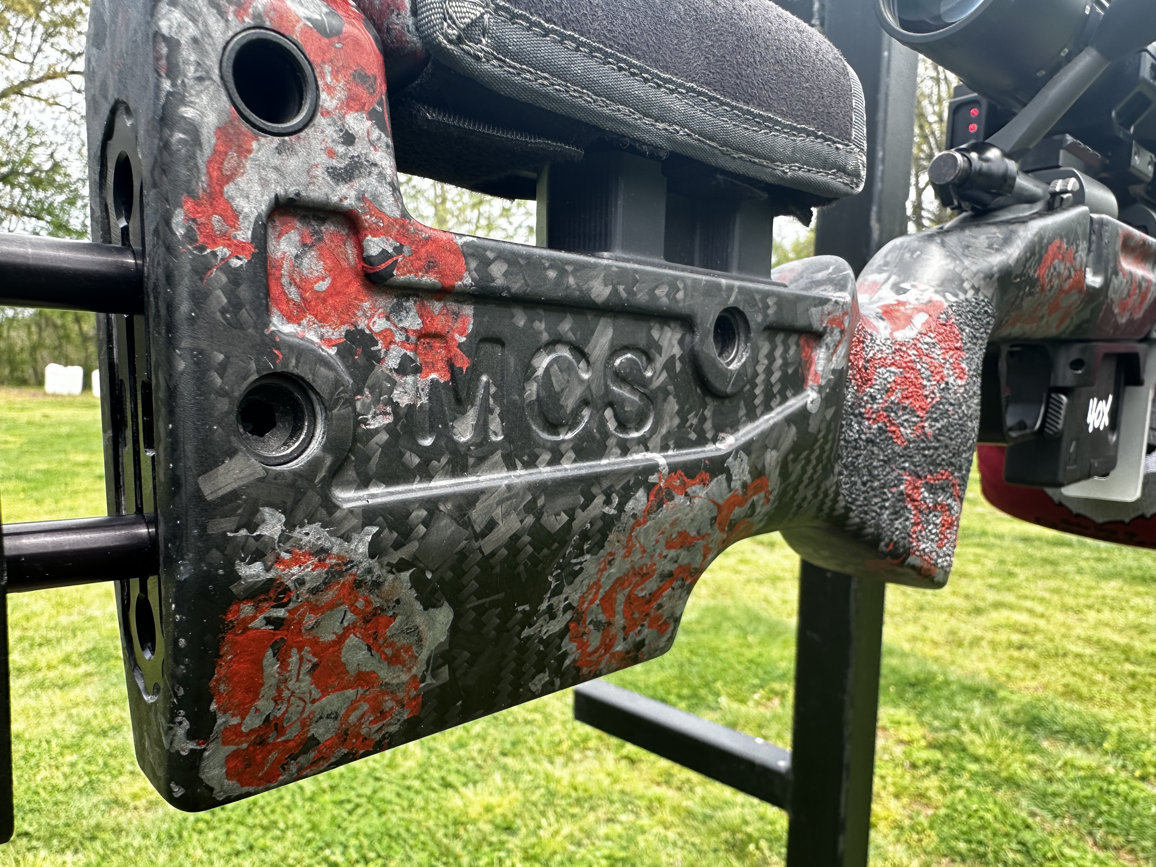

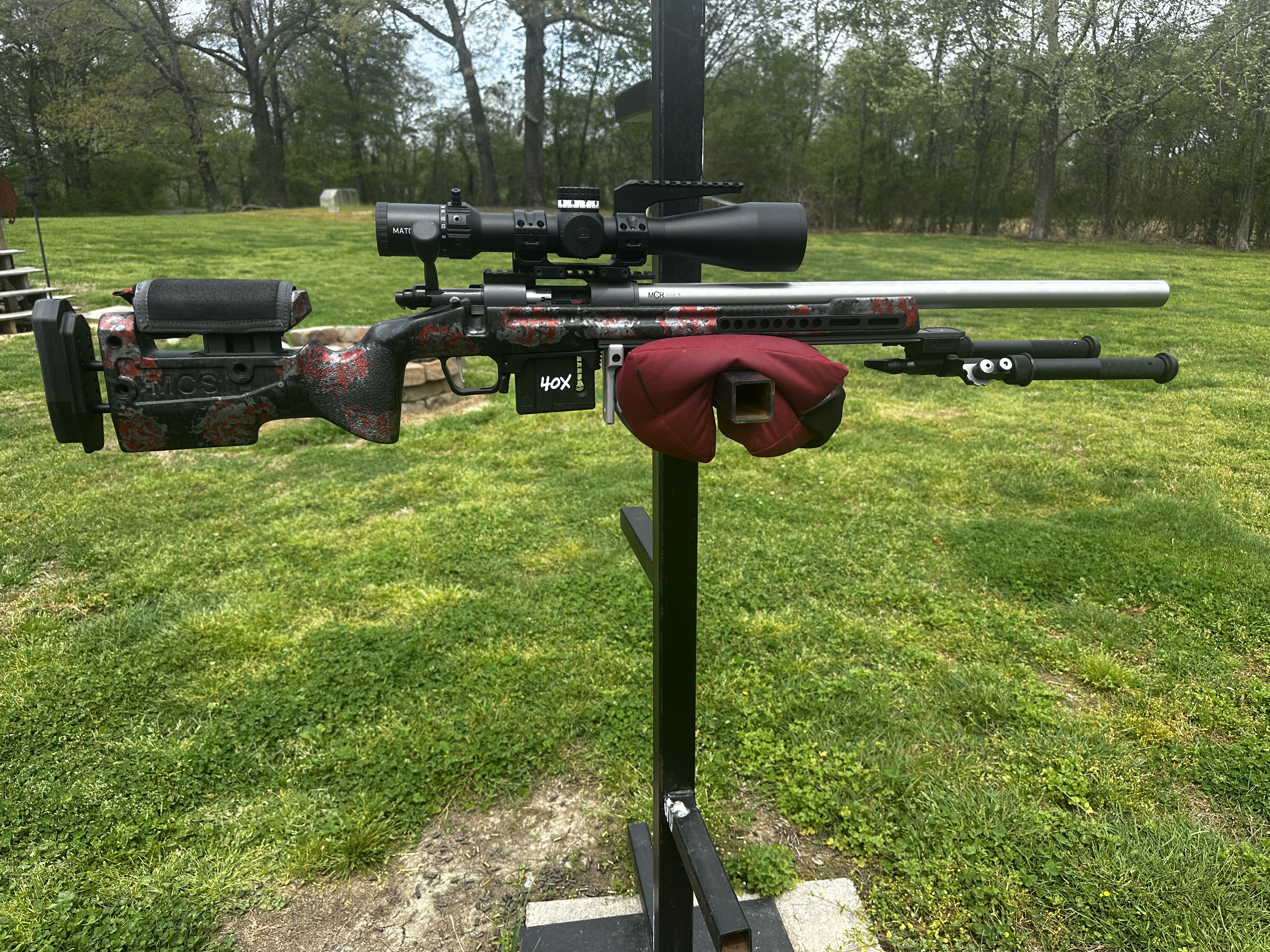

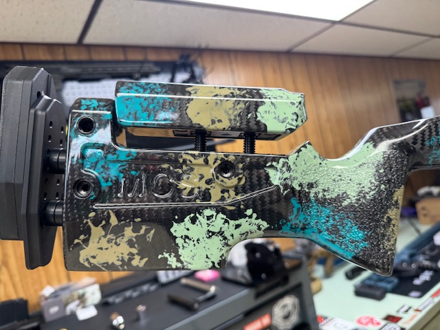

Manners TCS Max. Mine has finally showed up. This stock is 100% designed for Rimfire with all the forward weight. It has an internal Brass Bar in the forearm with a different shell fill around it. Then the Micro chassis. Then a lite fill in the back of the stock. As pictured it is 20.6 LB and balanced. Remove the Super Cal and it is 19.4 and almost balanced. This is the MAX Steel rail on it and 2 small steel internal weights. The M-Lok Sykes rail is only available from a Rimfire Team Member.
