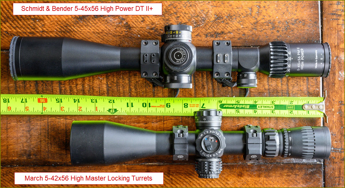

Here's a side by side comparison so you can see what I mean about the ergonomics of the March compared to the Schmidt
March on the Left, Schmidt on the right
Okay, so it's not quite that bad, but the Schmidt is a monster of a scope while the March keeps things streamlined.

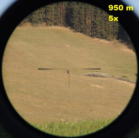

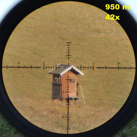

As far as FOV goes, there are discussions on this thread about the eyepiece FOV and then there are discussions about the FOV downrange. I took the downrange FOV as the standard definition and perhaps mistakenly, I understood the eyepiece FOV as a bigger eyebox.
Are these two FOVs interrelated? If so, how?
edit: @koshkin any thoughts?
Yes. The ocular is a different design to "normal" scopes and has a 26 degree Wide angle lens in it. I found this offers the user two things - a bigger down range picture of the target and surrounding areas and a much bigger lens closer to your eye.
Throw the "eye box" term out the window here. A properly set up scope will rely on your cheek weld to be repeatable and exact. Repetition (again in a range of positions and not just bipod) will develop muscle memory on this and you can mark out the max and min eye relief points on the butt if required.
Butt style is also important here. On my AI the cheek weld was spot on and repeatable. On a German hunting rifle, sitting positions were great but prone positions were a struggle because of the curved shape of the butt.
But here is the "but" from my experience of using this scope. The scope rewards good shooting technique and shows up when I was getting lazy with my holds like no other scope I have ever used. The HM glass goes a long way to this, I think, by giving visual clarity that I had not seen before. It is a very different scope that I spent a lot of time going "ahhhh" with as I learnt something new about what it could do.

FOV downrange and the Apparent FOV (AFOV) subtended by the eyepiece in front of your eye are indeed related. Apparent FOV is real FOV multiplied by magnification.
For example, if Apparent FOV of the eyepiece is 25 degrees and the scope is on 5x, the real FOV of the scope is 5 degrees.
Eyebox is something else entirely.
