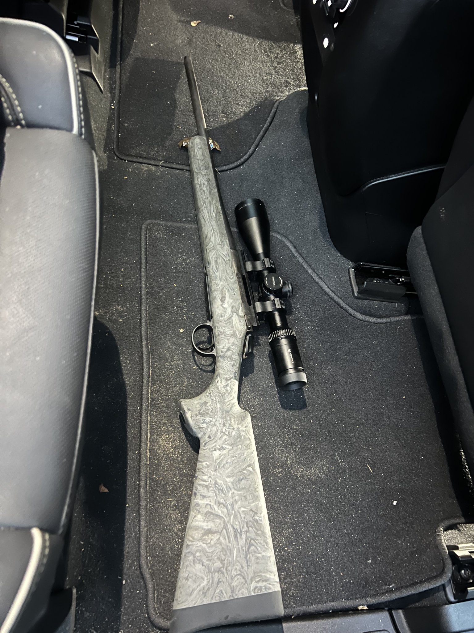

Below is a picture of the Rifle after replacing the stock and cleaning it as best they could “soot/smoke/heat , is horrid on steel 😔

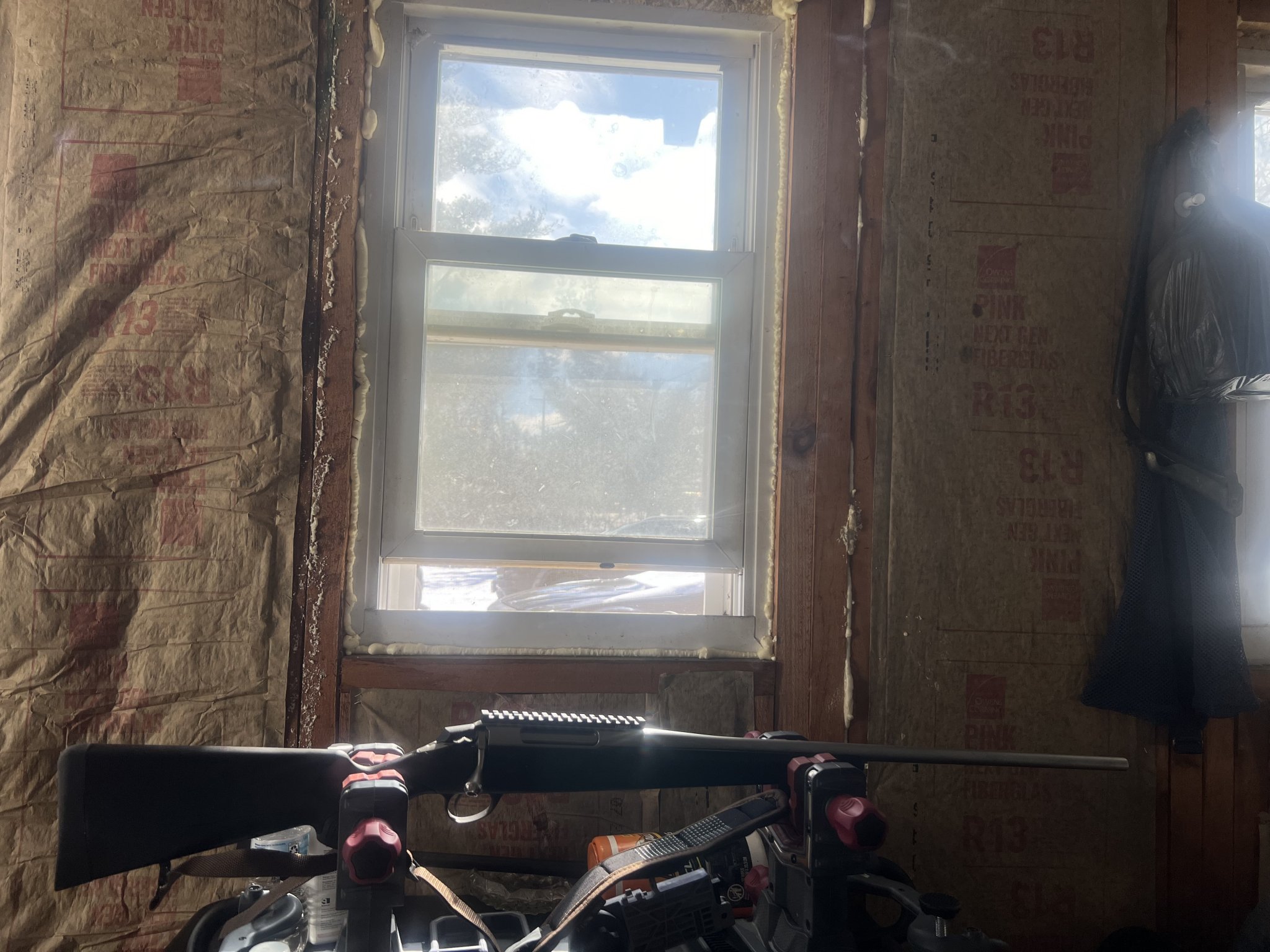

Here is a picture of my tikka t3x , I harvested 2 does this season with it . I love the rifle “hate the stock” so I’m in the market this offseason for a hunting stock / chassis .
I still would like to see if the bergara is salvageable . It was still capable of moa with a warped barrel and all lol.

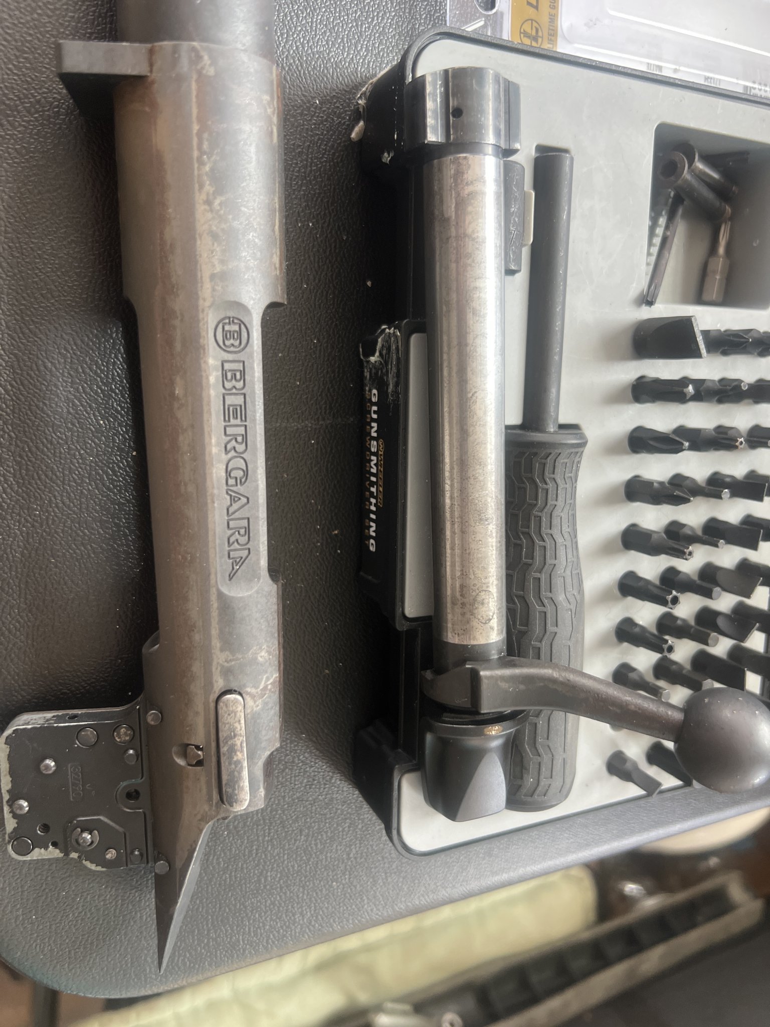

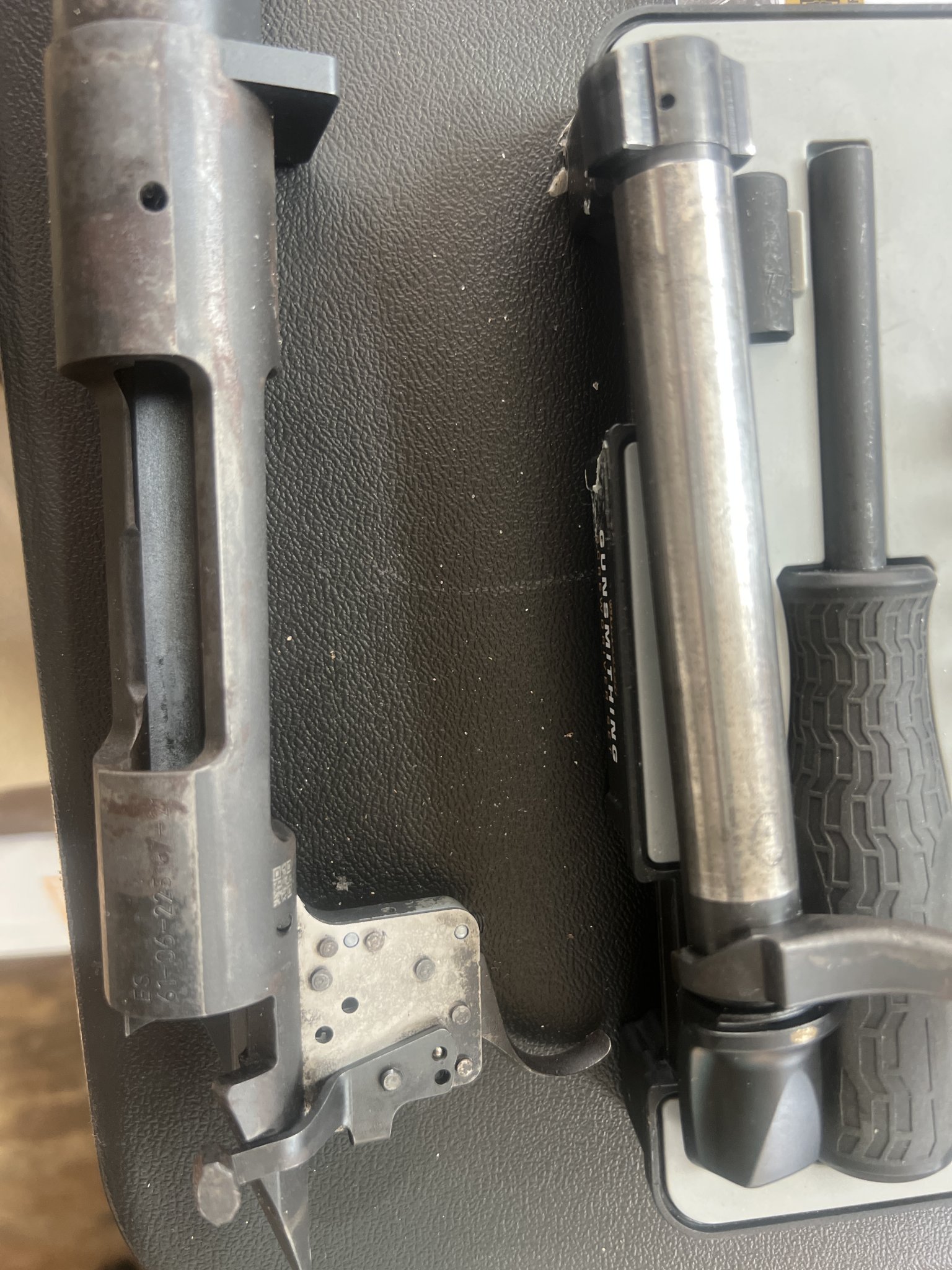

And here is the bergara. I’d like to have it sand blasted , coated - and trued if everything checks out okay . I shot easily 50+ rounds through it , and it was still capable of putting 1 inch groups down range with a badly “curved” barrel
