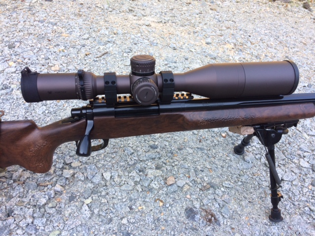

Welcome John!
Since it isn't my money ;) You like wood look?... How about a Foundation Stock in Long Action ? If you really want to shoot long range....you will find out that you need to stay away from wood. Love the look...but it has too many issues that affect long range accuracy. Stock linked is about $1200.
Scope: Buy the best you can afford....since you are single...learn to love Ramen Noodles and offbrand peanut butter and get on a savings plan with @CSTactical and get you a ZCO 5-27x56 Scope. I have one...and it was worth every minute of suffering through salty noodles.

Run what you have. Get a Witt clamp on brake and see how you like it. Not a high buck item but be sure of your measurements when you order. I like mine on my 308 Sporterized Mauser 98, Fajen stock I fitted myself close to 60 years ago. That was a big job for a teenager but I bought a barreled action, all matching, in 8mm and needed a stock before I could shoot it. I didn't know what I would be up against until the stock came in the mail and had a tiny 1/2" groove down the center of this big plank of fine walnut wood. To say the least, it was not a drop in.
There were no gunsmiths in my area so I read everything I could find and went to whittling. Always start in the center and work your way out, the outside of the stock comes second. Inletting, fit and finish of putting the action and barrel in the stock is foremost. Final finish comes later and you do what you want to do then.
I shot the original 8mm barrel out but harvested a lot of meat doing so, it fed my family.
With the original barrel shot out I had it re-barreled to .308 and it is still my favorite rifle. I have many others.
More than likely, the barrel you now have will shoot better than you can but will give you a place to start.
Once you are serious about shooting and have all of your ducks in a row as to how you feed this rifle, ie reloading, or a source for ammo and you know in your heart that the barrel is not up to your skills, then think about a new barrel. Until then, Run what you have, re-barreling will follow along as needed.
I scream like a mashed cat when I have to re-barrel but know it is part of the game. I put a few thousand rounds down range a year.
At age 22, you have a lot to learn about a lot of things. I wish I was 22 now and had everything I know now to run with.
The Hide is damn sure a good place to learn about everything shooting related.
I wish something like this had been around 60 years ago. I would not have made so many mistakes nor wasted my money on things I didn't need.

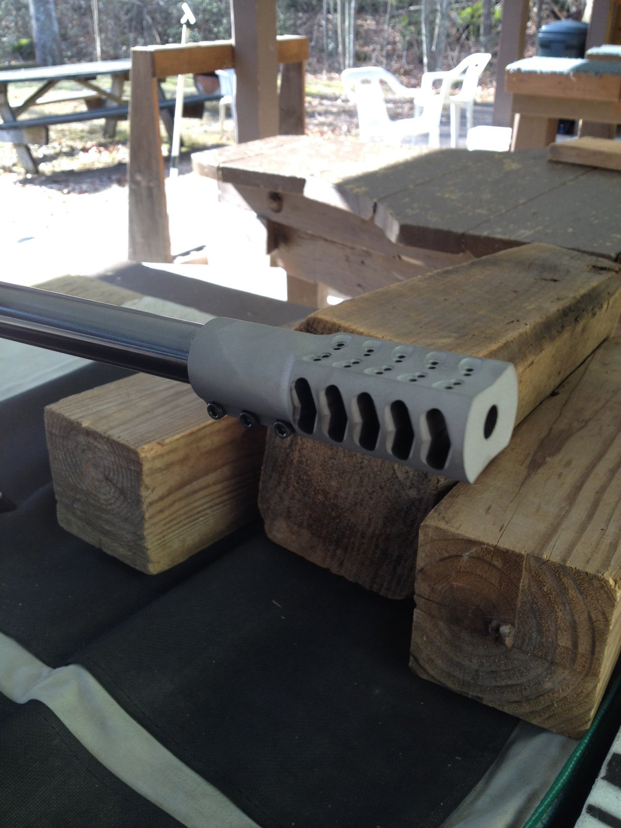

The Witt Machine brakes do work good. As mentioned make sure to measure it well. I have one on a 7mm RM and it cuts recoil great. Here's a pic of the one I put on.
I took very careful measurements and my Witt clamp on fit closer than I would have imagined.
Careful measurements.003, as close as I could get.
Stuck it on the muzzle with a bit of Hoppe's 9 and oil and the fucker popped on tight enough that I do not run the screws very tight. Just enough.
I think they may be moving as workers rust the bottom out of the buckets used to collect pee here in Colorado.
Where ever they go I wish them the best and I would not hesitate to order tomorrow.
