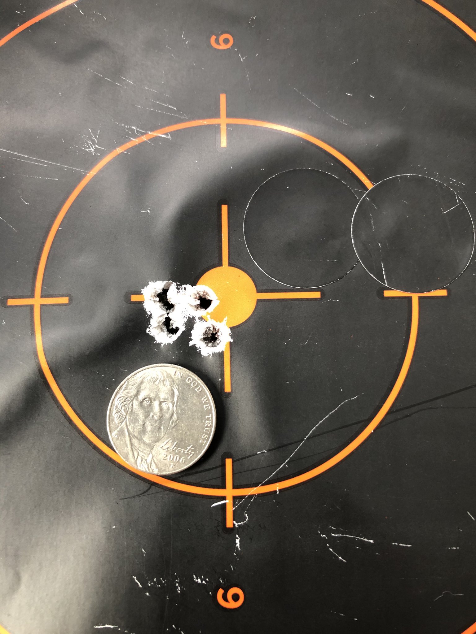

FWIW my tikka in 223 tightened up quite a bit moving to a mcmillan stock with pillars and a free floated barrel. Stock was an adjustable game scout and may be up your fancy as when I put this gun together I had a plinker/coyote gun in mind. It was a good minute gun before the swap. Now it regularly does this
