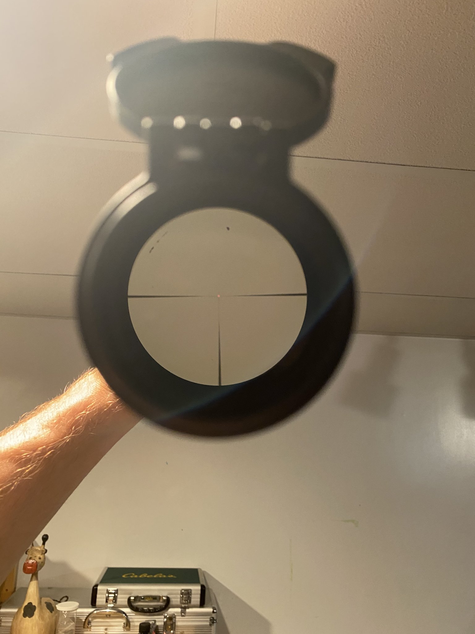

So I recieved mine and was quite disappointed after taking it out for a bit longer today. There seems to be debris and oil on the inside lense of the scope. It’s in a Spuhr mount that I torqued down to 20inch/lbs as per instructions. Not sure how this wasn’t a QC manufacturer issue. Any thoughts?
