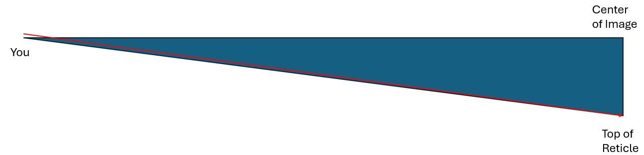

    Resurrecting this thread with a legitimate question.
    Since the zero of the reticle (and for that matter, the top of the 5 mil vertical axis in the reticle) is below the centerline of the scope, how in the hell do people set up a LRF on the cage? If I coalign the LRF at 1000 yds to be on the zero of the reticle, it’ll be many mils high at 100 yds and decreasing until the distance reaches the range at which the LRF is coaligned with the reticle (1000 yds in this case). That’s not super useful in a field environment, especially in daylight when you can’t see the red aiming laser on the LRF.
    In my case I’m talking specifically about the mil xts reticle but from I can see the Tremor4 will have the same issue.

    What you're describing is the reverse of what would happen if you zeroed the laser on the center of the image and then used the reticle to aim it. If you zero on the reticle at 1000 yds, at 100 yds your laser will be 90% of your coaxial offset high if laser mounted above scope.
    It’s not the reverse, we’re saying the exact same thing as best I can tell from your illustration.

    It's only "many mils high" inside of 50 yards, because it's a consistent linear rate of increase from 0" at 1000 yds to whatever the offset height is at 0 yds.
    If the offset height is 4", the laser impact offset will be:
    1000: 0", 0 mils
    900: 0.4", .012 mils
    800: 0.8", .028 mils
    700: 1.2", .048 mils
    600: 1.6", .074 mils
    500: 2.0", .111 mils
    400: 2.4", .167 mils
    300: 2.8", .259 mils
    200: 3.2", .444 mils
    100: 3.6", 1 mil
    50: 3.8", 2.111 mils
    25: 3.9", 4.33 mils
    10: 3.96, 11 mils.
    Yes, there's an offset, but it's negligible over the distances the scope/laser is used for.
    Hope that and the image above helps.
