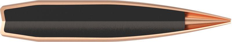

    Nosler[SUP]®[/SUP] Announces Mid-Year Introductions
    Bend, Ore – July 5, 2017 – Due to popular demand, Nosler® will be introducing three new offerings to their current Match Grade™ and E-Tip® Ammunition product lines.
    To further supplement the incredible popularity of the recently announced 22 Nosler cartridge, owners will now be able to purchase Nosler Match Grade™ ammunition loaded with the new 70 grain RDF (Reduced Drag Factor™) bullet as well as the 55 grain E-Tip® bullet loaded in Nosler E-Tip® Ammunition.
    The 70 grain RDF bullet is ideal for target and match shooting with the highest ballistic coefficient compared to any bullet in its weight class. The 55 grain E-Tip® bullet will turn the 22 Nosler into a perfect medium to small game hunting cartridge with exceptional terminal performance and weight retention.
    Nosler will also be adding the 6.5 Creedmoor loaded with 140 grain RDF bullets to their Match Grade® Ammunition line. With the increased ballistic coefficient and reduced hollow-point size, the 140 grain RDF will squeeze even more long range performance out of the 6.5 Creedmoor.
    Manufacturer’s Suggested Retail Pricing for the mid-year introductions are as follows:
    • Match Grade™ Ammunition 22 Nosler 70 grain RDF #60124 - $27.95/20 ct. box
    • Match Grade™ Ammunition 6.5 Creedmoor 140 grain RDF #60115 - $38.95/20 ct. box
    • E-Tip® Ammunition 22 Nosler 55 grain E-Tip® #40140 - $31.95/20 ct. box
    All three of these introductions are available now so please visit your local Nosler dealer or www.nosler.com for more product information.
