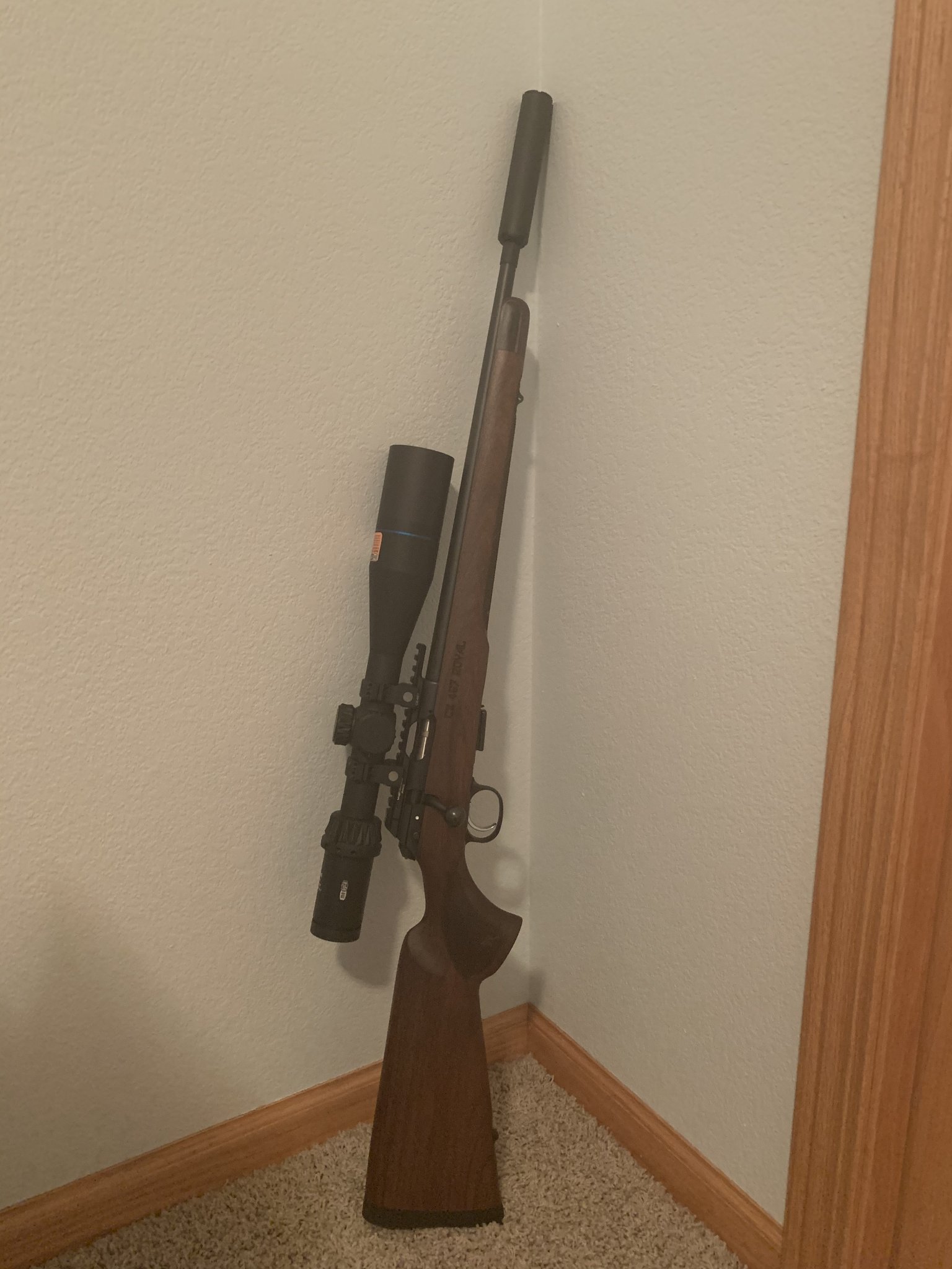

Had to have my hands on one of these bad boys... they just look so elegant. Just waiting on thread adapter for the Silencerco Sparrow, rings, and glass. Running a 30 MOA rail from MPA probably will go with Nightforce ultralight rings to keep the weight down. Just moved into the house I am in and the place is of course surrounded by big oak trees that drop lots of acorns which... attracts a shit ton of squirrels. I hate squirrels. At my last house they got into my house and started nesting and chewing wires. I am on a mission to kill every one of those little bastards which is why I bought this gun, the ol' German RWS .177 caliber pellet gun shooting at 650 fps isnt cutting it. My other .22 rifles are non threaded and when I saw this bad boy I had to have it. All my shots will be from 15-100 yards so I am wanting something that will parallax down to that I am thinking maybe the new Vortex Razor LHT 3-15x50 but that parallaxes down to only 20 yards. I can get that scope for around $850 new... seems pretty hard to beat with another scope that is in that price range.
One thing I noticed with the gun that kinda made me question some craftsmanship.. Overall shape and finish is GREAT except the barrel is so far off center of the stock that it's almost touching the right side of the barrel channel in the stock.

Beautiful rifle, it's sad to see the barrel off center in the channel like that. I know that would piss me off for sure.

Normally the action screws are loose allowing the barrel and action to be off center and moving around in the stock. Torque the action screws up to 20 inch pounds while holding the barrel in the center of the groove. You may wish to take them up to 30 inch pounds later. This will compress the action into the wood in line with the center line of the barrel channel.

I will give this a try... I did stick a dollar bill under the barrel and slid it all the way back to the receiver and didn't feel any resistance so it is still free floated but at this point its just cosmetic. Frustrating when ya pay $679 plus shipping/tax/transfer fees.

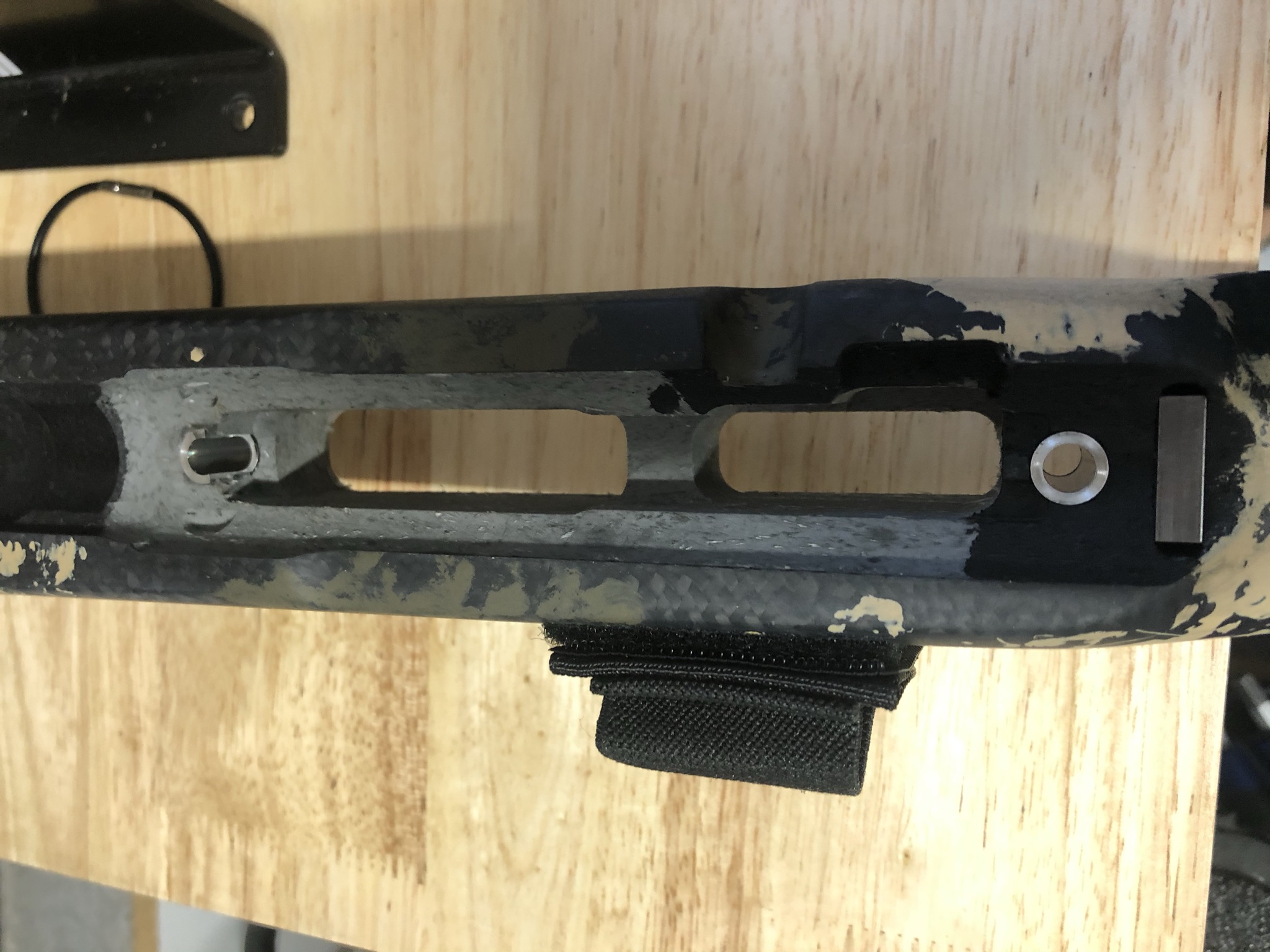

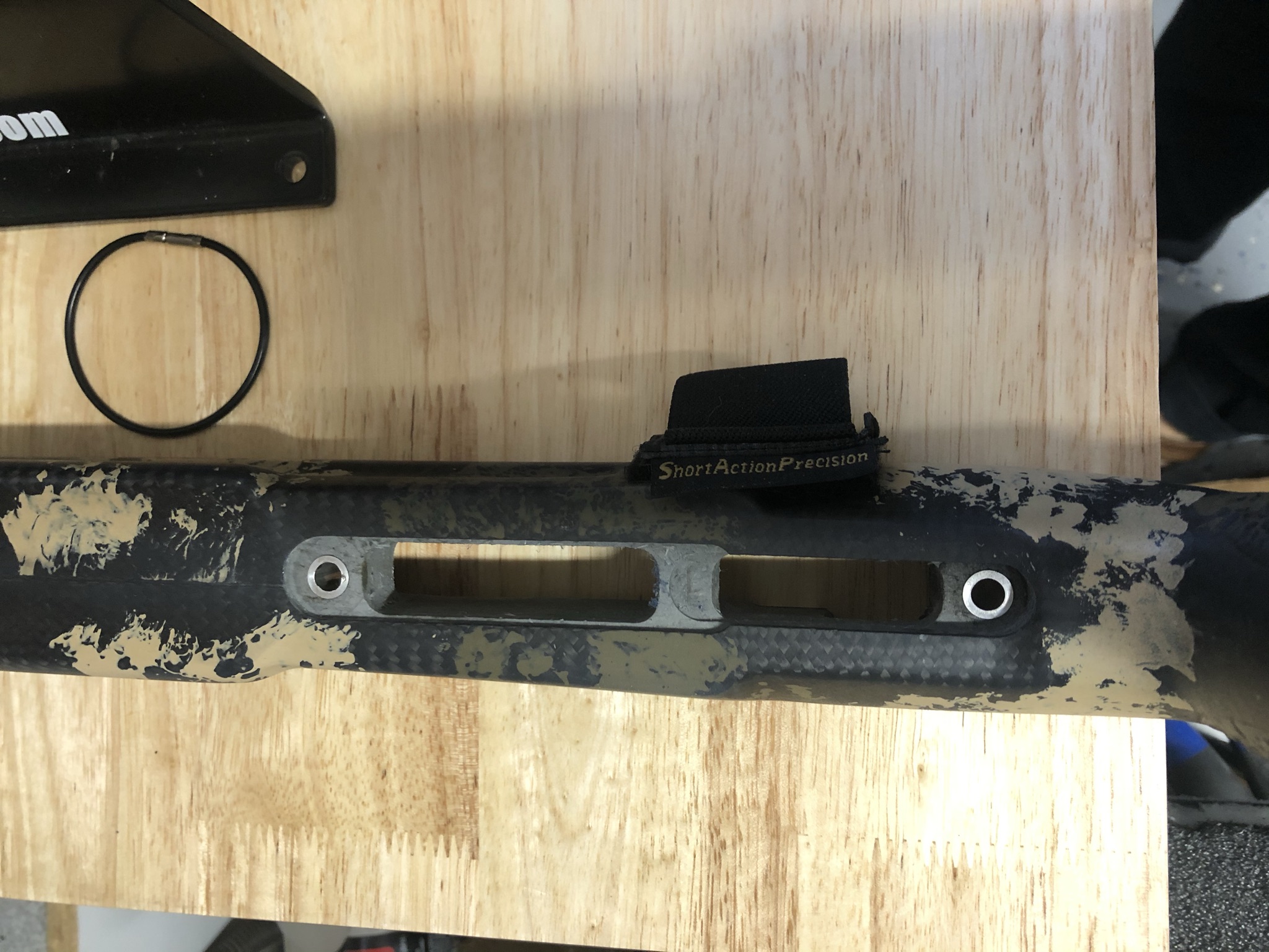

I wonder if they are counting the pillars as "bedding"? The VPT definitely has two, seemingly aluminum, pillars full depth through the stock.

All the CZs are loose in the stocks when you get them. At least every one I've handled. They settle to the bottom side while in the box during shipment and whatnot. Loosen the screws up some, center it up and torque them down. It will be fine. I've had to do it to every one I've had and my brother in law has had.

to whoever mentioned the action screws being loose ... you were right! Retorqued them and now the barrel is centered
I know im bringing this back from the dead. With my Royal I had the same issue. If you loosen the action screws, you can ever so slightly twist the action to have the barrel line up in the stock perfection. Retorque and your done.

The quality is there for sure. But the new action block system they have allows for tight joining of the action and stock while allowing a bit of wiggle room. It's not as nice as a fully bedded stock. But for a factory rifle, it's not bad at all.

It had really bothered me when I first unboxed it. I pulled the action out to adjust the trigger and give it a once over. Putting it back together I saw that there was just enough of a shim to it to get it perfect. The 457s also have a steel tang that interlock between the action and the stock. It locks in quite tight.

My MTR was not bedded. It does have plastic pillars, but the barrel was off center to the right. Bedded the front action screw area to center the barrel. Will see how it shoots, but will drill out the plastic pillars & bed with Pete’s pillars when they arrive.
