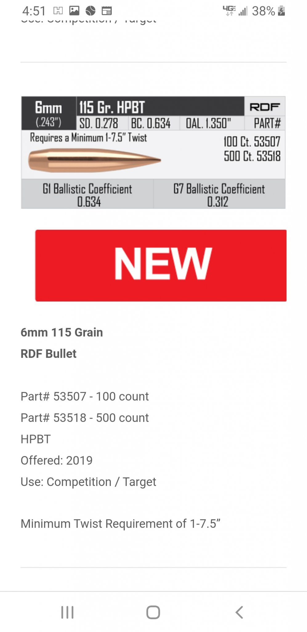

I know its not due out for a week or 2 but has anybody got to try some early release yet?
Damn, I Cant wait to try some of this stuff with that 115rdf.
