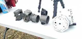

    Looks like the bravo has capabilities to mount both directions? a person could add 100 moa to the rail and flip the bravo upside down to get 100 yard zero.
    Zero 100 high. Then mount backwards and run through your turret. Then take it off and zero turret and run through again. Finally install forwards and zero turret and run through again
