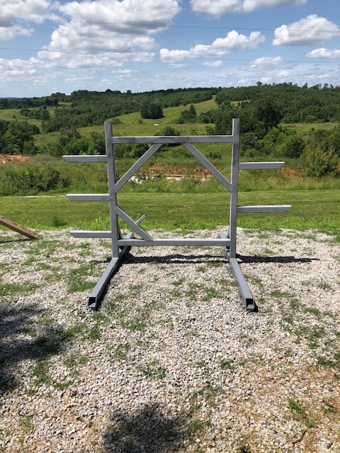

    I would rather see a better design, one that supports multiple heights, positions, etc on both sides so there is no requirement to force a shooter to operate in an unsafe way. The metal one above is nice, I like that because anyone can accomplish the tasks on a position that fits their size. But forcing them to build it is the issue.
