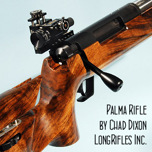

LRI if you want a new build. He is weeks out not months. As good or better than a Gap. @LongRifles Inc. can make a seriously excellent rifle at that price point. And Chad will not blow sunshine up yer skirt either. Top tier builder.
Have a look at some of his work.
