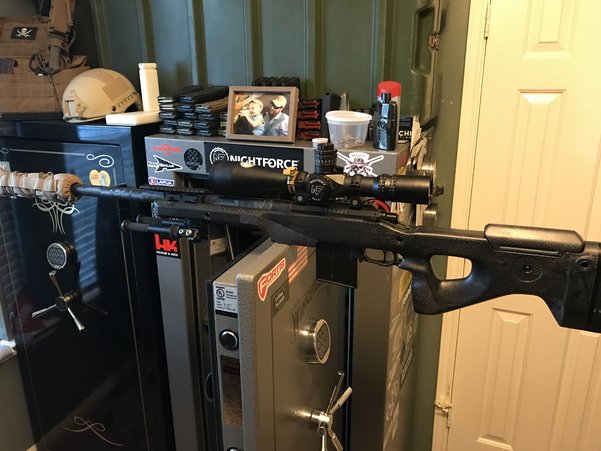

I have one built by short action customs. 22" proof barrel. I really enjoy the rifle. I will definitely rebarrel this rifle to the same configuration when it comes that time. Shoots 140's right at 3000 fps. I shoot turned Norma 300 saum
