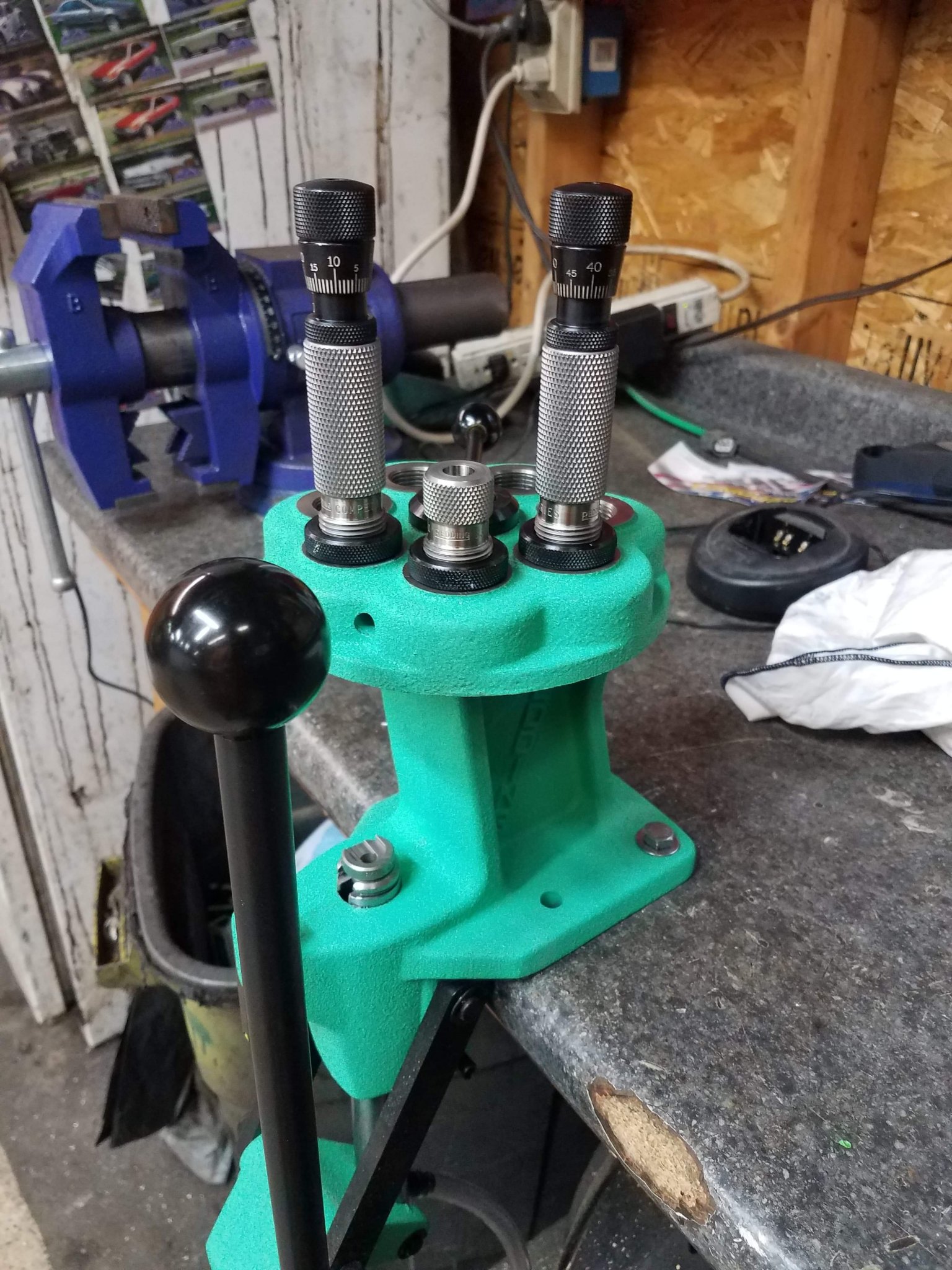

Hey, so this is my very first post. my name is rob, I am from virginia. bloombergs newest playground. so here is the deal, I have purchased a 338 LM rifle, and reloading seems like my only option. I've been looking on here all day and I cant seem to find the answer or a true explanation to the questions I have. I bought pretty much a whole reloading set up.
I got myself some Redding Competition Dies. I still need to purchase the bushing for the neck die.
The question I have is. will that particular set get me through reloading used brass? I am seeing I will have to expand the mouth of the case after round is fired. From what I have gathered the bushing sizes the neck for seating by closing it not opening it. Do both operations need to be done? Also, is a crimp die something that would be necessary?

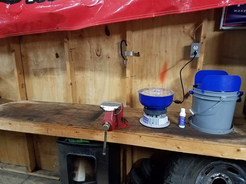

Also attached below is some of the tooling I've picked up in the last few weeks. I dont currently have everything but I'm still working on it.
sorry for all the lack of knowledge, I'm trying to understand. I just dont know which way is up currently. this is a lot of info to take in at once.

You don't really expand the case mouth unless you are loading straight wall handgun cartridges or sometimes with soft lead bullets.
What some people do is size the neck a bit small then open it back up to the appropriate size for the desired neck tension with an expander mandrel. This is often a bit more precise and consistent than using just a bushing and/or expander ball in the sizing die.
To be honest I think you should just order a bushing that gives you .002" neck tension with the brass you are using. That will get you started and you can always add the extra step of an expander mandrel later. 338 LM is pretty easy to load for, they mostly tend to shoot well. Take your time, be careful and pay attention. You will learn a lot.

Bought same press, and same dies, you did. When I started reloading .338 lm, myself. You will need a full length reloading die, eventually. Not hard to reload. A few trial, and errors. You will get thru.
First off...brass springs back as the brass is fired over and over without annealing, it springs back less and less so if your not going to anneal you need a bushing that will size the neck back down to enough tension to hold the bullet e first few firings. Most guys refer to this as .002 neck tension but reality is, you can run more or less with the idea of sizing the least amount you can and still get good results on paper.
With that said, alot of us remove the expanderball from the sizing die, and open the mouth back up with an expander mandrel die to achieve the desired sized neck. Main reason for this is concentricity. Any time you pull something through the neck, chances are it's not going to be perfectly straight but it can be so alot of us don't and use expanders which push the neck open in a seperate operation.
FL sizing dies can be either regular FL dies or bushing dies. They will fully size the brass from neck to web.
A body die doesn't touch the neck. A FL bushing die with the bushing removed can do this too.
A neck die is just the opposite, it won't touch the body but will size the neck.
