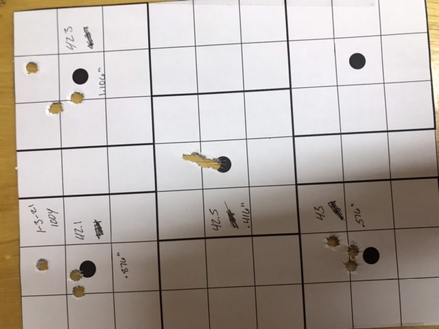

Started working up load for my hunting gun last weekend.
H4350 42.5 ended up being my most accurate load so far haven’t used the chrono yet COAL 2.8225
never used one but my understanding is you won’t end up with the prettiest brass in the world using an ultrasonic. It’ll be clean but not pretty if that makes sense
Edit: forgot- 123gr eldm
